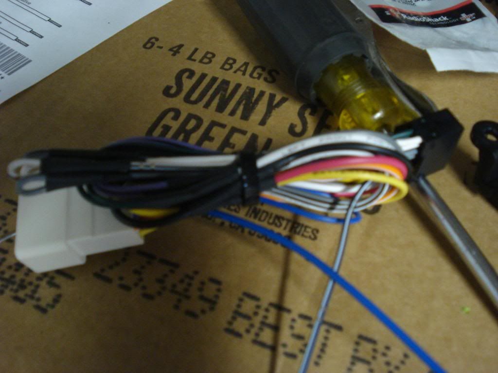

If you buy from the right place (crutchfield for example, costly but it's because they have to pay for their awesome customer service somehow) it should come with an adapter and a wiring diagram so you don't have to cut into the car's harness; you make your own. This is mine (on the right, the connector came with the stereo and plugs into it. on the left, came with my purchase and connects to the car:

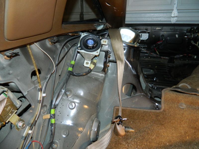

I have put Eclipse SE8233 3.5" speakers in the forward facing mounts. They have the exact same fitment as above (post 41). I would suggest gluing them in like the factory (I used silicone) to avoid buzzing since the factory brackets are flimsy.
