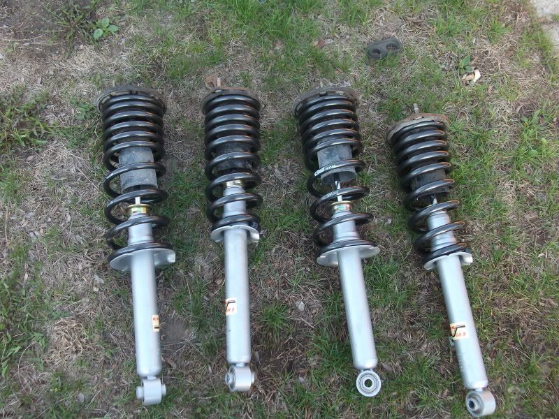

KYB GR2 struts (DONE)
Eibach pro lowering springs (DONE)

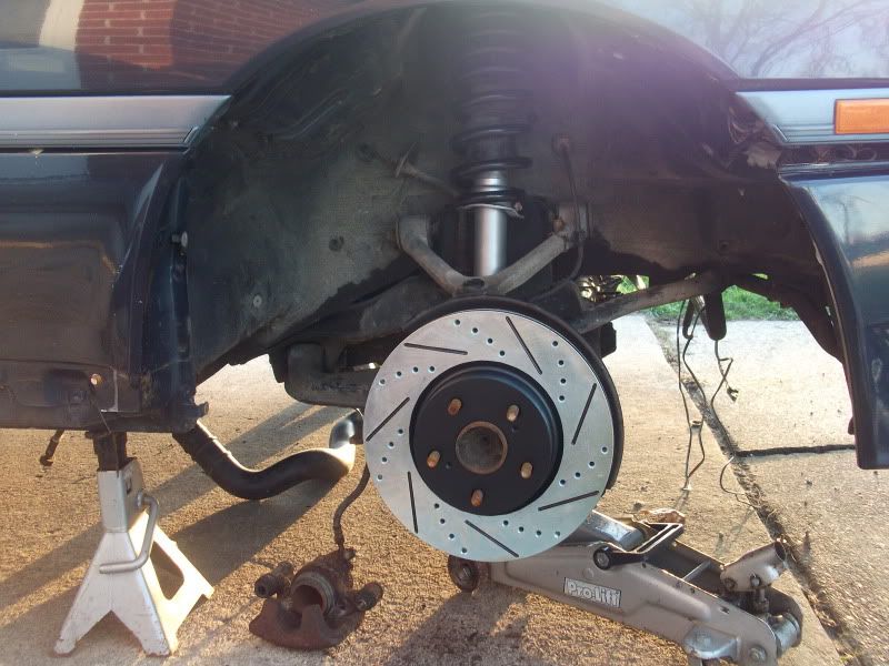

Brembo Rotors (DONE)

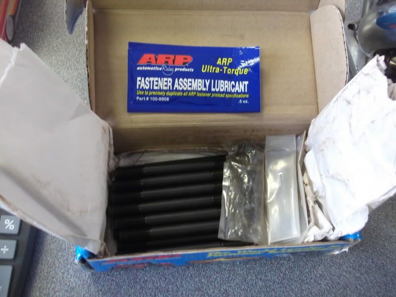

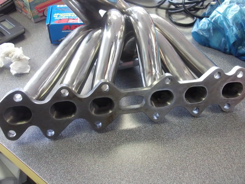

On the bright side i received more parts.
T4 manifold
ARP Head Studs

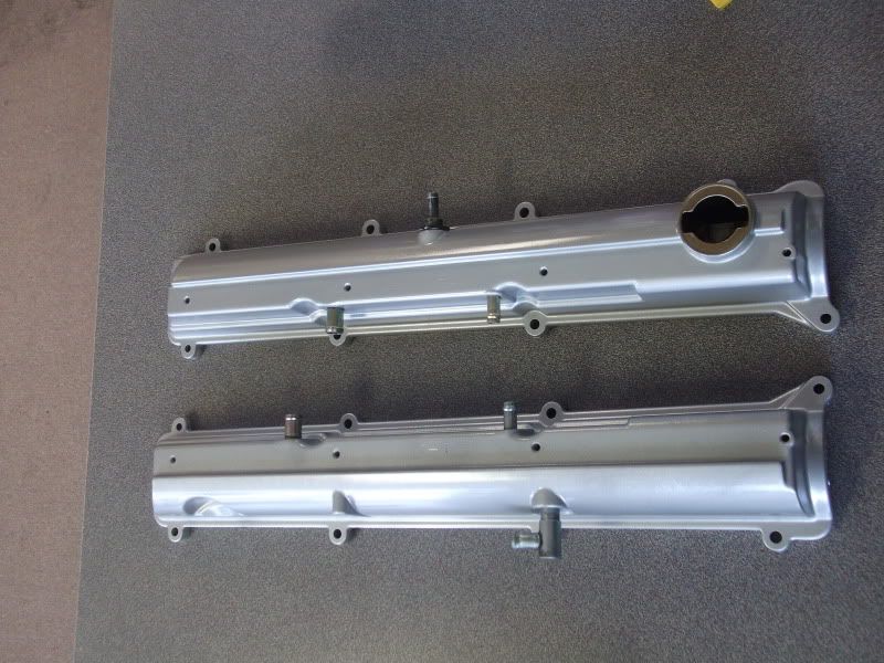

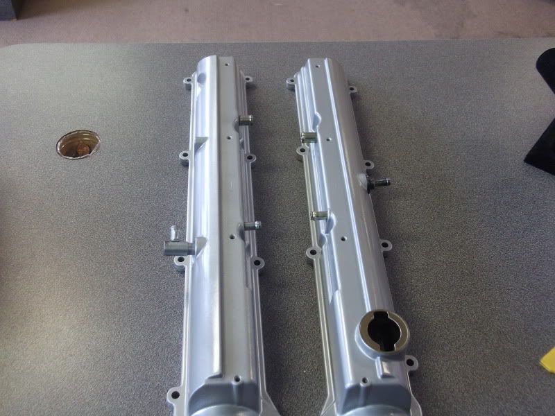

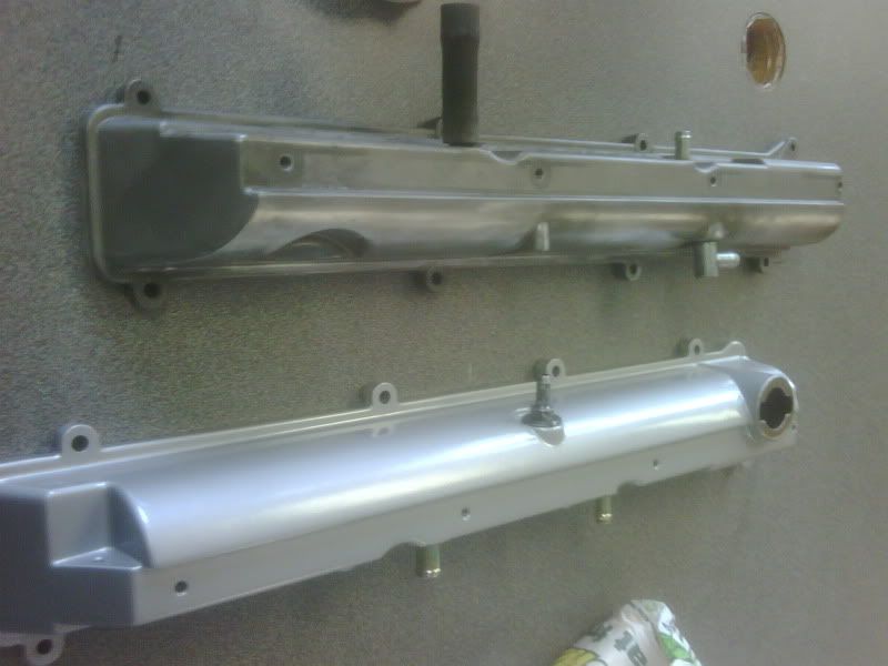

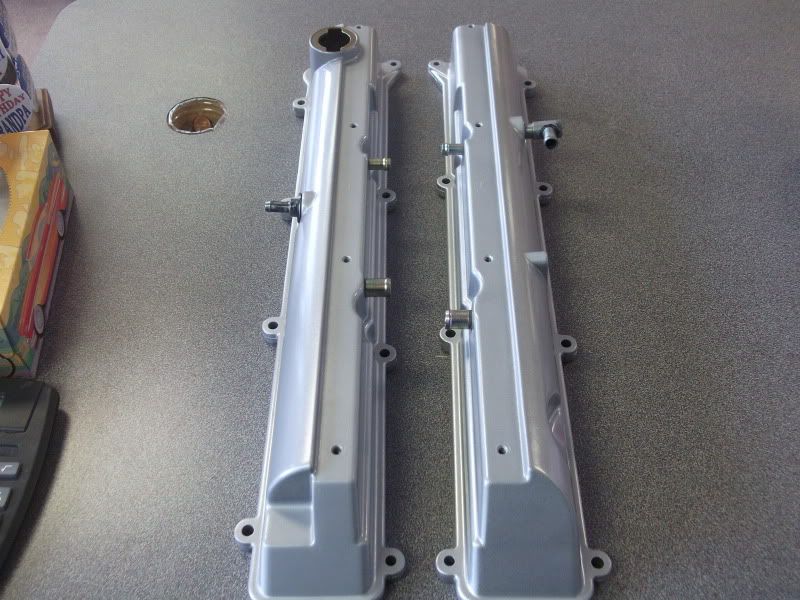

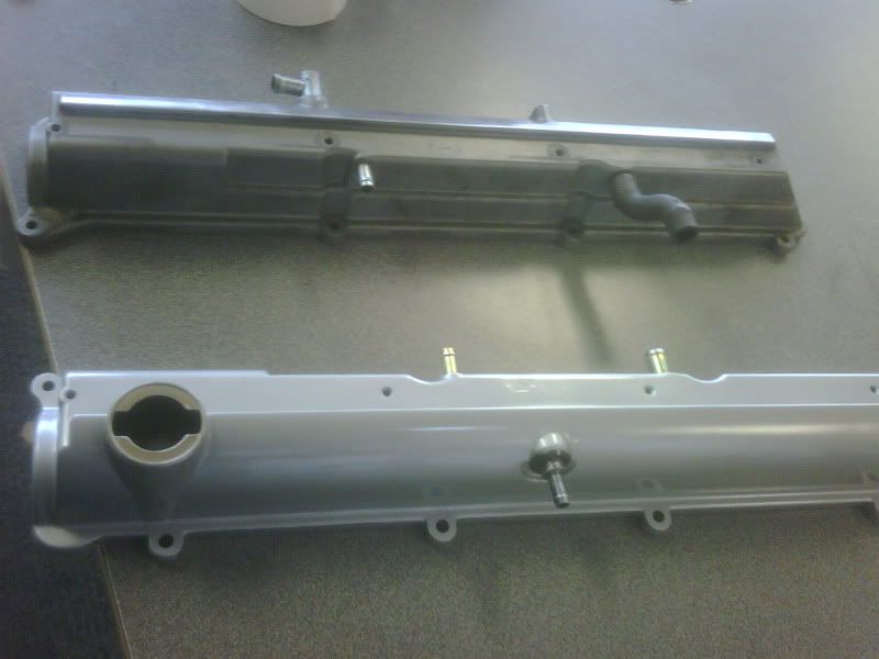

Oh and here is the finished product of the valve covers with a better camera.

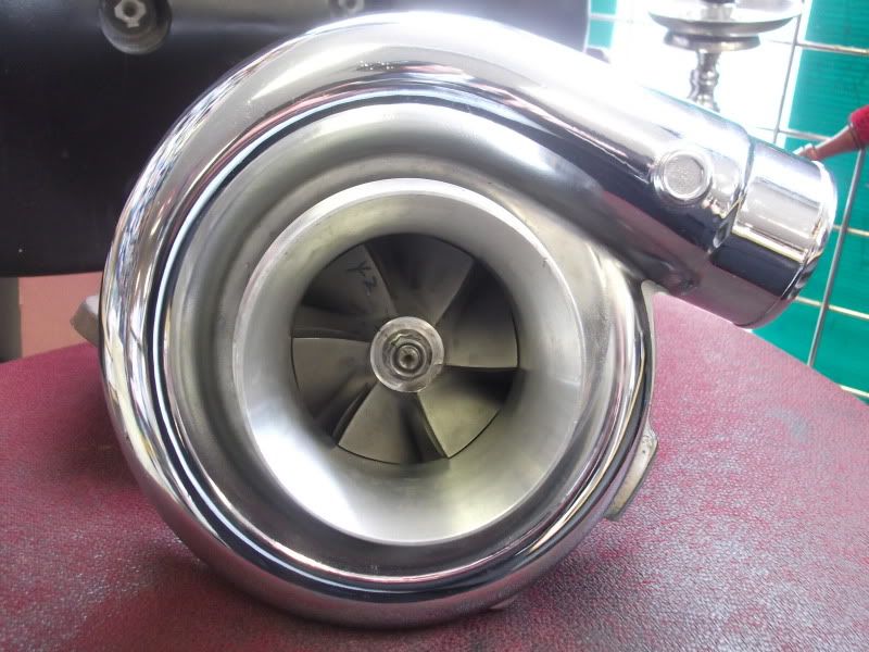

And also forgot to post a pic of the 76mm :)

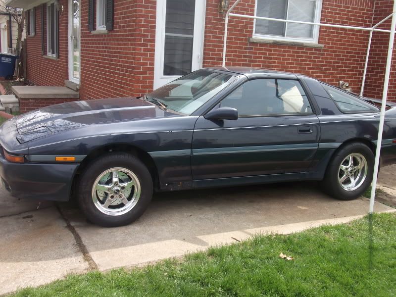

zambini
Jan 16, 2008
464
Detroit, MI

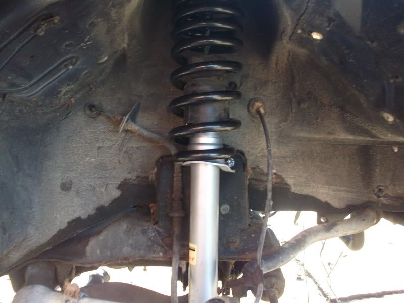

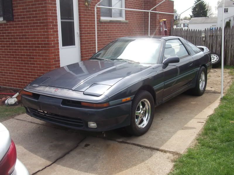

looks like shes sittin a lil high in the front :sarcasm:
might need to throw somethin in there to weigh it down a tad. :)

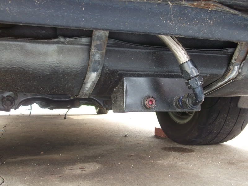

Here is the pump/filter and lines. Also picked up a cute little fire extinguisher lol

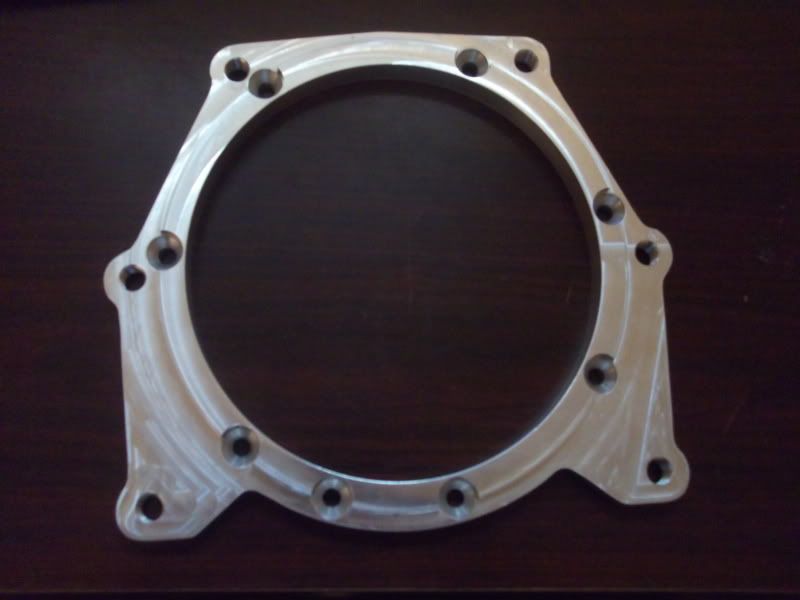

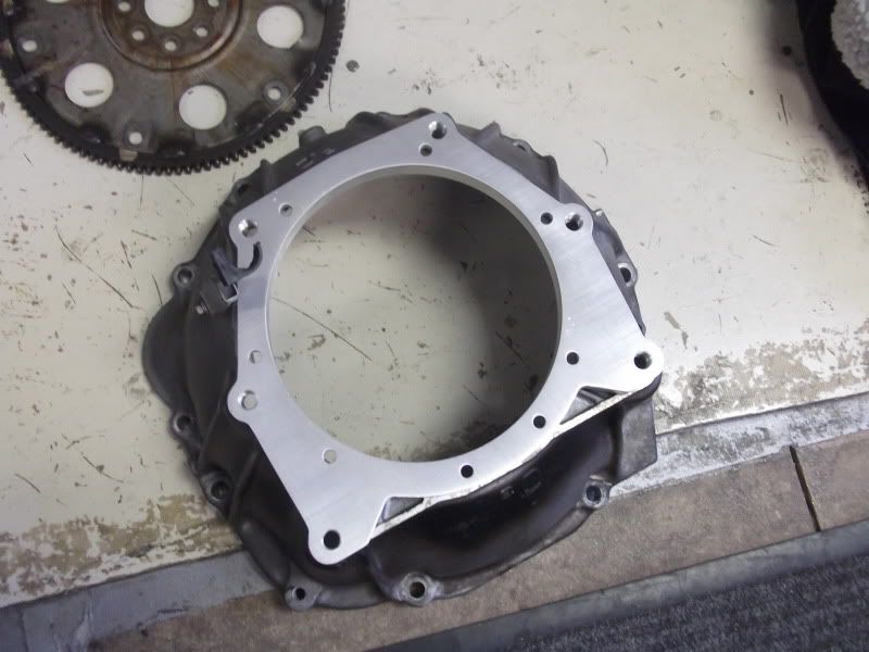

Thanks to the guys at SP, I received my trans adapter today after ordering it yesterday!!!
Should have the trans tomorrow.
madsupra88
BoOoOoST
Sep 17, 2005
1,245
Detroit,MI

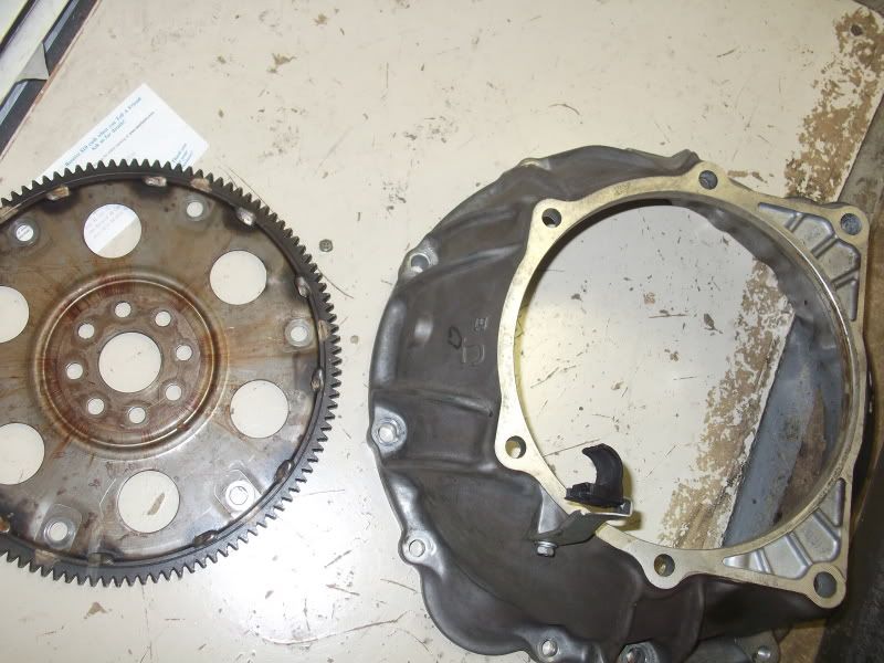

Update,
Picked up a J3 bell housing for this adapter and flex plate all thanks to brandon (enslaved87)
adapter bolts up perfect !
My built TH350 that will have the bellhousing chopped off soon, (taking it to my trans guy tomorrow)

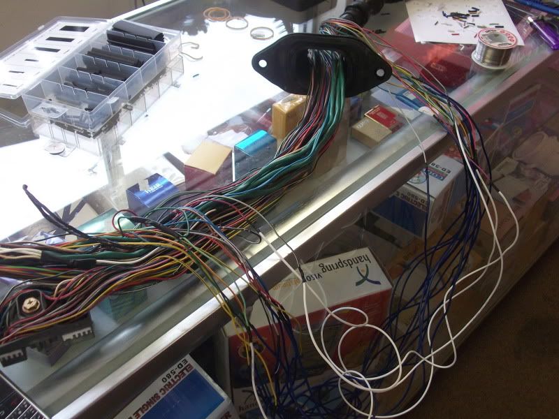

And last but not least i got a good start on my wiring , I'm taking my time on this so i should have it done in a few days.
