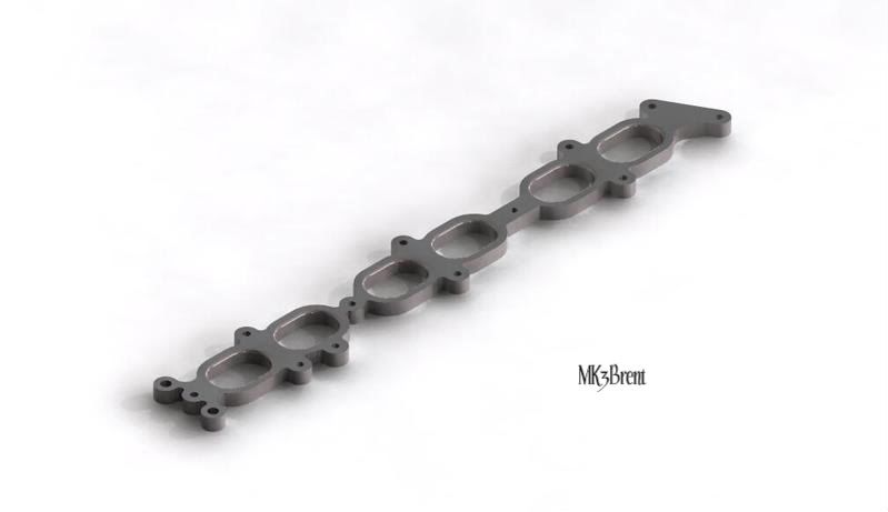

Thanks to 4U2.

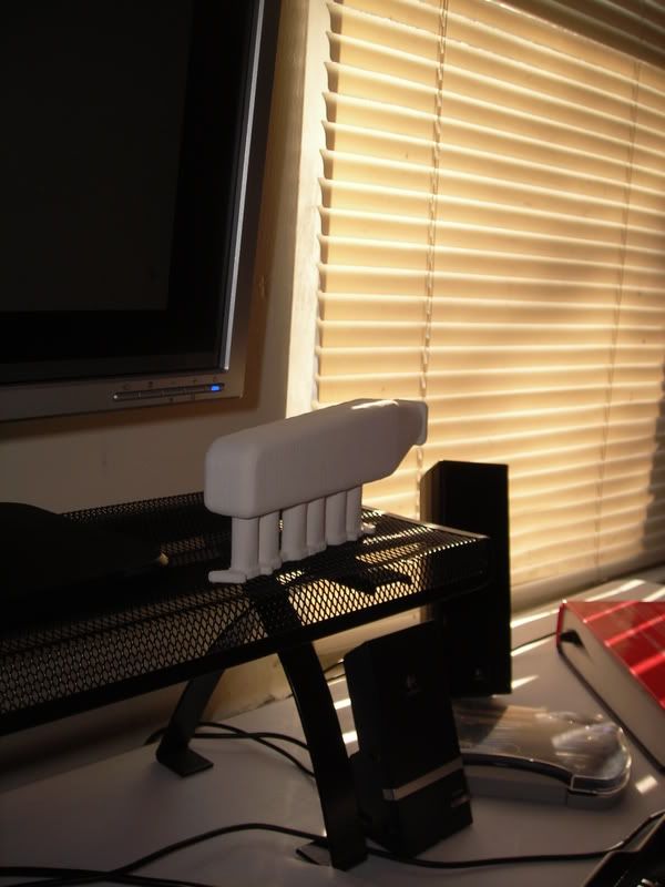

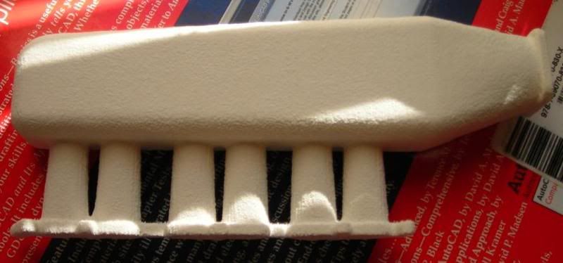

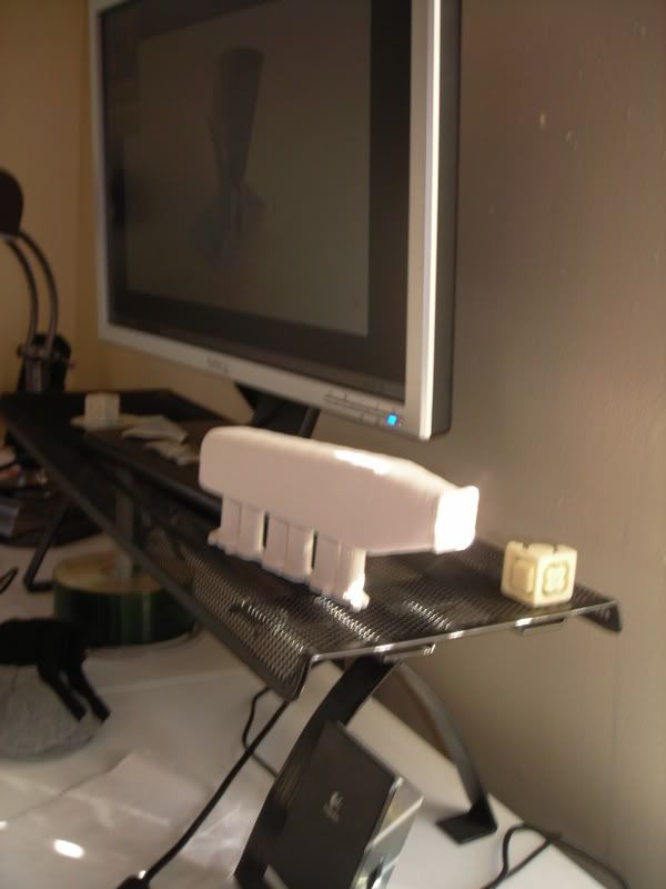

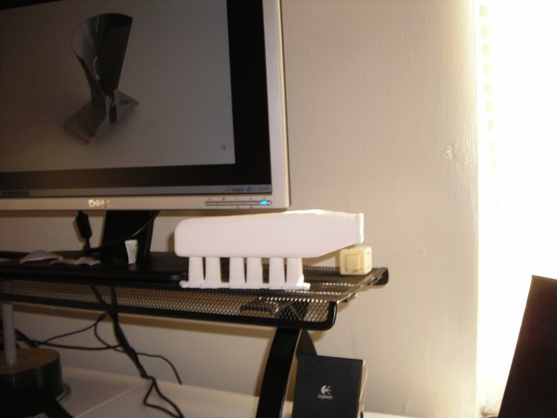

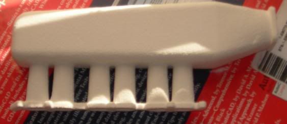

I threw together an accurately spaced model... should probably ignore the front holes, I improvised cause I can't remember where they are and they're missing from the DXF.

IJ.;1156001 said:
Looks good Brent!
Might I suggest some taper on the plenum towards #6 to keep velocity up and make life easier for you LHD guys with the brake booster in the way.
Thanks IJ.
Yup!
This model was just one of about 5 different designs I made... it's kinda hard to see in the silica, but there is a little taper... I think it's some odd 15 degrees.
I'm going to try making some tubular style ones next time around.

Rennat;1156394 said:
Whats the volume on that plenum? thing looks HUGE!
and your manifold bolts directly to the head correct?
I can calculate the volume the next time. (posting from work)
But,
Yes, it's the stock head bolt pattern and inlet pattern thanks to 2quick who sent me the DXF file.
I maximized the volume by manipulating the oval to circular shape.
PS.
It'll probably look a lot less "fluffy" once I spray it with acrylic.
aus87nat
May 20, 2008
Wollongong
are you designing to fit with the stock alternator location? And stock TB?
I could do a model a the alternator and bracket, as well as a basic head so you can fit the manifold up. Not much help, but might be useful for refining your design?
