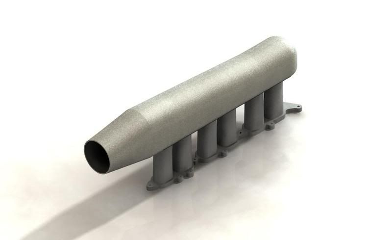

Sorry if this has been covered, but is there a provision for the stock brace that runs from the motor mount to the intake manifold? If its easy to do this might be something to incorporate so the manifold doesn't fatigue and crack at the mounting flange.
Jack
Dec 25, 2005
358
Stillwater, MN
Fitting a FFIM to a stock IC isn't really going to do alot in performance for you. Getting the stock IC piping wrapped all the way back around is probably going to cost more than picking up a Xo2 IC and replacing the stock...and much more efficient.
It will have the brace, we are going to try and use the stock one. It's easy enough to build into the casting at this point in time.
I was planning on the support/motor mount brace, but I will place it after the first pattern is made, it will be a pain in my ass to locate it in the right sport otherwise.

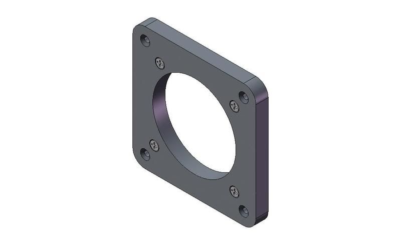

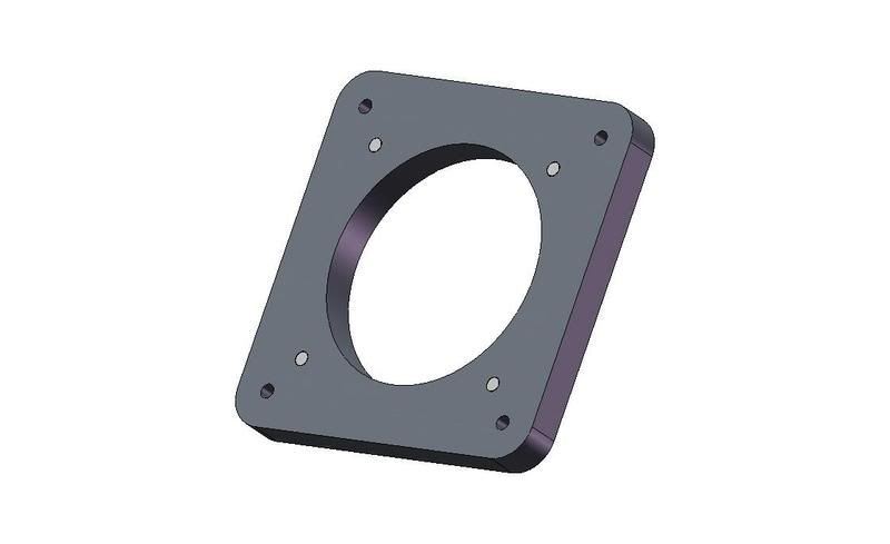

SupraSportJack;1228494 said:
The problem with producing blanks is it is slightly less work than making it a finished product. We have already got the flange locked in as the Mustang bolt pattern for a 90mm. That allows us to make the largest opening and make one adapter plate, so far it's been the easiest thing we had to figure out.
i was just thinking ,you could make the intake flange big enough to support a couple of different tb's.if somebody could purchase the mani and have enough beaf on the flange to drill it for a q45 ,let's say.i figured it was worth mentioning because the q45 can be had for $60 with the tps.i believe there is also a sticky on wiring it up to work with the stock ecu.
if you use an addapter flange ,it might affect ic pipe clearance.the q45 might be a little longer then a aftermarket mustang tb.i have a q45 here that,i could get a measurement on to compare
Jack
Dec 25, 2005
358
Stillwater, MN
The adapter flange won't need to be thick to work. I have a 70mm & 80mm TB in the Q45 pattern and they will sit in the same location as the 90mm with an adapter plate. The TB's we use do not use the coolant lines and such which is what usually makes the "Q45" so long
MK3Brent
Very expensive....
Aug 1, 2005
2,878
Greensboro and Greenville NC
I don't know if you thought about it, but what I was going to do, Jack, was leave the TB plates either blank for customer's use, or tap 2 different patterns and thread in blind studs for the holes not used.
These are not to scale, or anything.. just to give an idea.
Gasket should cover the inner holes if using the latter, but some kind of thread seal should be used too.
