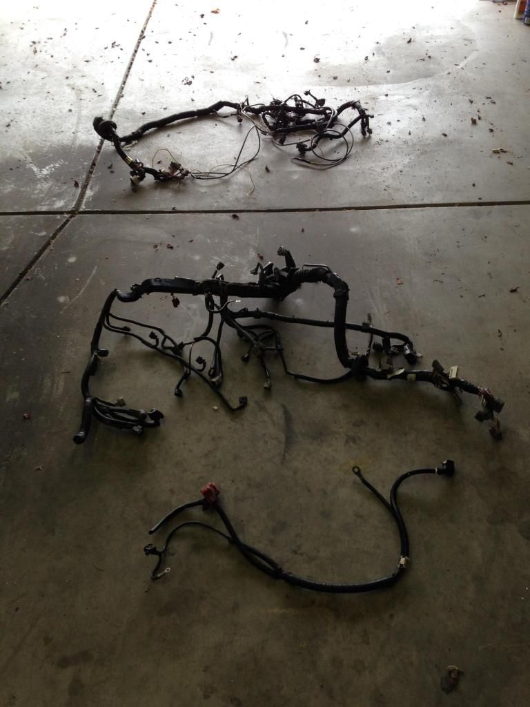

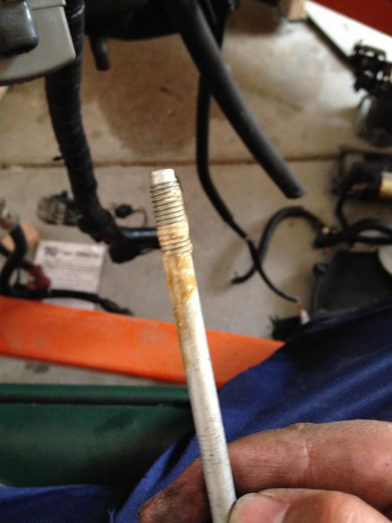

Alright so wiring harness is off. I have the 7m harness and the 1jz harness ready to get wired. They're packed up and getting shipped to a member on here to help me. As I was taking off the harness, I had to take the intake manifold off. I saw this on one of the bolts:
Isn't that blown head gasket or something? Somebody help plz.
Here's the harnesses:

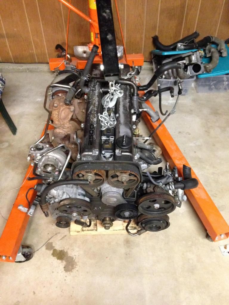

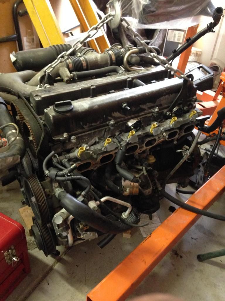

Here's the motor as of right now:
I'm moving soon, so I am not stripping it entirely yet.

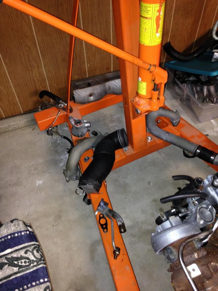

Oh, and here's the metal rail or bar that was under the front center piece:

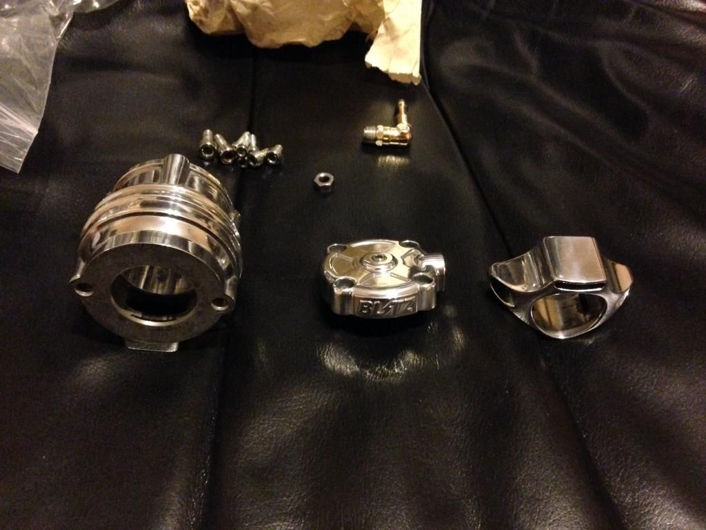

Oh, I also sent the BOV out to get re-chromed. I'll get pics of that up tomorrow night.
Do I need 2 BOV's? Who can help me with the mounting piece if my piping kit does not have one, or basically, how do I mount my BOV? I know you need to weld a piece onto the piping, but are there piping kits that have the hole already? So I can avoid that. If not, do I just go to any welder to have them cut and weld the BOV mounting? I've done tons of research, but as you can imagine, there's a lot of information out there, so I have not read it all yet. I'm kind of cheating, but plz help haha

for the bov you can just buy silicone coupler (hoses) that have the flange already in them, Or you can also buy the pipe with the flange already welded in, I'm just using one bov. don't know why you would need two. My 40$ driftmotion Greddy RS Rep does the job just fine and sounds pretty bad ass.
Check ebay for the pipe or hose with the bov flange, i know they have a bunch

Ya I see lots of kits that have a BOV with them, or the flange already on the piping, so I should be ok. Idk about the 2 BOV's, I just see some people doing it on TT so I was curious.
