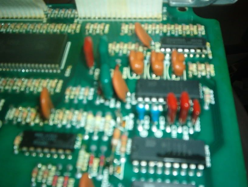

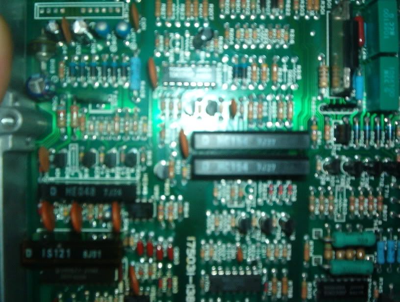

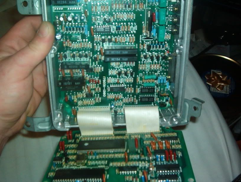

I opened up my stock ecu after I had AEM in hand. It is from a '90 5 speed with 7M crank. Sorry, some of them came out a bit blurry.

From the first pic that chevyeater posted, this is the oscillator or "crystal" circled in red. It looks like a standard 4 pin oscillator, would be easy to change out.
