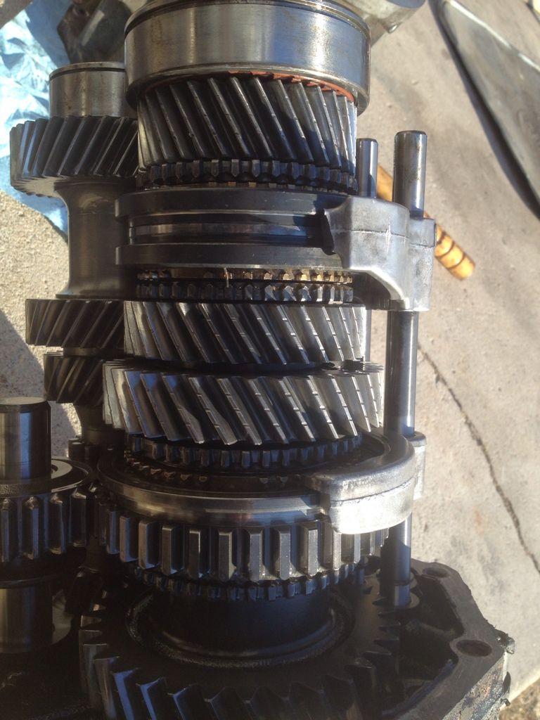

So have an update.
I'm gonna be giving the built r154 one more go at this thing and see how long it lasts before I tear gears apart...

naaaaaaaaaa
Do you know who I am?! ;)
ill be CMM the 2nd, 3rd gear and counter shaft. get it cad modeled by Dustin, and Ill machine it out of 9130 alloy.
but for now ill thorw all the bearings in and all the MC parts and see how it hangs

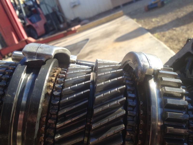

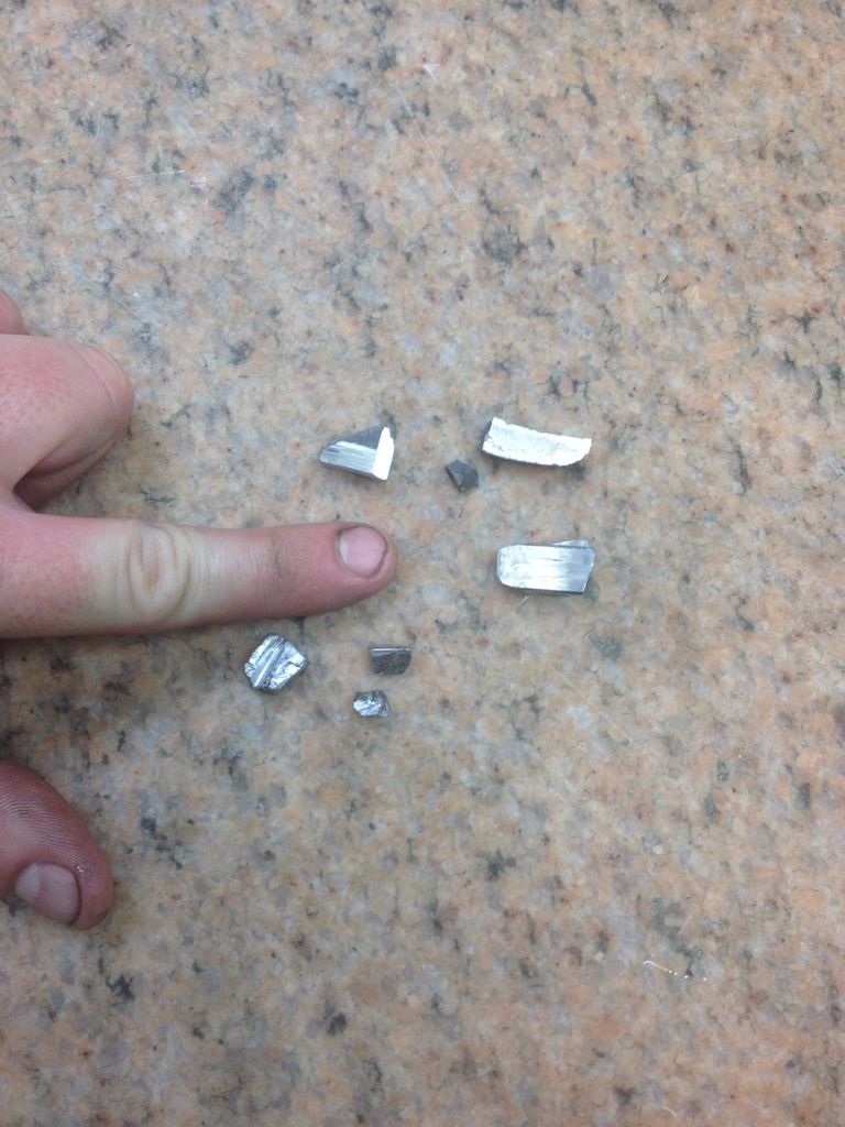

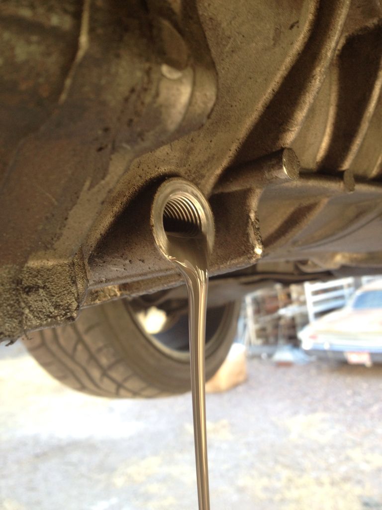

Yeah I think I have you beat, mine was pure metallic but also burnt
From the forks going out at the same time
