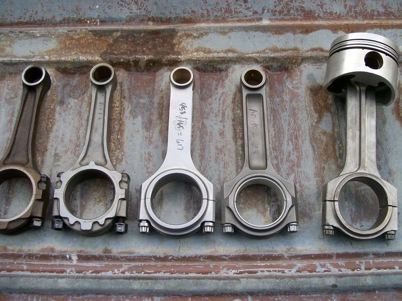

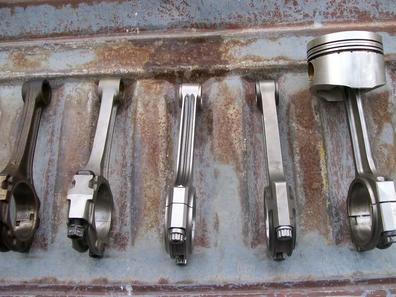

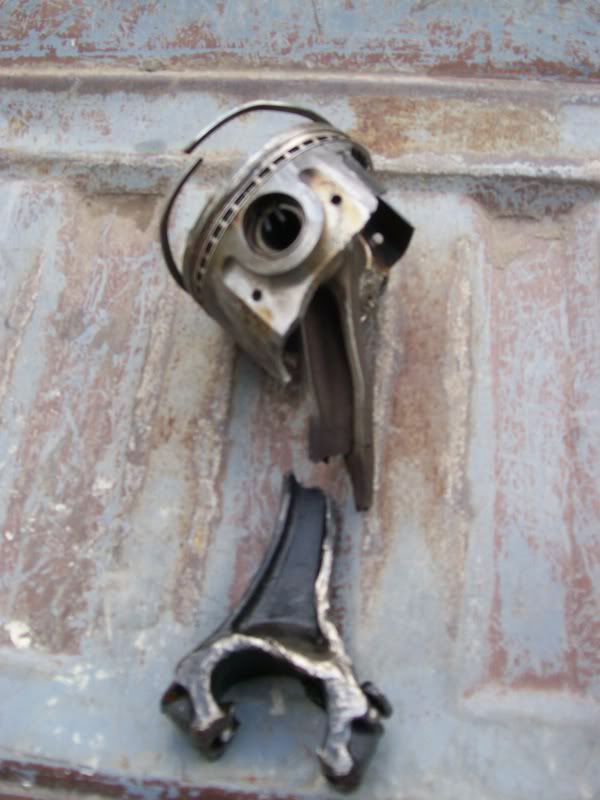

Rennat;920036 said:
you should post the picture of the twisted rod, it looks nassssty.
I'm assuming that the eagle rods are in the middle?

need new tires;920026 said:
all of the aftermarket rods i have seen will support almost anything you can throw at them.
i run crower but seen nothing wrong with even redone stockers(450-500rwhp constant)
The eagle rod in the middle does not look shabby to me. They may or may not take 1600 horse power, but the Tech engineer at Eagle says they can. I think unless someone can say that they can't, and support this with factual conclusive data we have to look at them to take at least 1000 horse power in my honest opinion.

Is that a stock Twisted Rod?
I can only say that assuming everything you are told by someone you are buying from as FACT, is just plain wrong. You aren't gonna find a bunch of 1500HP 7M guys in here to support anything factual either good or bad. I think Nate running them in one of the highest HP cars on here would have to be about the best info you're gonna get. I would trust them as much as any other aftermarket rod.
