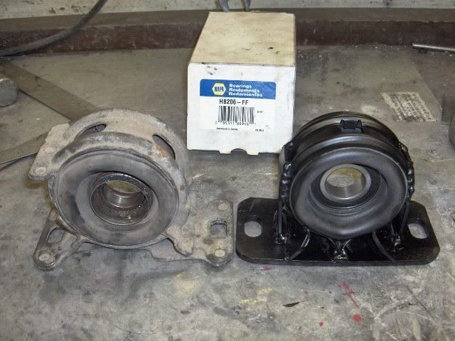

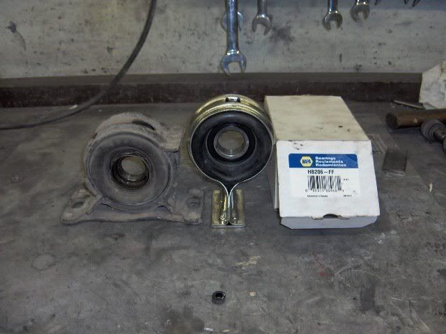

I found a bearing that is the same diameter from napa I made a whole new bracket its from an 92-94 blazer it costed 30$+ 10 in steel the only difference is the bearing is slightly wider but there was plenty of thread on the shaft left
This is what im going to end up doing for now until I go one peice. Thanks for the heads up on the blazer bearing.

lintlars;1283742 said:
Dont waste your time with a one peice speaking from experience here Ive gone back to the two piece and it will stay. Its a blazer or a bronco I cant remember which one
well the napa box in the pic has a part number so il just use that haha, either way im stoked.. mine is so sloppy right now. Oh and is it still working good for you? how much of a difference did it make?
