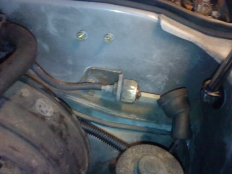

But, Was is das?
I know there´s a black one too but its for the Cruise Control (it´s bolted in the mount)
Also removed both Cruise control (with cruise computer) and the heater valve with all the vacuum lines etc, are they even needed? (it´s been unplugged earlier this year cos the heater valve was broken)

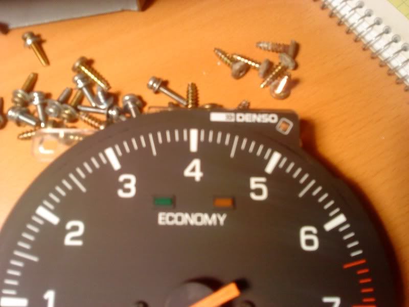

Thing in the second picture is a vacuum switch or something, sends the signal to those two little leds on your tachometer (Eco or not so much :D - or you can see when there's a vacuum leak). I at least think it is. Is located on the drivers side firewall.
I'd install it, or else, without other mods, the led in front of you will glow orange.

Looks to me like a hood pin switch. The type that is pushed down when hood is closed for alarms and such.

I'm convinced it's your speedsignal for the cruise system.
