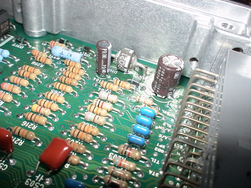

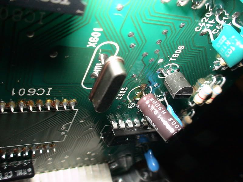

i just took my mines ecu apart to check it out because of what bigaaron told me about the problem i have with my car. now im not electrically inclined at all, so i dont know if it is or not but i think i found a bad cap on one of the 3 boards.
heres ones that looked good to me
heres the one thats in question

alrighty, my car was throwing a code 14 and not starting at all, itd just fire and die. this can be fixed right?
JustinGotA1j
Jan 28, 2007
532
Chilliwack
Yes it can be fixed...if you have enough time, send it to Driftmotion since they offer a repair service specifically for ECU's or sometimes you can get lucky and a local electronics repair place (for tv's etc) can do the job for ya.

Cool. Someone else has the same problem as me. My car was doing the same thing, and I opened up the ecu and have a leaky cap aswell. Send your ecu to DM.

gettin a hold on these caps is frickin tough, local place has nichicon caps, but they use a different parts number system, so i have to call nichicons office in chicago tomorrow
