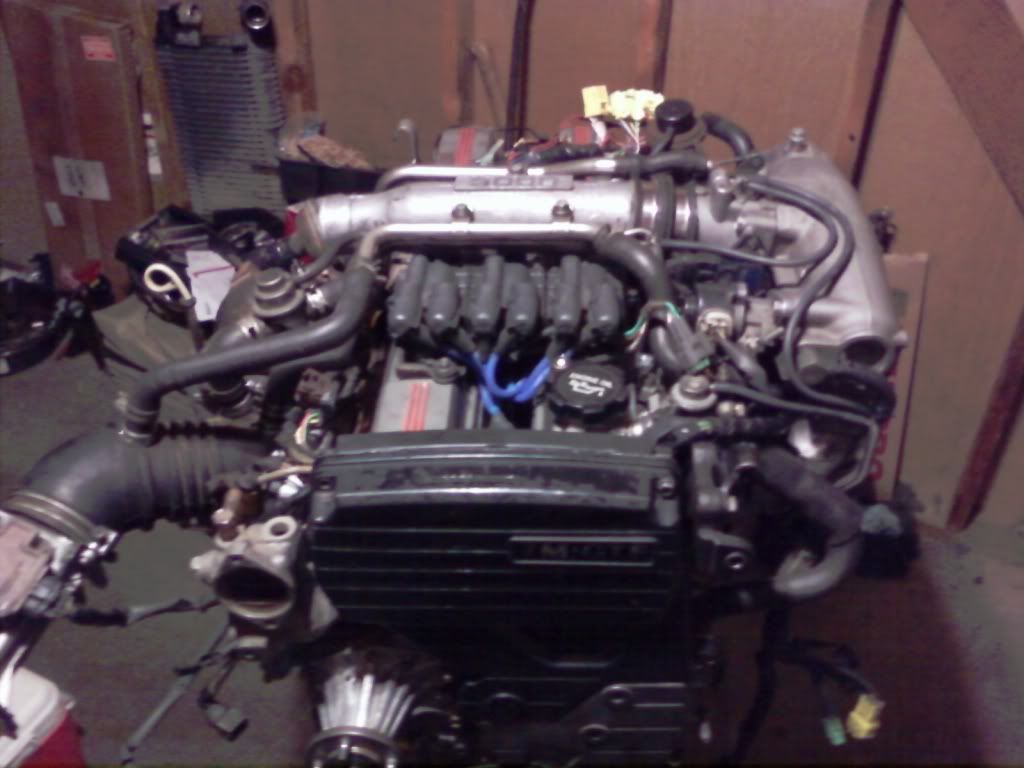

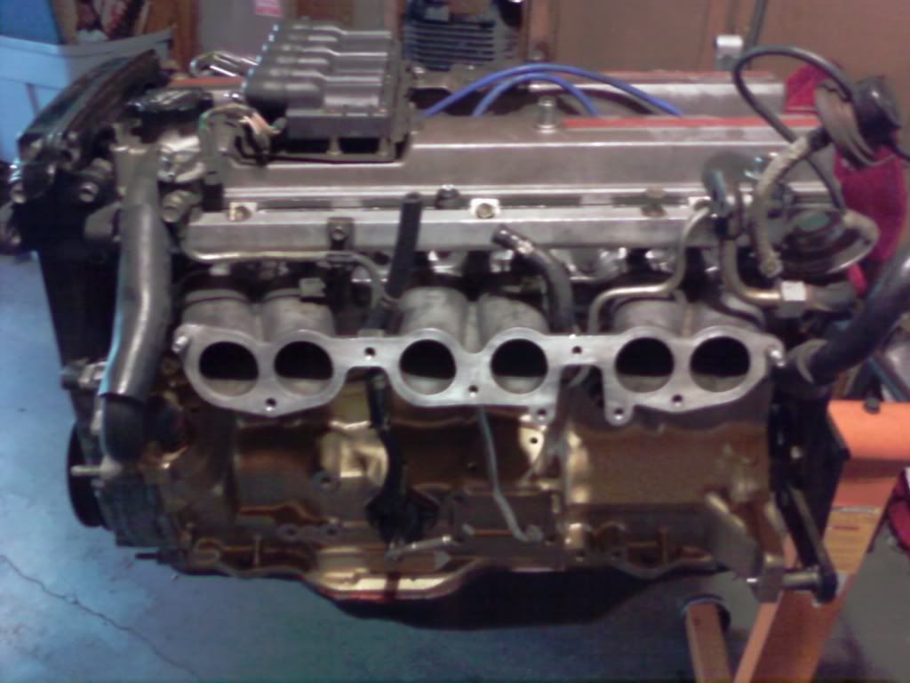

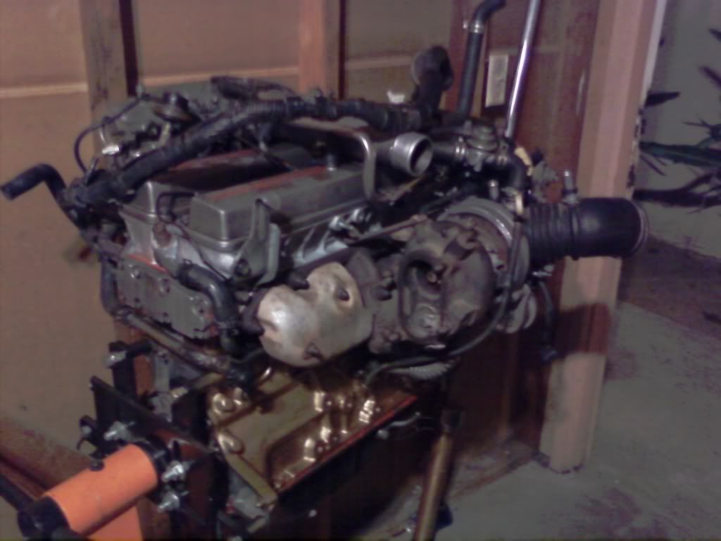

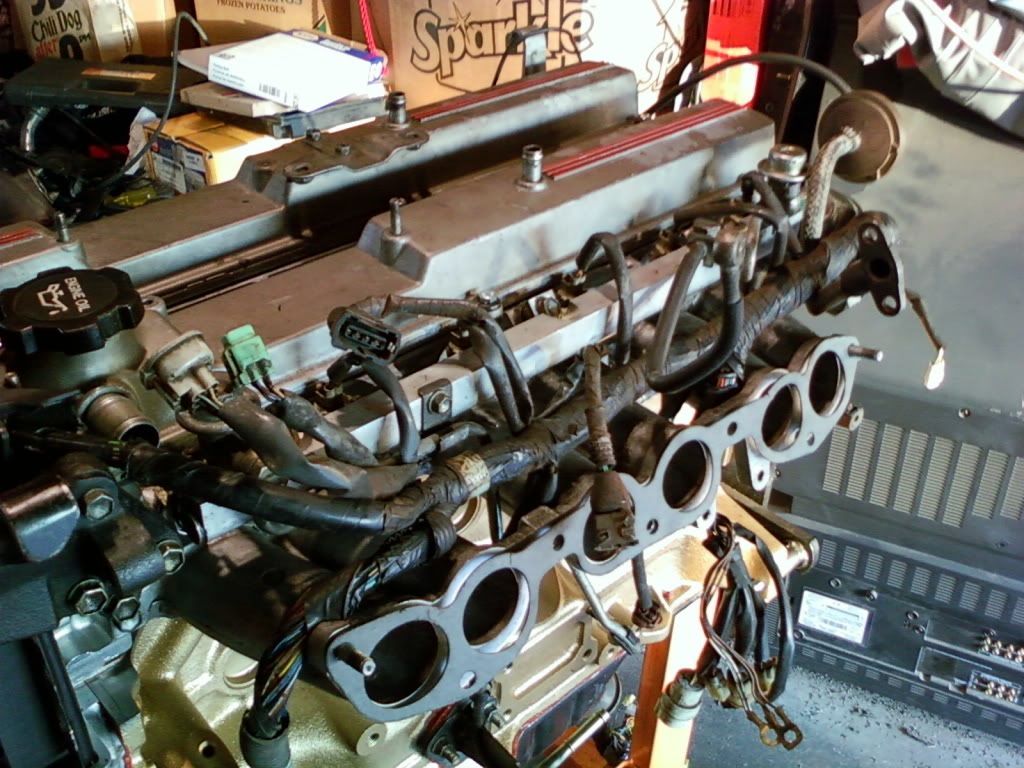

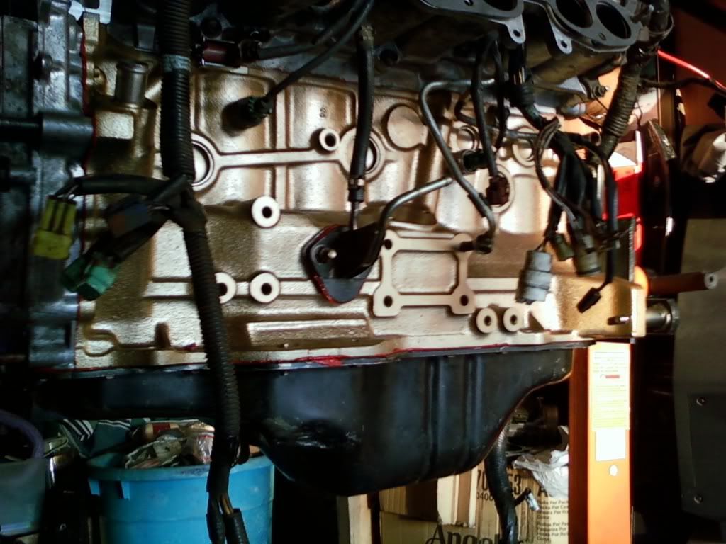

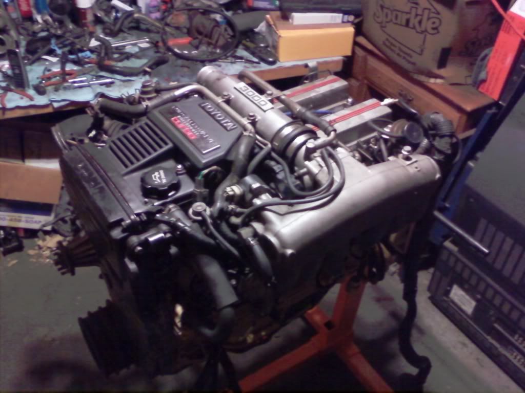

this is all i was really able to get the other pictures wont come off of my phone but they were all parts and such. im going to try to tow the car and old motor there tomorrow but im not sure how thats going to work out yet. these will hopefull give an idea of where im at. is it really that far from being done or am i decently along?

super51fan
Jul 28, 2010
497
Indianapolis
You are doing good. Need to install the fuel main and return lines. install the wire harness and upper intake.
Put on your turbo and coolant lines to turbo.
Make sure knock sensors are installed and don't look all melted distorted from 25 years of heat.
I would replace the Heater hoses and the "90 degree" hose now. Much easier.
Once you are close take your time and refer to the "EM" section of repair manual .
Hope to see you car on the road soon.
Need to address trans cooler lines . Hopefully the ones in car are not cut.

the car was running and just developed a rod knock so those lines should be fine, hopefully lol. warning lots of probably dumb questions incoming. where are the knock sensors located at? arent there two 90 degree hoses? and is the heater hose another one of the definitely do not re-use kinda things? im really strapped for cash right now and have to finish this thing within the next week or so or it wont get done. i know pretty much all the hoses on the old motor are good just want to know if its a def dont re-use situation. also the harness thats in the car already is an 88 and the new motor has gray plugs. i know this was already answered but im really confused about it, will they plug up and run fine or will there be stuff that has to be cut and spliced and stuff?

The harness matches the car. Use your old harness. The sensors on water outlet housing may need to reuse old sensors or swap water outlet housing. It will plug up and run fine except for two or three sensor s on the water outlet. What they told you before is correct.
If broke re use all you can. It is just easier to replace where you are at now.

would where im at now be a good time to get all the hoses and lines hooked up before i start to put anything else on or would i not have trouble fitting stuff with the motor assembled? and good i was getting worried about the harness and stuff thinking about it today lol

looking good the little 90 hose by the 6th cylinder on the exhaust side is one of the 90s and then right next to the 1 exhaust manifold runner is the other one. If they are not all soft and squishy then you should be fine to use them. Put them on before you slid the block in way easier to put them on now. Lay the harness down in the intake now before you put the motor in. Knock are 2 big round i think 26mm size sensors that go on the intake side of the block one hole is between cylinder 1 and 2 and the other is I think between 5 and 6. They have a single wire with a green clip on them that runs through the middle of the intake.
