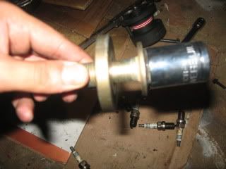

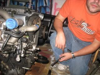

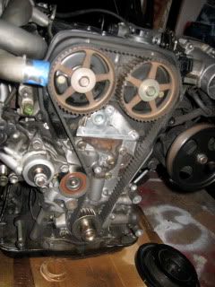

FINALLY GOT THIS SHIT OFF LMAO Thanks to the help of Johnnyredline and my neighbor. Basically the impact sockets i bought just made it worst. then we beat a 12 pt 21mm into the crank bolt and it came out with a breaker bar and a cheater bar:biglaugh:
heres pics
