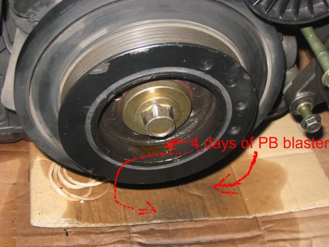

before i keep going........
heres a pic of what it currently looks like
you be the judge.. should i keep going with 3/4 impact gun or seek profesional help lol

The edges look a little screwed up. Did you use a 22mm or a 7/8? I've only had this problem one other time and it took a lot of work. My 1/2" snap on gun didn't even do it! I had to destroy the bolt!
I cut the head off to relieve the tension then took the pulley off. Then tapped the bolt reverse thread and got it out with a bolt.

dam bro that sounds complicated as hell lol to be honest this is the first time i stripped a bolt and the first time i broke a socket hahah i used a 22mm 12 point then a 6 point.

12 point for crank bolt? thats your problem right there. i have done this in/out of the engine with any 6 point. 1 person held the driveplate, usually with a crowbar and did this while the oil pan was off or through the inspection cover, and used a breaker bar on the front. easy as pie. no flame or pb blaster
