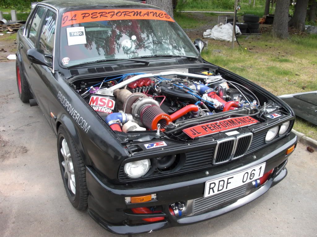

I'm starting to lean more towards keeping it m20 & boosting. They have a plug and play meggasquirt ECU for my harness. That's pretty affordable, also the map ecu 2 is another option for this car as well to eliminate the afm and tune both Fuel and spark.
I just saw this,
This car is from Sweden.
Made 647whp and 790wnn
Oringed, and z45 + springs
milled pistons cr about 8.2.
GT42
VEMS ecu.
2.5
stock rods
I think with the 2.7 with the I head, MHG, and a gt35r should make this car very fun. Also the m20 motors are basically disposable being that go for any where from $100-$400. They are basically the 7m of the e30 world.
