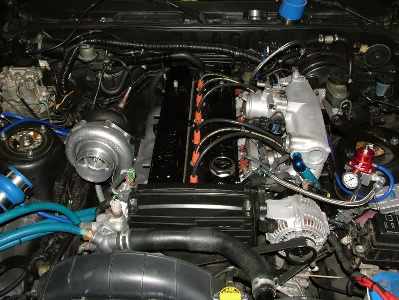

Hey, awesome relocation project!!! are you worried about rain or whatever coming up and getting the coil packs wet? Im not sure if water would hit that area but im just curious.

They are up high enough, and I have good quality boots on there.

hmmm dont like runing leads thru intake manifolds and across injector wires!
you will get lots of noise near your ECU wiring and also have the leads break down sooner arcing to the manifold.

The wires run right over the aluminum head in stock form, and the coilpack bracket itself is grounded. The injector outputs are low impedance ground outputs not susceptable to noise. The injectors themselves are more electrically noisy then any voltage that could be induced into the wires. And I'm not using cheap stock wires anyways, they are high quality 8.8mm race wires that can handle far more voltage then the stock coilpack output. I don't have the wire seperators on there yet, and the wires are not as close to the harness as it looks.

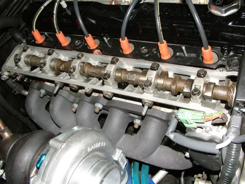

Thanks for the motivation, I went out in the garage for a bit tonight.
Here's where it's at now:
Inside the valve covers looks like the day I put the engine together about 3 years ago. 20/50 Castrol VR-1 Racing Oil ftw!

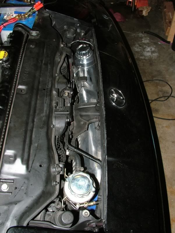

New coolant reservoir and relocated ps reservoir, coolant resevoir not mounted yet.

MMMMM....Garret, I like. I like where you've got the new resivoir at (I believe it's the one where the old one was) I have my new catch can there and I will be relocating my battery and putting my new resivoir snugged up to the bumper.
