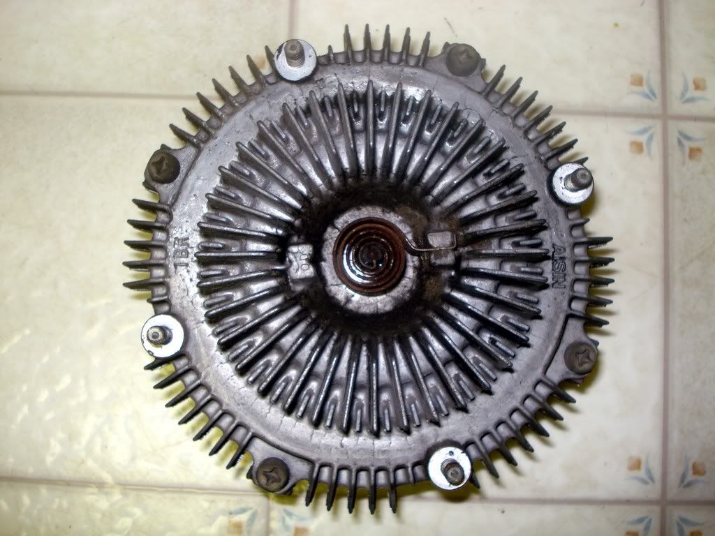

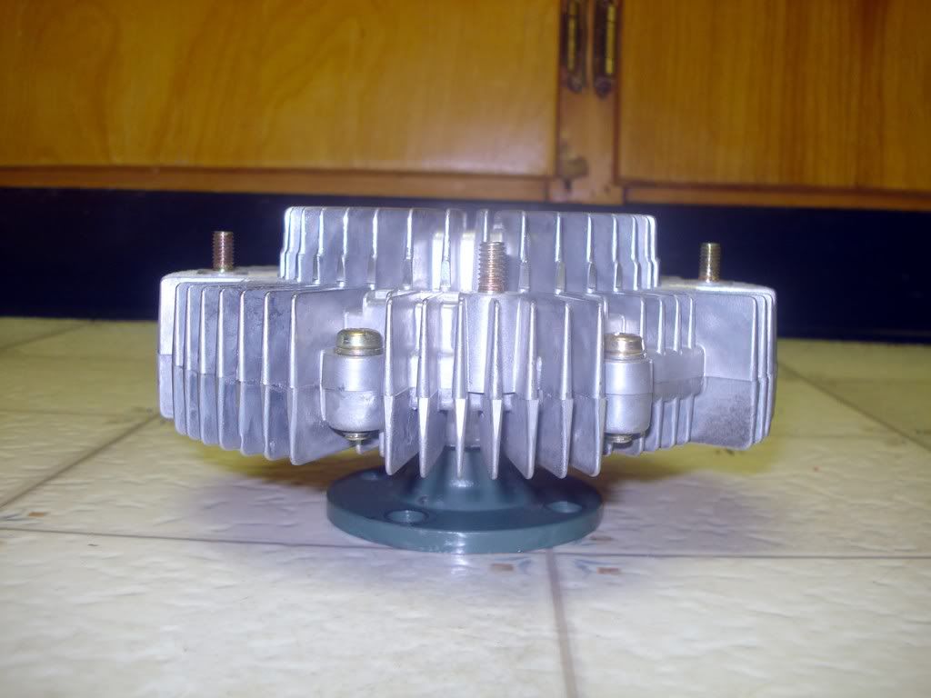

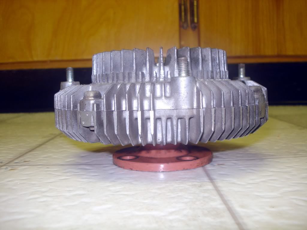

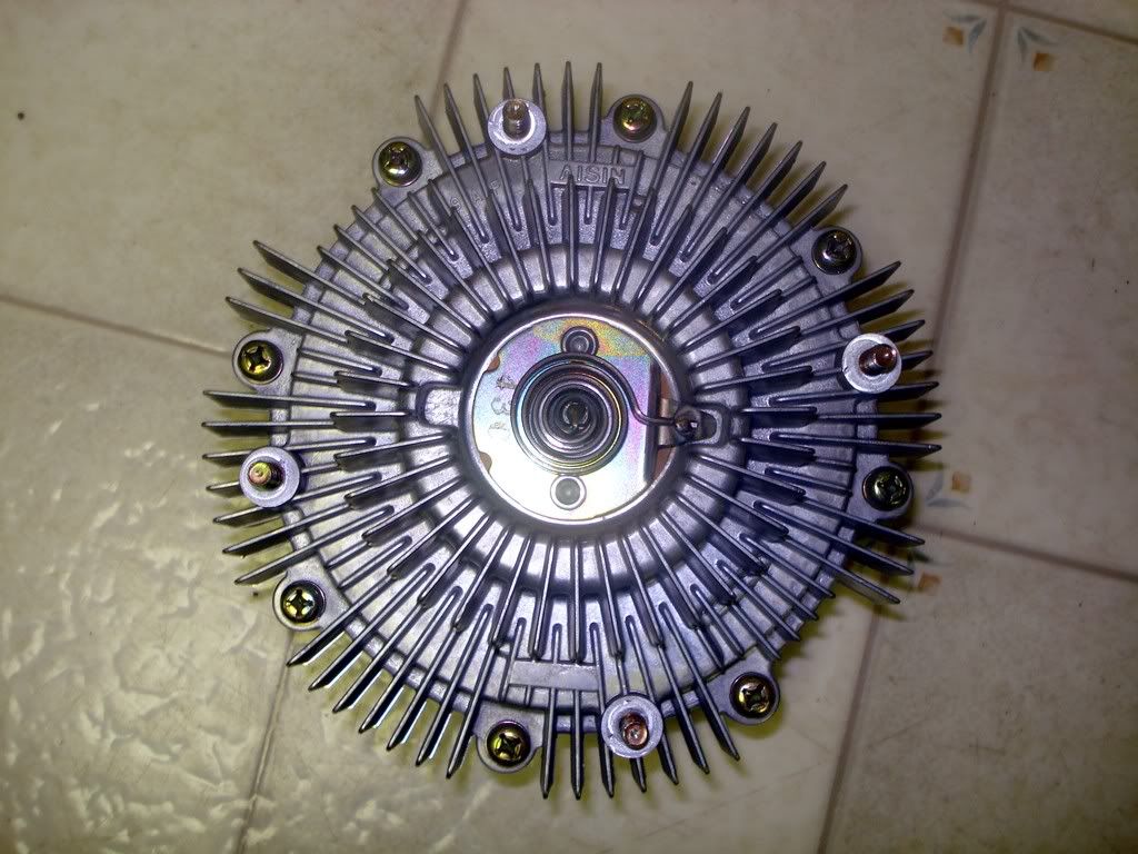

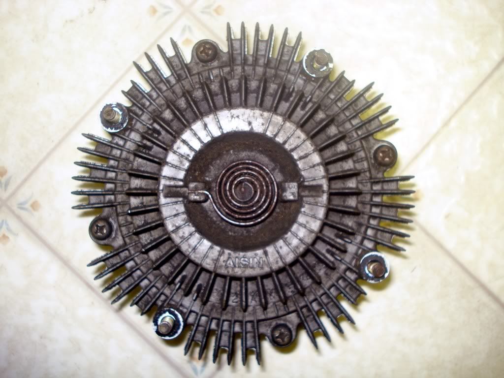

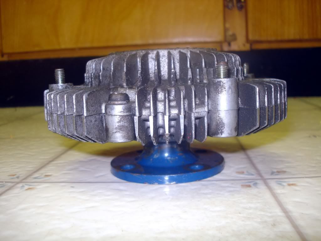

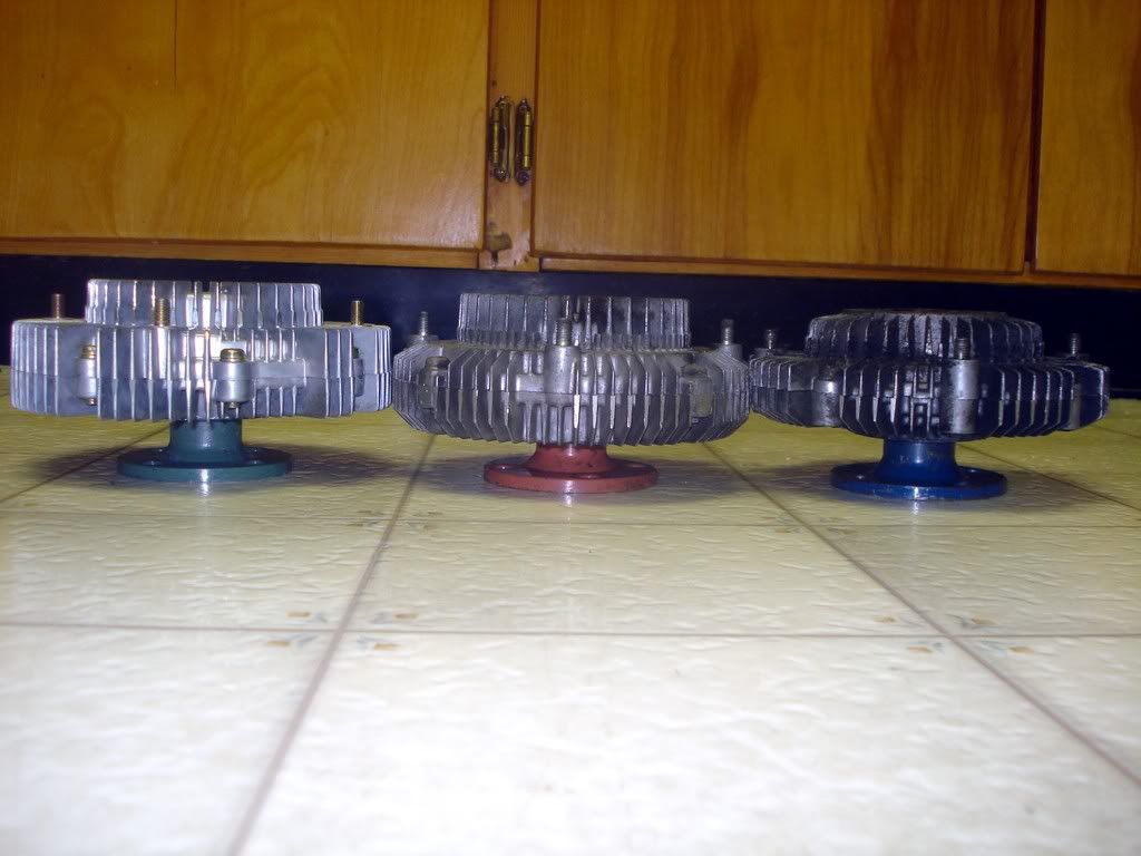

I finally got pics of the three clutches.
Here's the GE clutch from the top...
...and the GE clutch from the side.
Here's the GTE clutch from the top...
...and the GTE clutch from the side.
And here's the Tacoma clutch from the top...
...and the Tacoma clutch from the side.

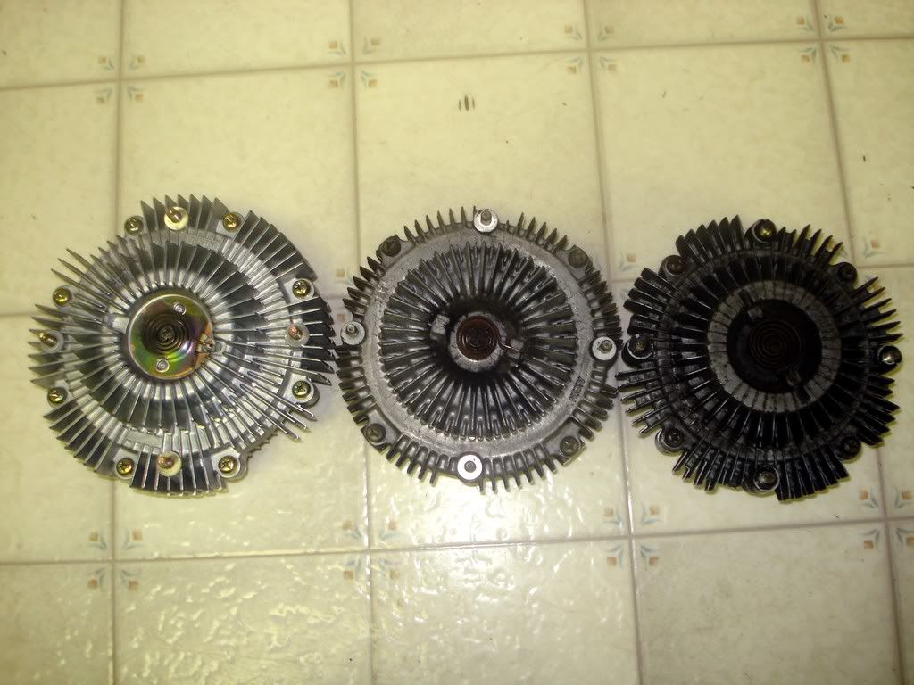

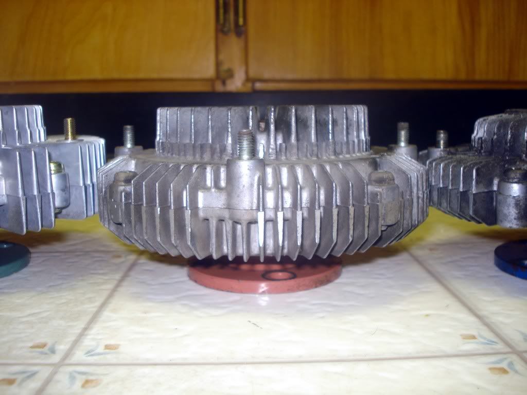

Finally, here's a shot of all three (Tacoma, then GTE, then GE) from the top...
...and all three from the side.
Also, something that's noteworthy, notice in this pic that the GTE clutch puts the fan just a hair closer to the radiator then then GE clutch. Also, the Tacoma clutch will have the fan a hair closer to the radiator then the GTE clutch.
It'll be next spring before I have the Supra back on the road again, so I won't know how well the Tacoma clutch will work until then.

I'm just using the Tacoma clutch. The fan is the stock GTE 10 blade that came off the Supra.
Like I said, for $35 shipped it's worth a try. If it doesn't work right, then I can always replace it with an OEM GTE clutch. If it does end up working right, then I just saved myself about $100.

THATS why my clutch fan sits so freakin close to the radiator. the mounting points on the green base are a good 3-5mm taller than the red/brown base clutch...
f-this, im going to go and find me a brown base clutch to move it back so i can space my radiator a little... i thought it was just my HUGE ass radiator, but its partly my fan clutch....
