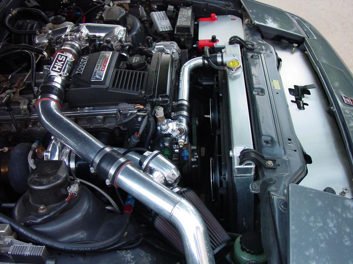

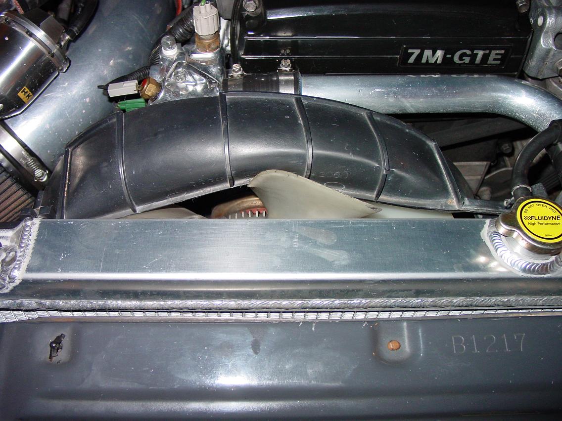

Had a fan clutch lock engaged on me this past summer. This was the result:
I have since decided against the factory fan and opted for the "evil" twin electric fans:
Haven't had an issue with the Flex-a-lite electric fans yet, but they are wired with 8ga leads and controlled with a Flex-a-Lite 400-31163 fan controller.
The controller keeps the fans running for about 30 seconds after the ignition is turned off for a bit of additional cooling. The water temp sensor was a perfect fit in an available port in the T-Stat housing. The controller varies the fan speed based on temp thresholds you are able to set.

Which radiator is that you're running with the shroud? (As i'm surprised it fits)
Also how good are the electric fans (rad temp wise?), since there is no shroud or clearance as they are right on the radiator?
