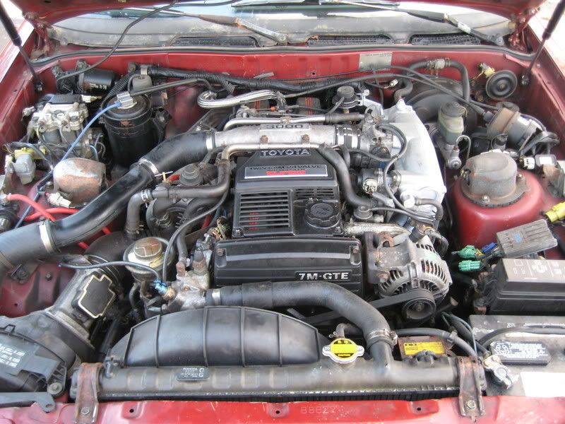

Idk man, is the guy on the forums? I've been burned buying an already built motor before...turned out to be stock motor with stock headbolts and composite head gasket. I would just be careful and see how well you can judge the guys character...although thats neither here nor there. In reality i could've checked for those things but didnt because i thought i could trust the seller at the time.
Im not an expert by any means but I would:
1. Take a knowledgeable friend with you.
2. Ask him if you can have him put the engine on a stand by the time you get there.
Then ask if you can:
1. Take off the oil pan. I think this motor has stock rods? Either way, you'll be able to see ARP rod bolts and other supposed hardware, and the bottom side of the pistons which'll tell you what they are. Turn the rotating assembly and make sure it turns freely/ visually inspect and listen for metal to metal contact where there shouldn't be.. I guess check clearances if you can...
Also check for metallic in the pan which is obviously bad.
2. Pull the valve covers and look for ARP head studs obviously...they have "ARP" imprinted in them and look nothing like stock head bolts. HKS metal head gasket also has tabs sticking out on the intake manifold side IIRC so you'll be able to tell if the HKS MHG is what is in there.
3. Look at all possible seals and see how they look although ill say: the motor does look rebuilt. Its more a concern of if theres anything wrong with it.
4. Take off the front "7MGTE" timing cover and check out the timing belt for abnormal wear. See what the spark plugs look like.
Sounds like you're being a picky bitch when you show up and ask for all this but if he's truthful and honest, he has nothing to hide. If everything checks out, float him an extra $20 or something for his compliance and nothing you took off is hard to replace. Btw, this isn't fail safe but it would help a lot. HTH.
