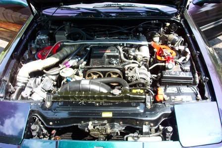

Also removed mine on my last 89 turbo ran with no problems and no explosion. I just ran the tube throu the hole under the canister(where it use to be) and installed my catch can there. Sorry this is the only photo i have my my last supra's engine bay.
And is alread removed from my current 89 turbo.
Good Luck.
