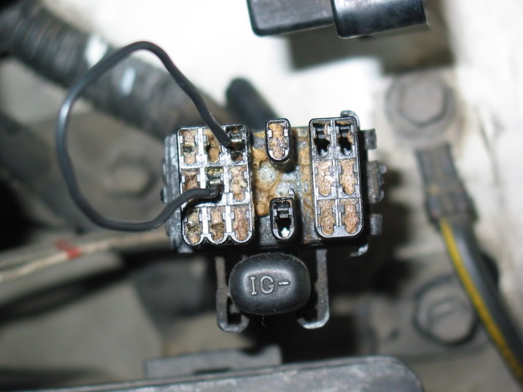

There ya go! And what are you doing when trying to check codes? Are you using a paper clip? The ends of the paper clip have to be bent into position so that they are aligned with the correct terminals on the diag. block. Push the ends of the paper clip into the terminals, pushing the ends to the left and down into each terminal...it's kinda hard to explain...in each terminal, there is a piece of metal that is visible, push the end of the paper clip into the terminal slightly to the left of the piece of visible metal...that's the best I can explain...and it's late...lol.

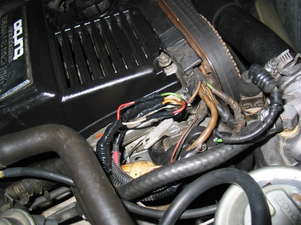

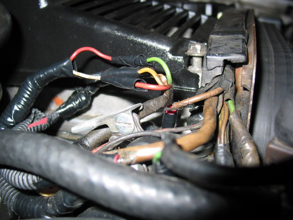

Pictures are taken.... I took pictures of areas of interest. I removed the CPS thingy and tried to scrape the metal to get better contact but it didnt do anything. here are the pics

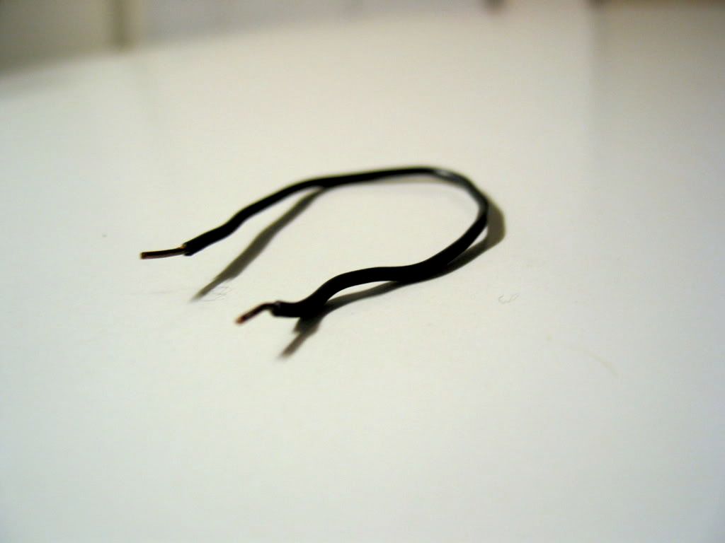

That paper clip you're using looks too big. Don't you have a smaller paper clip? I hope you didn't bend the terminals too badly. I use a piece of solid core wire, and it makes it much easier...hold on, I'll go get a pic of it.

PimpiNJ253 said:
Well I tried with a smaller wire this time and it was uneventful. I may need someone to come out and look at it or if i Do get it started i will get whatever needs to be fixed and possibly get rid of it :(
The Supra is testing you. And if you can't handle checking codes, then you should get rid of it.
