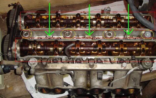

If you have oil in the plug galley, and your valve cover gaskets aren't leaking; your most likely culprit is the 3rd cover (or spark plug galley) gasket. Yes, that strip of metal that covers up the spark plug galley is a gasket. I believe a new cover gasket from Toyota is around $35.
Another option to fix this leak, is to remove the gasket completely; and seal up the oil passages under the 14mm hex plugs with oil drain washers. This fix will cost around $3, and leaves the spark plug galley open. Here's how to do this:
If you're removing the 3rd cover gasket completely, the four bolts (circled in yellow) that hold the 3rd cover on, seal oil passages and need a gasket to seal back up after the 3rd cover has been removed. I replaced mine with oil drain washers from NAPA. The NAPA part # is 704-1076. Just take off the cover, put washers around the bottom of the hex plugs to seal them up; and reinstall the hex plugs. You're done. No more leaks.
BTW, the three bolts at the bottom of the spark plug galley with arrows pointing to them seal the coolant passages, and should not be touched.

I don't want to reopen an old thread however I think it would be beneficial to the community so please don't ban me mods. I did get a chance to do the plug gallery gaskets (the napa ones) and it worked pretty well. This was on my previous supra. Thanks!
