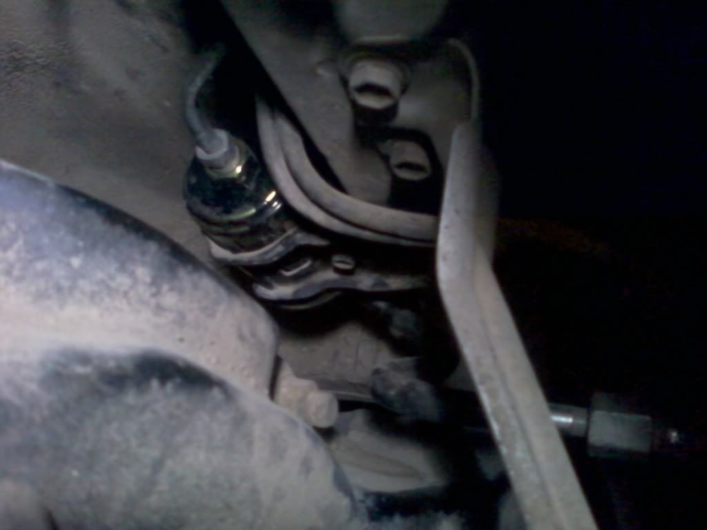

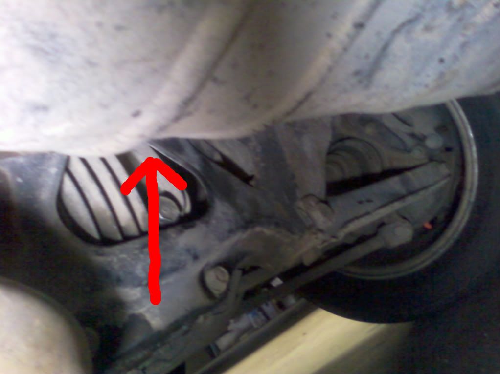

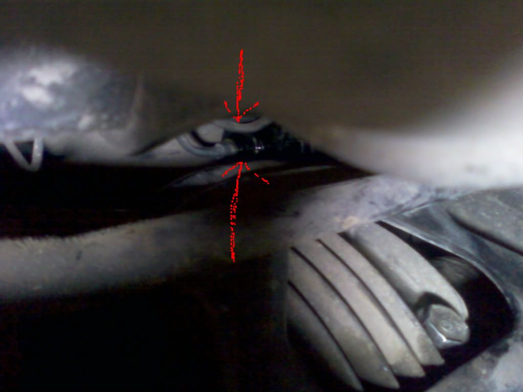

Here are the Fuel Filter Location Pictures.
In Between the differential & gas tank

thanks for the pics, greatly appreciated. how much fuel came out when you did yours, just so i can get an idea, and is there any particular way to install it or do you just bolt in on and fire it up.
