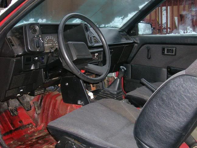

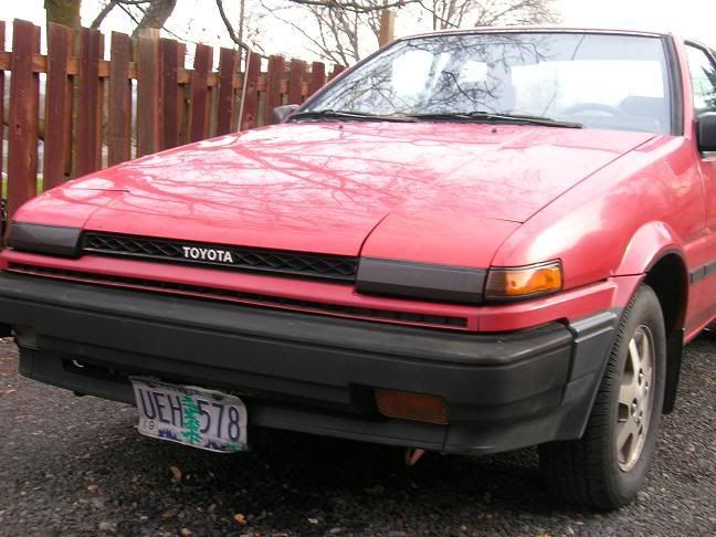

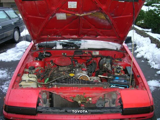

Heres the car by the way

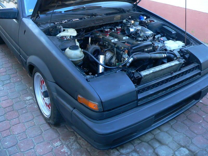

Just Imagine the 7M-GTE in there lol
I might sell it though; anyone want it for $1000

The car is an AE86 and yes its an SR5, so its not a "True" AE86...LOL.
Converting an SR5 to a GTS is a pain in the ass, cause you have to track down hard to get parts, that no one wants to get rid of:cry:. Its better just to start with a GTS for any twincam swap. The reason for buying this car is because I want to do the 7M project, not a 4ac to twincam (And yes the 7M fits). I dont have to track down those GTS parts with this swap. Although it has a GTS LSD rearend, brakes, ect. (not installed). Then I would need the hard lines for the brakes (which I'm trying to get). I didn't want to destroy a GTS, so I will start with a SR5. I want to buy a GTS later, then build with a 4age or a 3sgte. For now I need to finish my Nissan Hardbody project before anything.

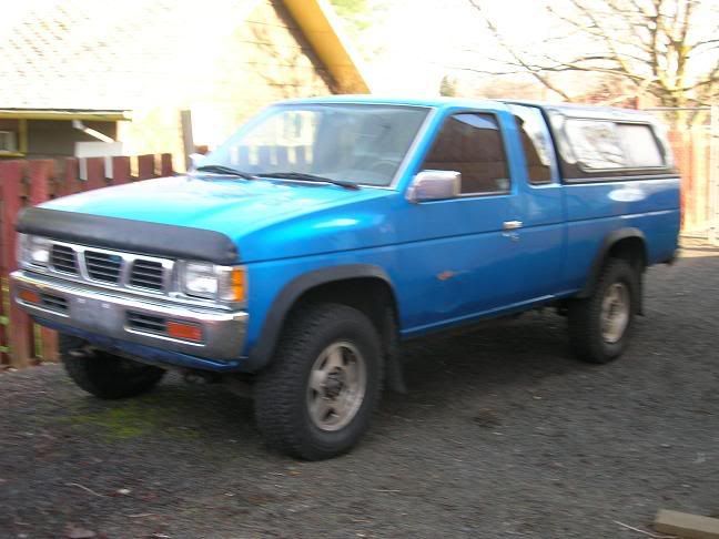

Im swaping a ka24e into it cause the previous owner locked up the water pump, threw the fan into the radiator, and lost compression in the motor:nono:. He left the car here in Oregon and needed it outta the dealership. So after some negotiating I got the title. Lets say I got it for less then an antenna from the dealership:icon_bigg.

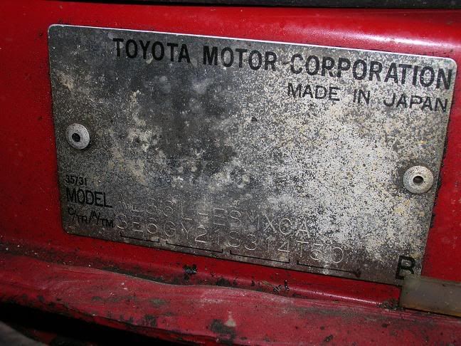

The Corolla started out RWD and Yes "soundwave2000" is right, Toyota produced RWD Corollas from 66-87, although in 83 Toyota produced a front drive Corolla "E82" (US market). The AE86 Corolla SR5/GTS was produced from 83-87. "AE86L" no such thing, although it is on my vin, but my car is a coupe though.
A=the engine type, E=Corolla body, 8=eighth generation, 6=trim level
