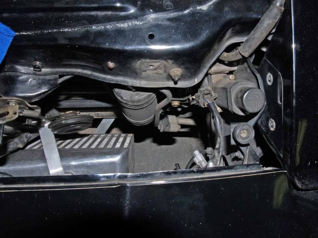

Here is the future home of an upgraded oil cooler. The old one is out of the way and will be boxed up and stored. The new cooler should be here by the end of next week.

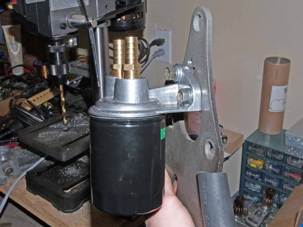

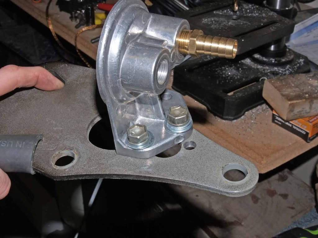

I then searched for a good spot for the new oil filter location. I chose to put it under the passenger headlight. The Tow Hook was thick enough to tap so....I drilled and tapped for an M10x1.25. It worked out great!

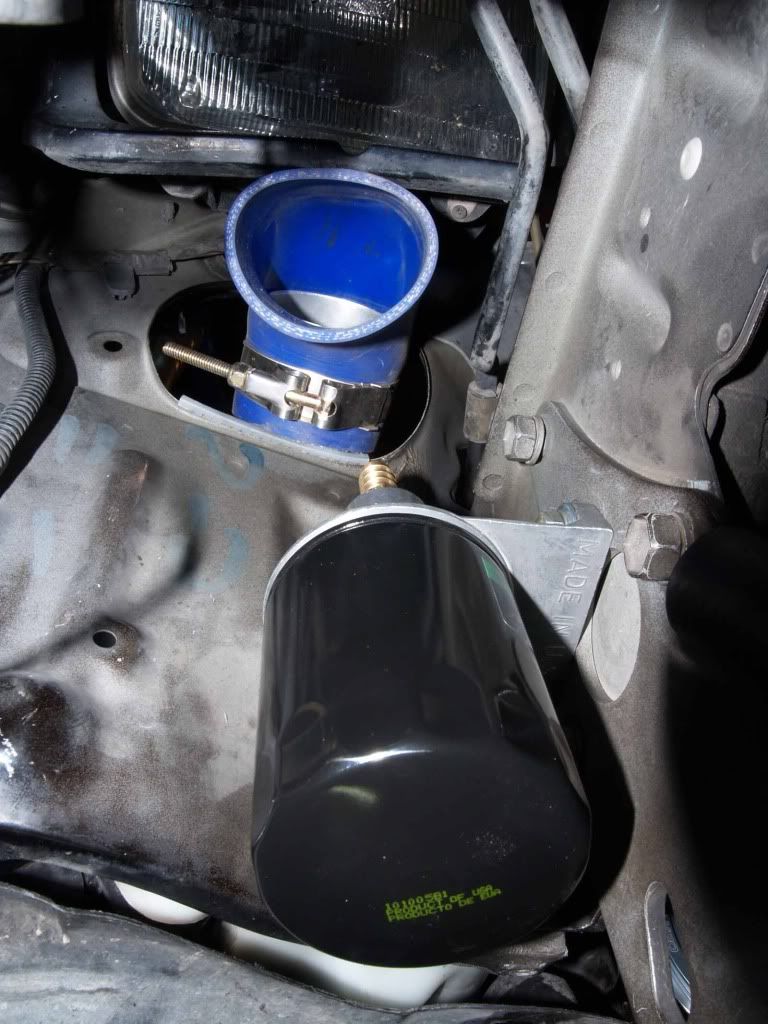

Time for a test fit. I left the NPT straight hose barbs on there to gauge for room. I will likely end up using some 45* fittings up there.

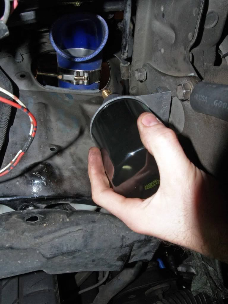

Gauging for hand clearance...all looks good...

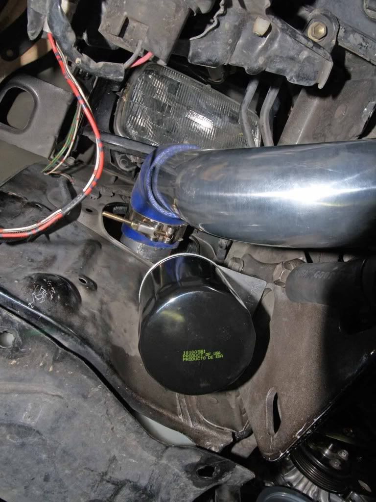

And here's the final fit. It looks good with lots of clearance in all directions. I'm liking it!

Oh yeah. They're there. I was thinking of fabbing up a trap door of sorts to access the filter.
