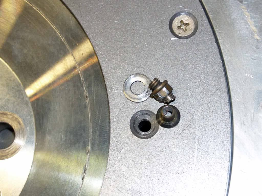

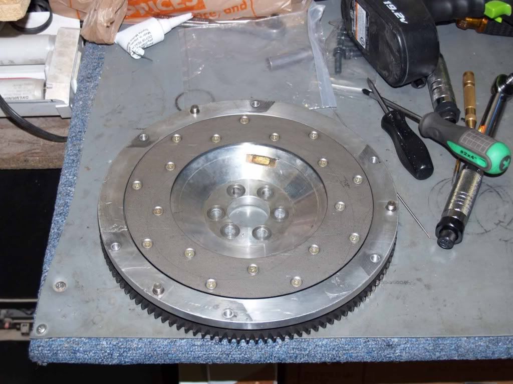

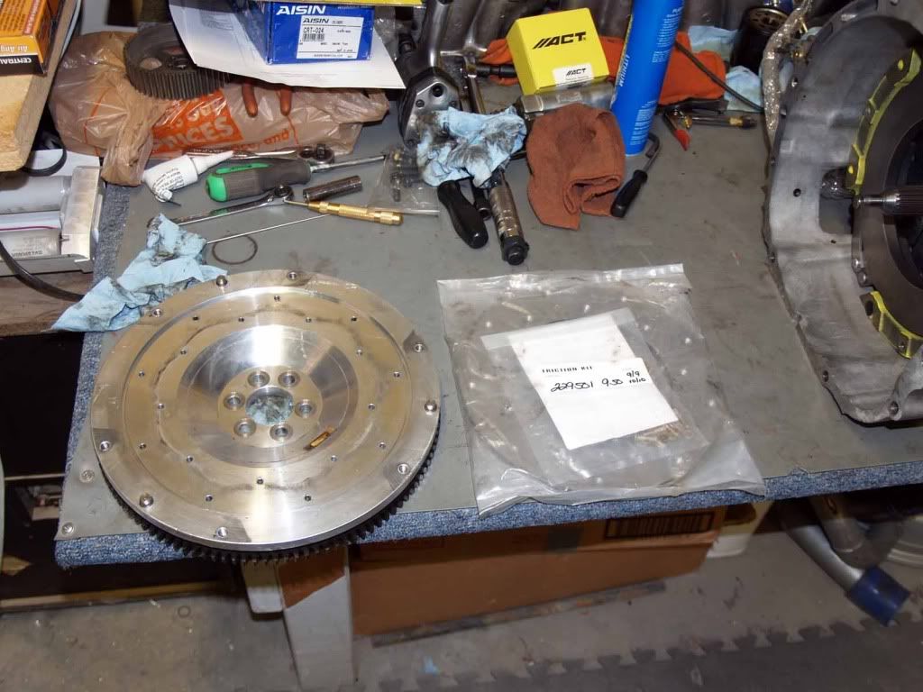

I decided to install the new insert on to the flywheel.
I had a mishap when doing this. I'm not sure who to blame it on. Aaron at Fidanza for possibly giving me the wrong information, my torque wrench for being out of spec, or me!
What happened was as I was torquing them to the 70 inlbs Aaron said to torque them to, one of the screws decided to strip at around 60 inlbs. I was then left with no choice but to attempt drilling out the screw and not damage the insert.
It was a rough road; but, was able to do just that. Here's the pics...
Good job on the fix, that can be a gut wrenching feeling when that happens!
Maybe it was just a defective screw, especially since the others went in @ 70 lbs. alright. Better to have it come apart then rather than when under a load.

Yeah, it was a pretty nerve racking thing to have happen. A drill press and nitride bits came to the rescue! :)

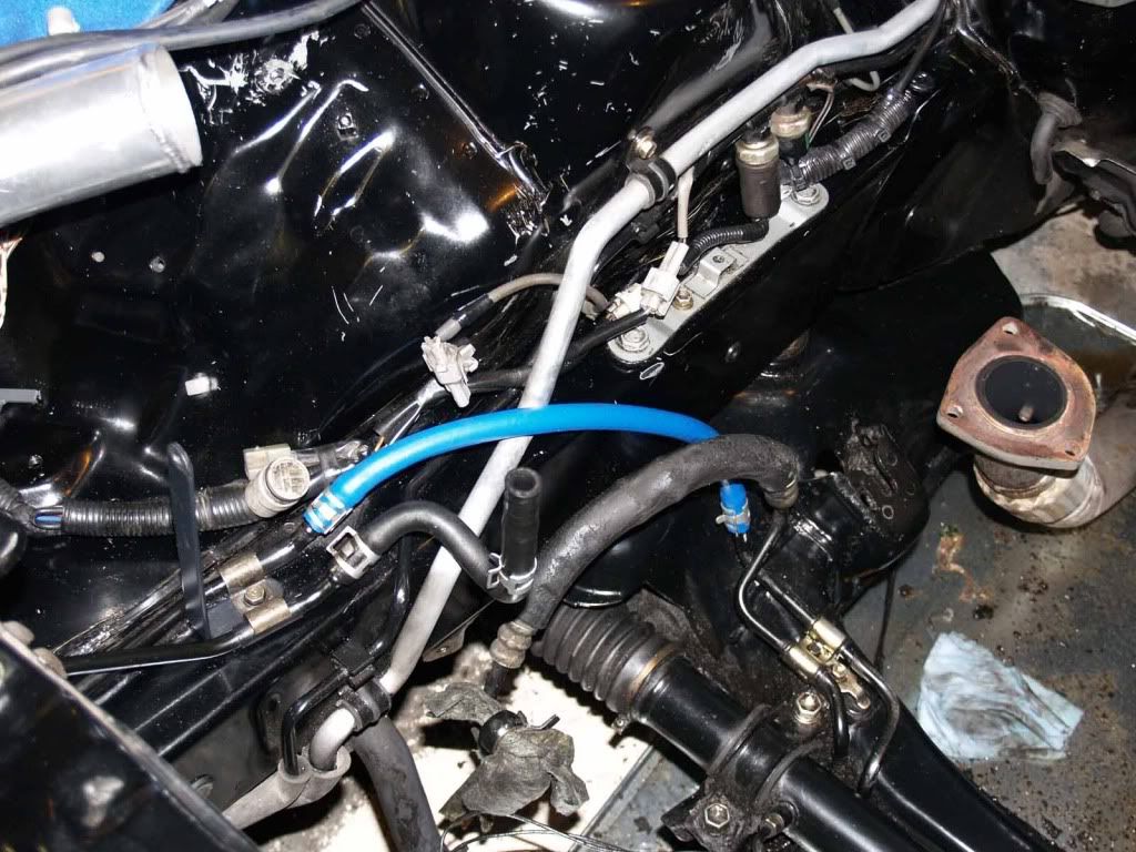

Still a little under the weather; but, I had strength enough to install some Gates Push Lock Hose. :)

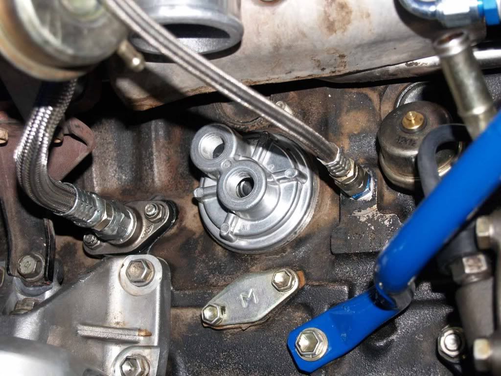

After Jdub's advice, I decided to go with a full flow oil system. I removed the stock oil filter housing and mounted the Permacool Relocation Flange on to the block and ordered an Oil Thermostat from Summit.
After that, I'll go to a local shop that makes custom SS hoses and have some made up.
This is a great idea Kenny. I want to do this too, but it may have to wait. I think I remember seeing Jdub mentioning something about not using the ss hoses. Not sure. Try and find the quote for you.

I'll double check on the SS hose thing. Thanks for looking out! :)
That Gates Push Lock Hose is amazing! I bought a ton of it from DM. Aaron told me that it's really good across the board for pressure and different types of oils. PS Fluid, Oil, and Transmission Fluid all holding up to 200 psi.

No problem. Here is the quote from jdub:
jdub;1490161 said:
Personally, I would not use stainless...too much risk of abrasion damage to the routed areas and it conducts electricity (great way to create a short). Summit sells AN push lock hose...much easier to attach fittings and can easily handle oil heat/pressure...Aeroquip push lock hose if excellent as well. As far as length, either measure to where you plan on putting the cooler (+ 20%) or buy a roll (what I did).
Link
I agree about the Gates push lock looking great. And you know it's not gonna fly off! ;)

Thanks for the info! Those are good points. While I'm not too worried about an electrical short, the abrasion aspect is something to consider. It would certainly be easier because of all the Gates Push Lock I have. Hmm... :)

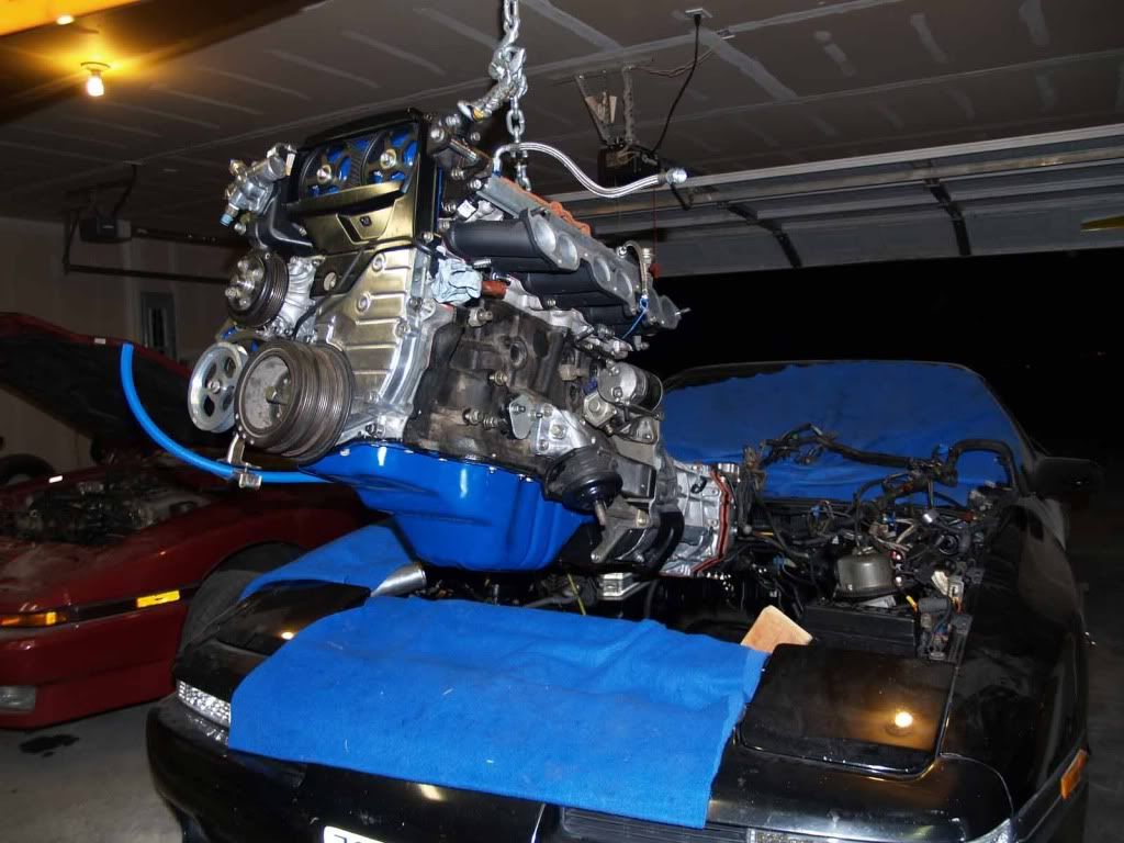

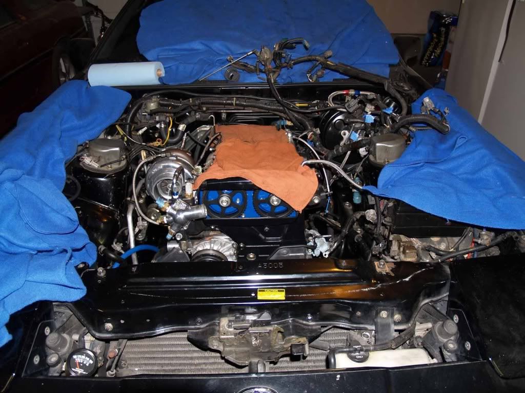

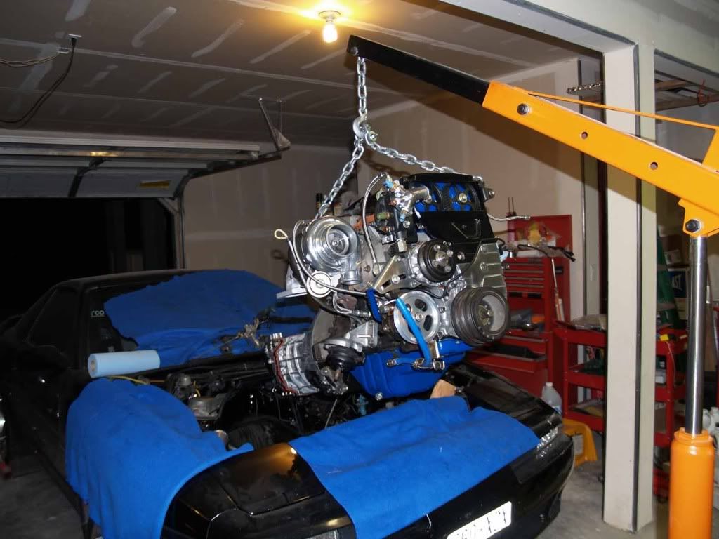

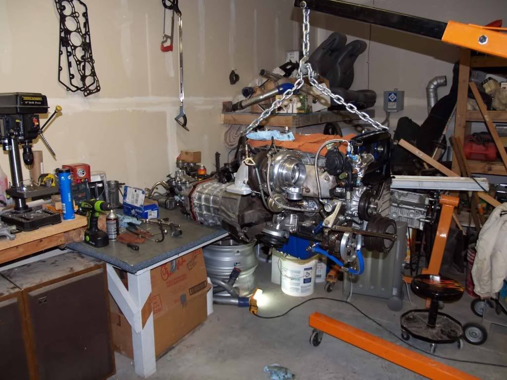

And more progress today! The flywheel got mounted, the starter installed, a new slave cylinder installed, and the transmission attached to the block. We were working too fast to get pics of all that... :)
And then she went up in the air and over to the car.
Then my buddy snapped this picture as I was crawling out from aligning and mounting the transmission.
And after much help from two of my buddies.......she's back in her rightful place! :D

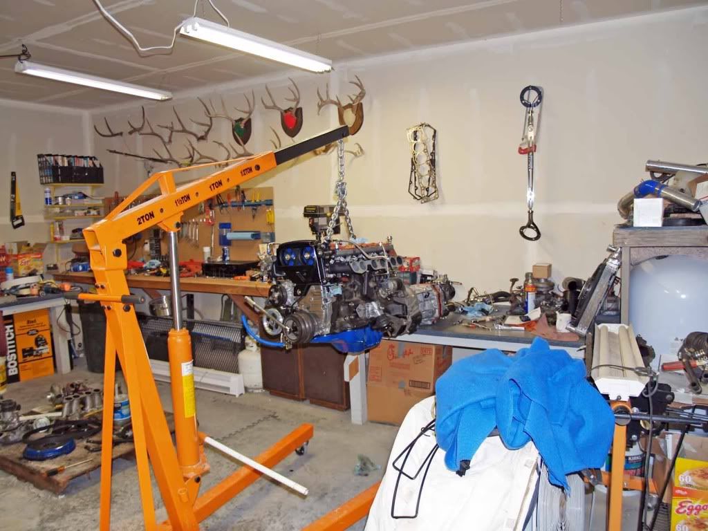

So close Kenny. Plan to get it started this weekend?
I'm so jealous of how much space you have in your garage.
