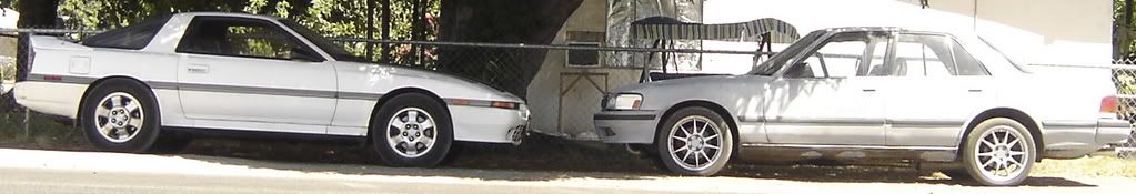

So I lowered the bitch 1½" in the front and 2¾" in the rear by cutting the springs shorter. I know you guys are probably saying.. EWWW!! but right now i'm concentrating more on spending my money in finishing 2 Cressidas and 1 Supra then start investing in suspension stuff :)
Certainly looks way friggin better than this:
See?!
