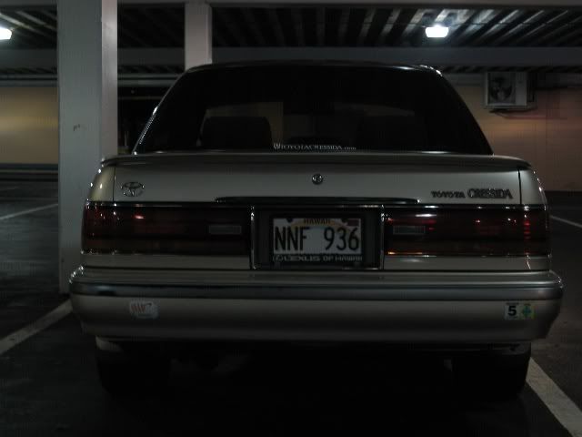

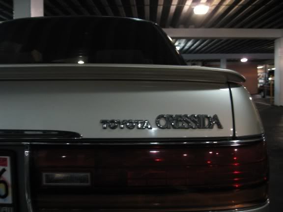

Updates. Member requested some closeups of the pistons: Rock Pistons btw
Some better pix of the emblem install. Brian also told me that the flap-less Cressida is hotter so I removed them just for him ;)
Most likely, next week it should be in the booth for a paintjob. After that, suspension mods, lower it to make the flap-less look alot cleaner. Then tint the head lights, side markers, tailights, windows, spray the whole interior with line-X, install my new interior with the Supra Seats and its a real car :)

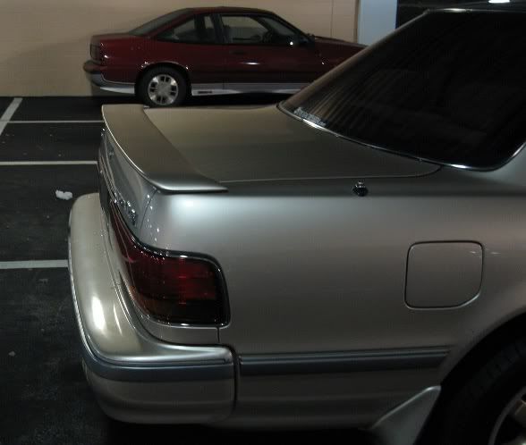

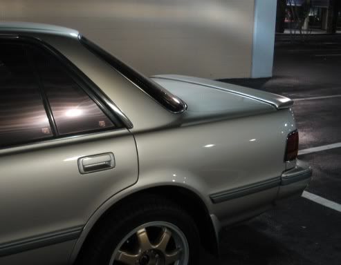

Heres another mod im working on... Again.. Except this time im finishing it.
And heres the pic of the 87 Cressida lip on my 91. Old picture btw
