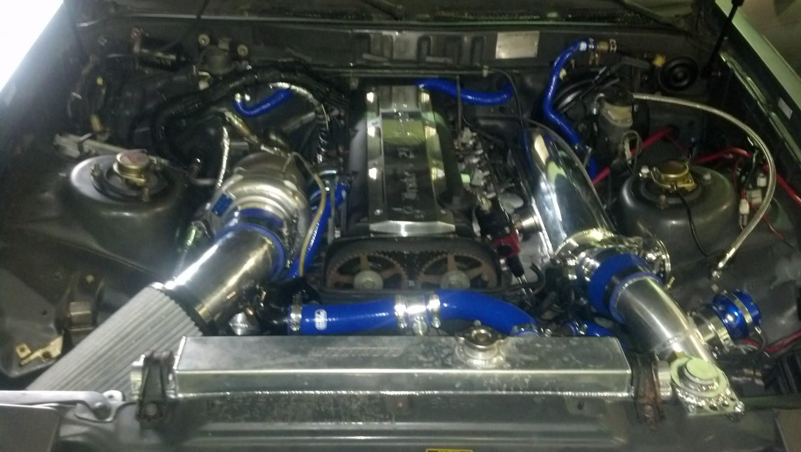

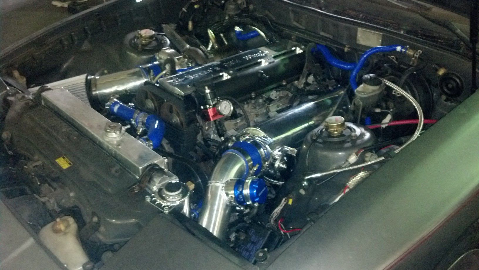

My 2JZ....
This STARTED at $5k, and that was without extra electronics purchased like AFPR, SAFC Neo, Zeitronix LCD package, and AEM TruBoost. Factor in Walbro 400, Mishi IC, custom piping everywhere, replacement silicon hoses, and other custom parts, and we are cresting $7.5k.

Agreed. It's been over a year now, nearly a year and a half (thanks to an individual that screwed with me on my wiring harness who shall remain nameless here), that my car has been down since I pulled the trigger on this build. A custom balanced 1-piece driveshaft and proper tune are all that stands in my way of completing this beast. And I didn't even account for the double-DIN radio/GPS which I got as a gift, nor the batt relocation in the trunk.
It's definitely been an adventure.

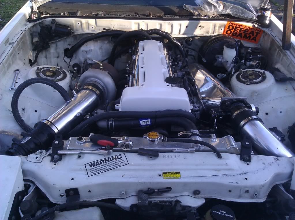

If I have to pick between them two.i go with a 7m just cuz its a 3.0
But I went with a 2jzgte
here another motvation picture

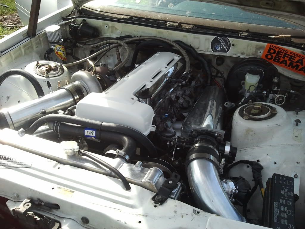

I just say take the 1JZ out of options, most people that do 1jz swaps end up with a 2jz of sorts anyways..
1JZ ecu's suck, do a little searching. the only fix is Standalone or convert to a 2jz ecu
2.5liters can make power but why not have a 3.0L if you end up going 1.5jz you mine as well start with a 2jz from the start..
I've owned 3 MK3's
a super clean 92 teal with shadow gray (best condition one i had)
re-torqued arp headstuds new HG, lexus afm, 550's, 57 trim ct.. full exhaust I personally think the 7M sounded the best.
nothing but problems with the motor, pain to work on compared to a JZ and i was always worried it was gonna leave me stranded which it did several times..
BHG
owned a 1.5JZ mk3, loved it, had alot of problems with the 1jz ecu's car probably went through 4 or 5 of them until a friend bought the car and converted it to use a 2jzgte ecu..
now i own a 2jzgte mk3
