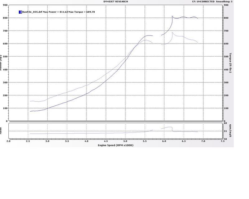

Here is the sheet :D
Bolts are basically in half but I don't have a pic right now. I think we can get 820 ish out of it with a proper clutch on boost np.

BIGAARON: Yes the NHRA rules are there but they are not strict on all of them and some don't apply to us Supras.
I plan to use this clutch for now and then wait for the next one twin or triple CF. This will do for now so no nitrous pulls until then. I put 100 miles on the clutch today :) ARP's are 30 bucks so just buy them.

That is some funny stuff Bri :biglaugh: Any guess on how much I would get if it wasn't slipping?
