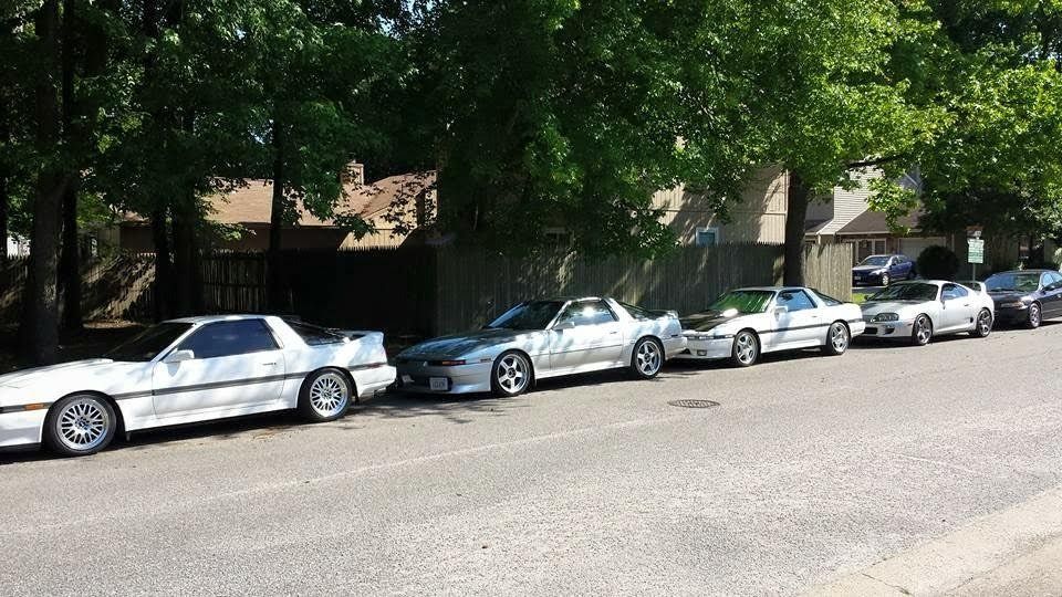

Got tagged at a local car show on a facebook supra page
While down in ocmd for cruise weekend
Took a ride to va for the weekend 4 hours to my buddy house then another 2 the next morning to a toyota scion show

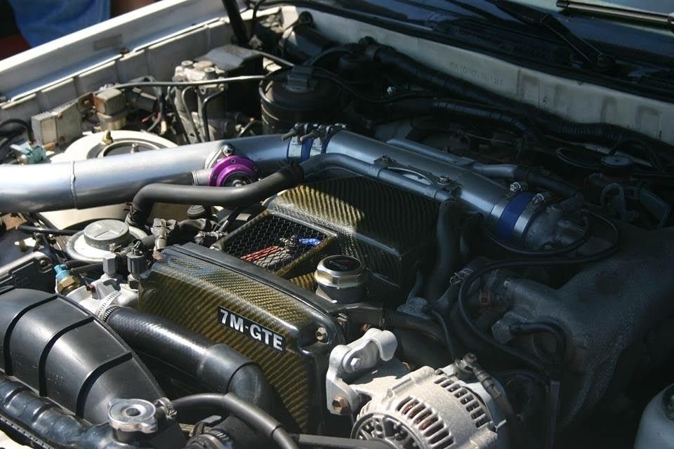

sweet pic of my engine bay

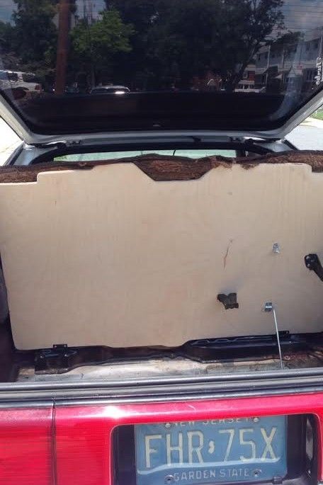

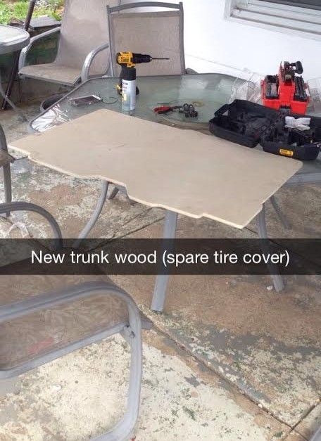

My two friends made these so I had to get my hands on one as my old one was pretty beat the new one is perfect

And well I didn't really do anything except provide my own lol so the hardware could be taken off and placed on the new one lol but since they had 1 or 2 extra I wanted in on one since as you can see my old one was beat after 25+ years ha and it had gotten wet over that time too as every mk3 supra has probably had a leak in the trunk at some point or another

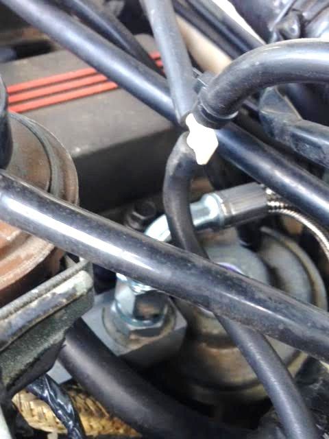

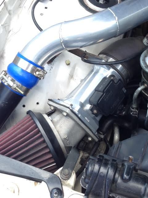

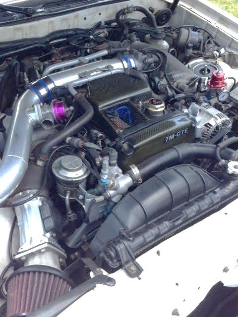

Ok so the fuel system and such has been upgraded and the car is feeling great boosting to 15/16 psi on the 57 trim ct26
550's and clips
walbro fuel pump
12v mod
lexus afm
safc
mk4 motor mounts
wideband stopped working and is now fixed
did a new clutch master and slave cylinder when getting the other issue fixed

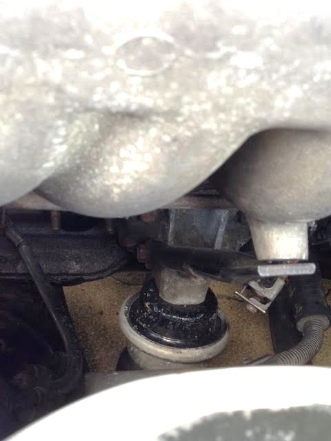

I like how he used another line than what I supplied from the dm kit this way it was more flexible and not over top of the alternator
Finished up at Gonzy Tuning over in Plainsfield, if anyone is in the northeast area I would recommend him my car was started on the night it came up and was only there a total of 7 days and I was able to drive it home with no issues about 85 miles

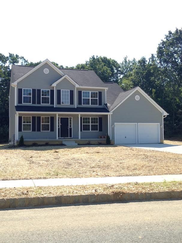

Also a big change on the house situation, I am no longer going with the condo but instead this

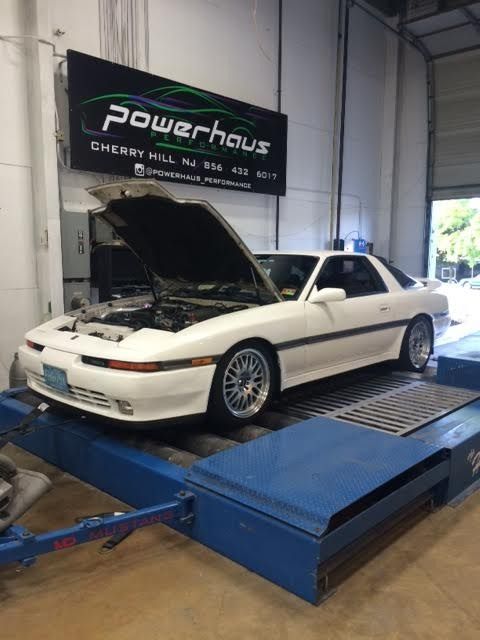

So yesterday morning I hit 250k miles on the way to work which was pretty cool I also had an appointment to do a pull or two on a dyno just to see where I was at after doing the fuel mods
I was first up after driving there and being stuck in traffic on the highway because some vw caught fire
I like what it put down and to me a completely realistic number being my car didn't have a chance to cool down or was cold from the start
put down 360 to the rear wheels and 380 torque at 16 psi and with a normal cat, on a mustang dyno
