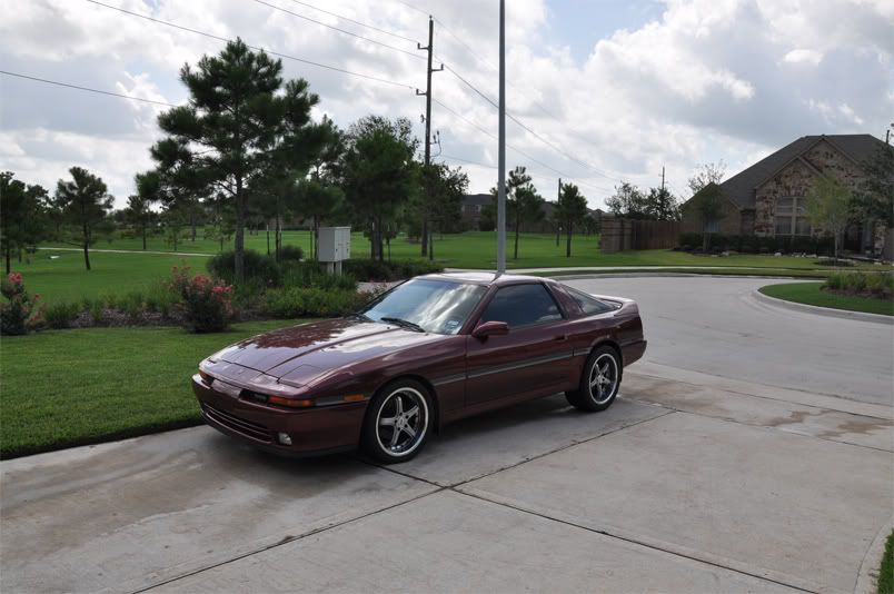

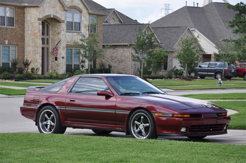

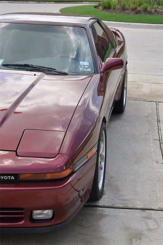

Lowered my supra today... Was fun, easy and had the perfect results that I was looking for from my setup. My setup of choice: Bilstein 3-way height adjustable shocks with stock 89+ springs!
Before:
After: Lowest Perch
Gonna order the rear set soon!

Very easy to install actually. To change the height would require removal of shock and compressing the spring to adjust the perch. Not something you'd wanna be doing a whole lot. I am impressed with them though. Now my front shocks are stiff! The rear is completely blown as you can push down on the body of the car and it bounces pretty easy. Can't wait to get my rear set so I can tell a true difference with the ride all around. I may add a sway bar or two after the shocks are done. Will just have to see :)
