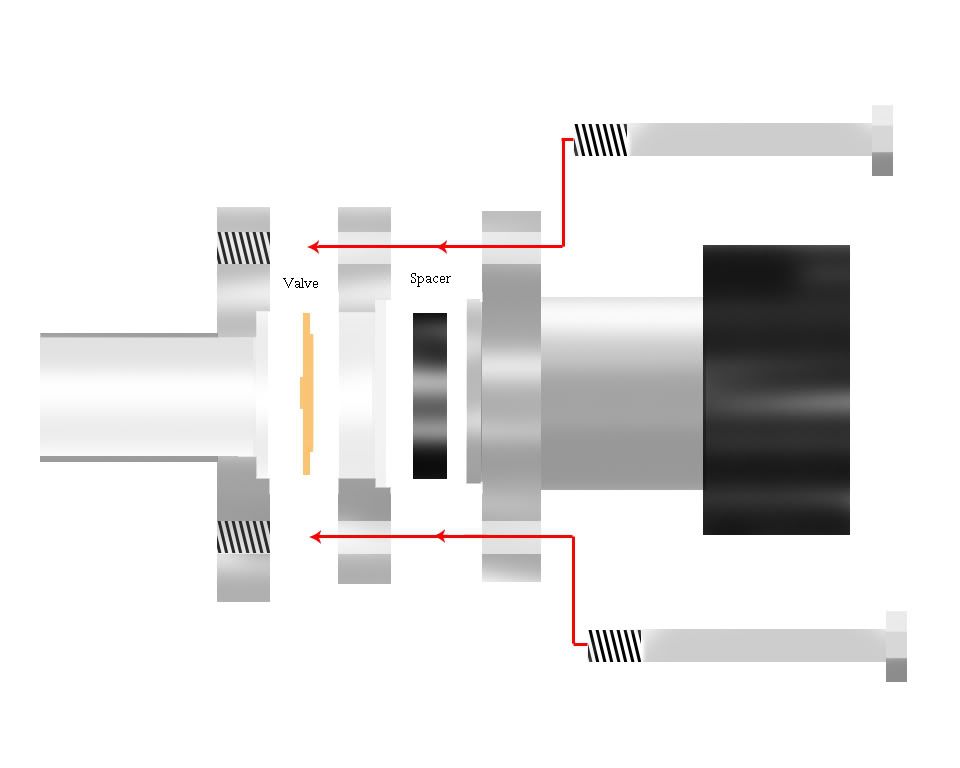

Ok, I tried to get a pic, but you couldn't see anything. So I drew up a diagram, I used 1/2" aluminum plate and some aluminum tube. I cut out the plates as seen in the pic, to fit the valve, spacer and so on. I welded the tube on and attached a hose to the tube and fed that to a similar plate made that fits on the bottom of my TB (engine side of throttle plate, TB already had provisions for a Ford ISC).

Cya said:
thanks for the pics!!!!
You're welcome!
supra90turbo said:
Those bolts are too long. Not to mention they're not full thread.
You've got an ISC leak Jimi! Check that out. ;)
I guess I should have put a disclaimer for retards (ie. Kurt) :icon_razz
Disclaimer:**Not to scale-exploded view**
