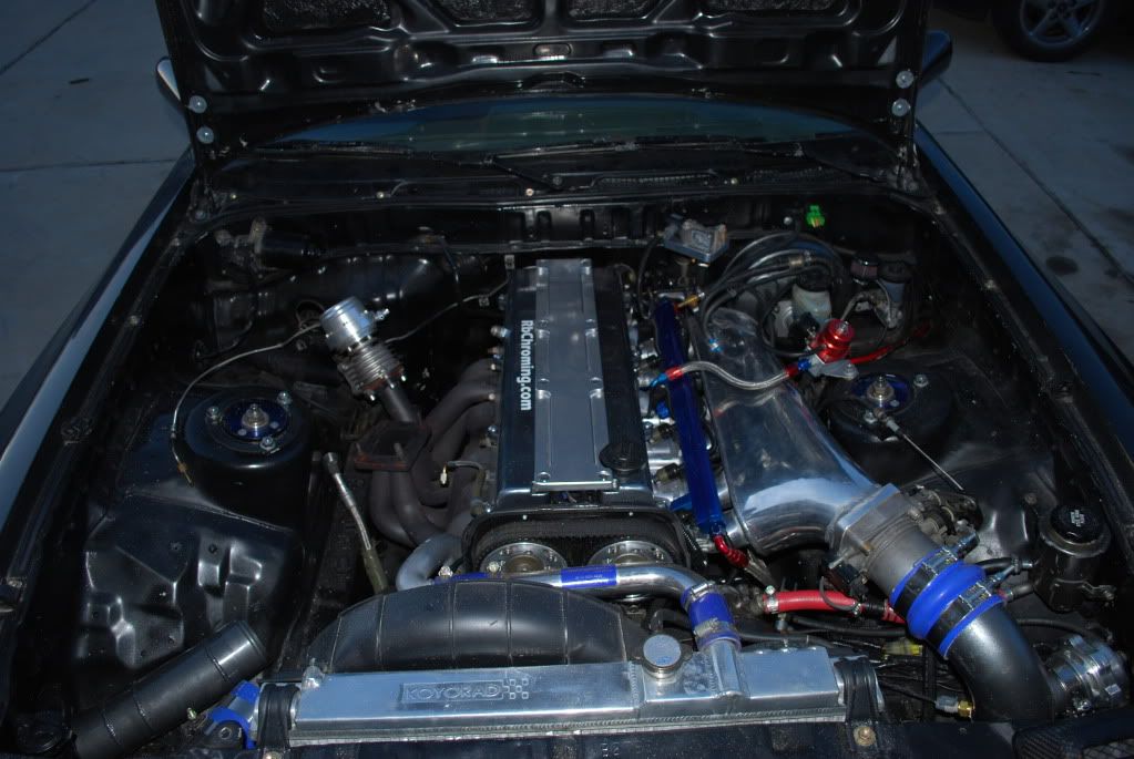

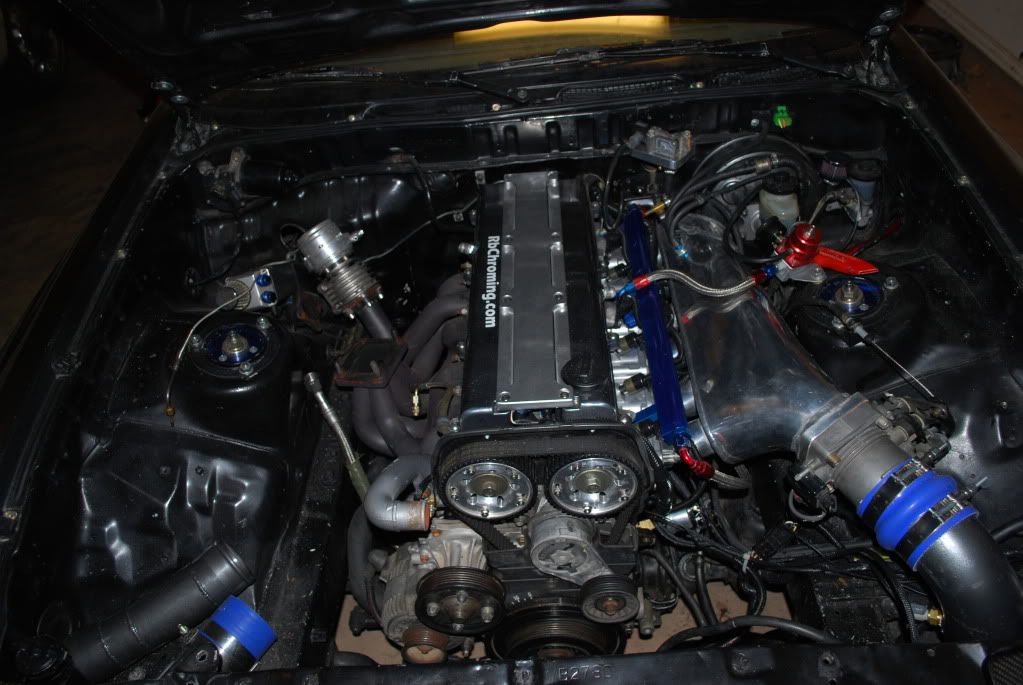

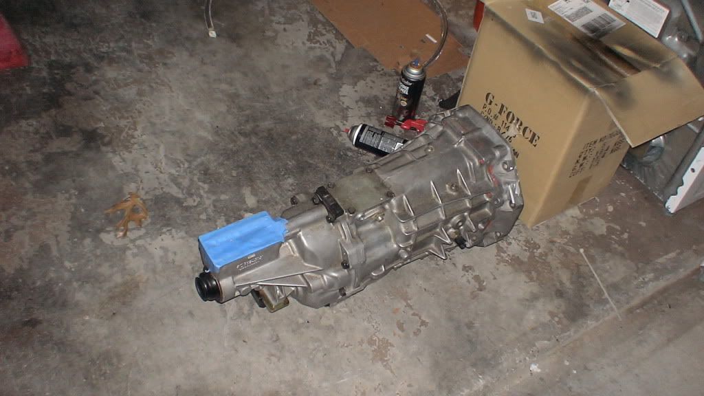

tested fitment to see if my coil pack cover would clear the coil packs and connectors and it just does by barely anything

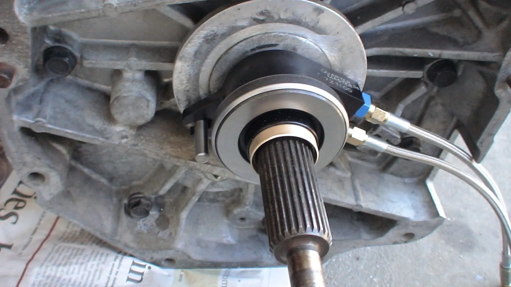

and heres the fully assembled T56 setup, need to have my machine shop make me a sleeve to center the quartermaster slave on the input shaft, wobbles around a little bit

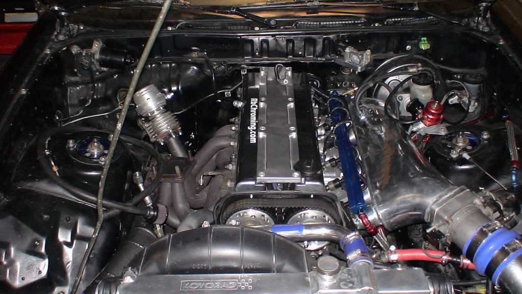

finally had some good weather today, nice and sunny, so some stuff came in and i got some work done.

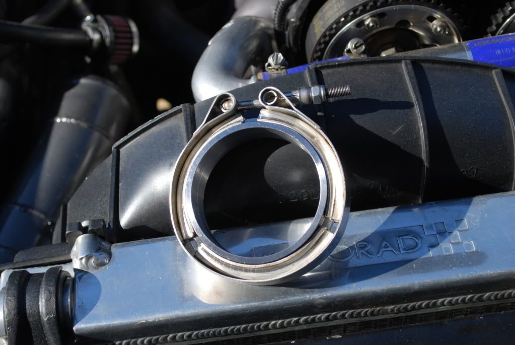

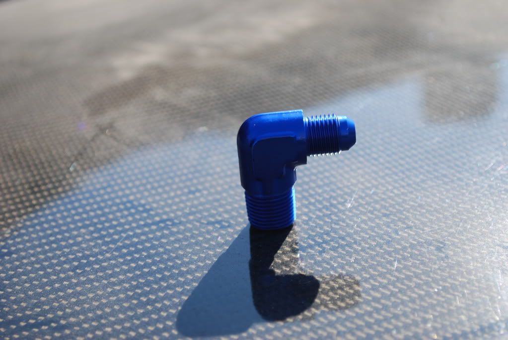

got the vband for the new turbo and the return fitting on the fuel rail

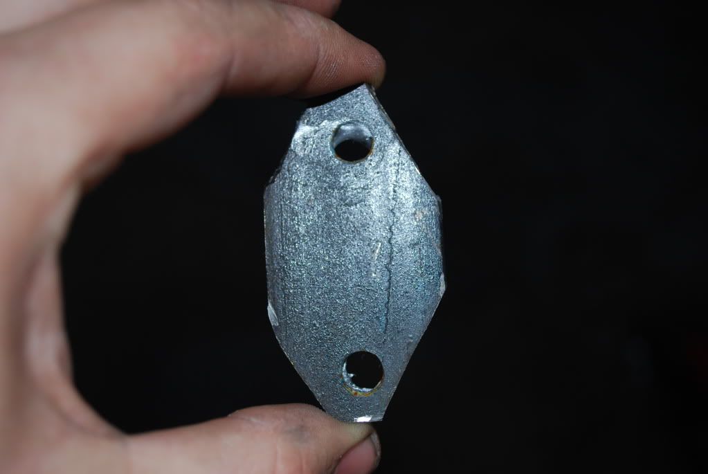

hacked off the T88 flange from the DP, just waiting on the turbo to mock up and finish the vband on it.
looks ugly, but itll do the job and not be seen, this deletes the hard line off the back of the water pump.

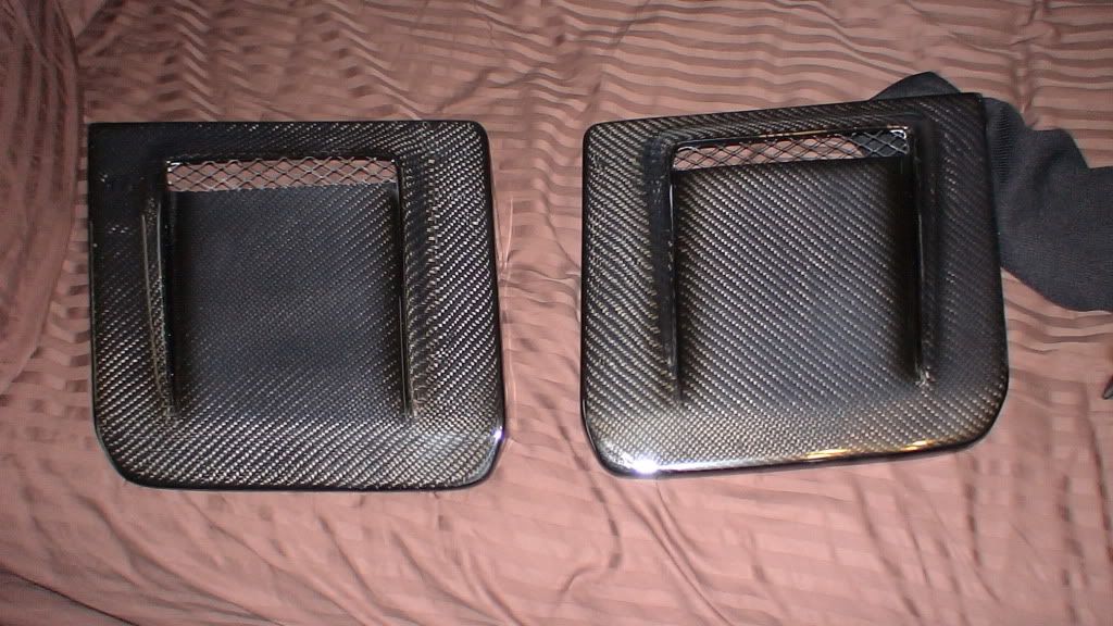

took a lil modifying, but i got the cf headlight covers on as well. also just realized my i/c is crooked, thatll be addressed tomorrow
and lastly, got the fuel rail done, bolted up, return line on, and the inlet line and filter done for the ISCV

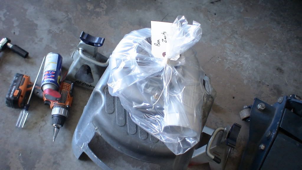

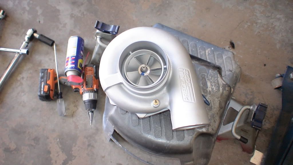

more updates, more parts
2 things from Aaron and DM

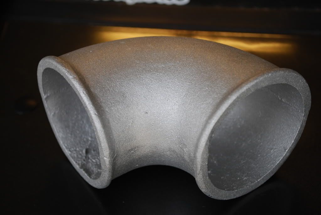

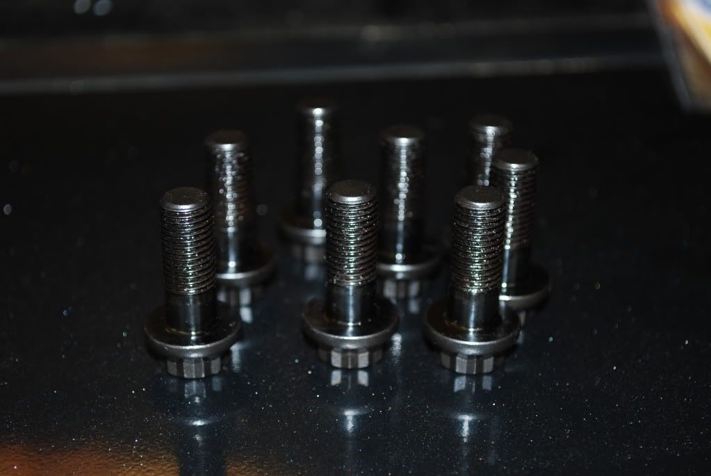

ARP FW bolts again (2nd set ive had, first went to the new owner of my OSG single plate) and a 3" elbow for the turbo

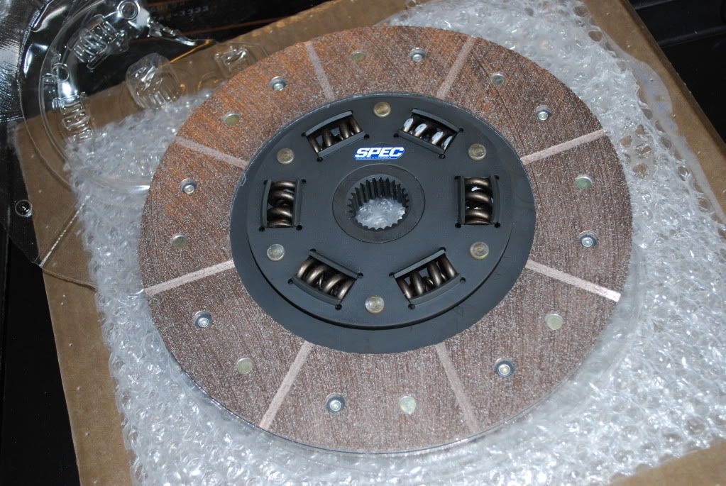

custom disk i ordered from Spec, i like their clutches more than centerforce. according to the tech i talked to, this disk with the CF PP should hold enough for now

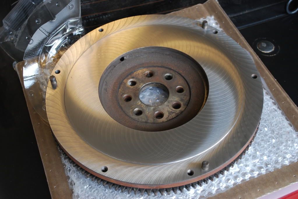

Resurfaced flywheel

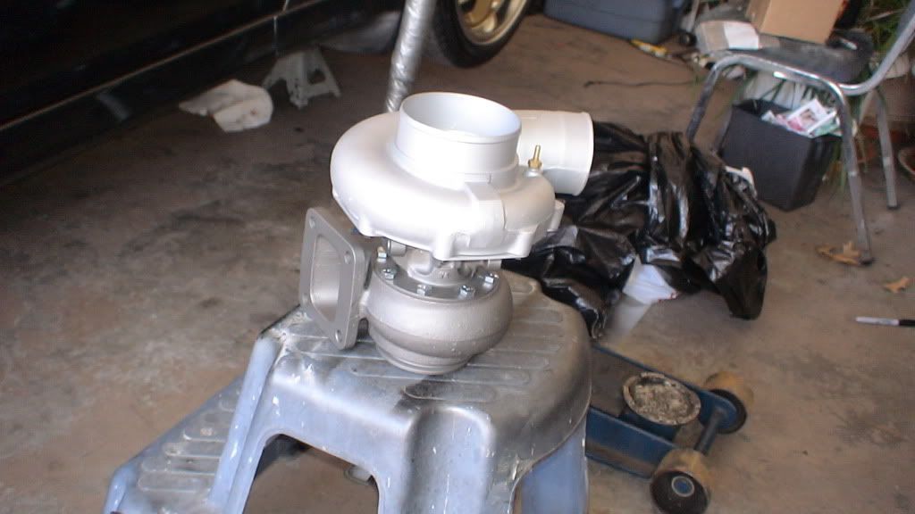

Big day for me, finally got the turbo back. Majestic Turbo does some damn good work!
already mounted on the engine, getting the elbow welded on tomorrow.

got the bronze sleeve to center the slave cylinder on the input shaft cover. also got the anti-spin stud put into the front plate of the trans

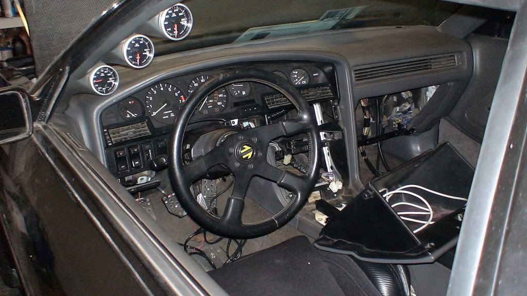

little bit of cleaning up in the interior. still a long way to go tho. need to make mounts to put the aem up on the firewall behind the glovebox.

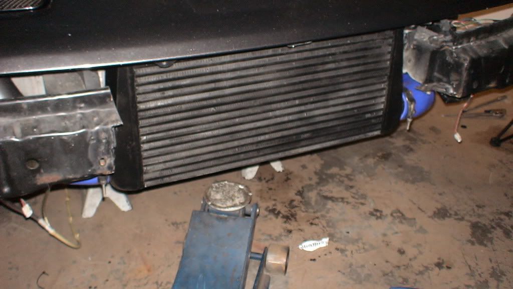

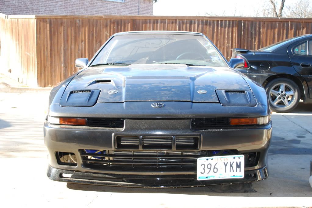

re-did the mounts for the front mount, and finished tightening up the piping. going to be doing a front bumper mod similar to Mobes (i already asked him and he said its cool with him) so now the intercooler is in the proper position for that. also put a coat of black paint on it. im de-badging the entire car, i dont want anything to really stand out anymore on it, no turbo stuff, not even the euro turns or bubble sides.

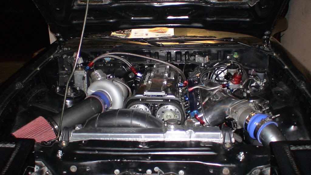

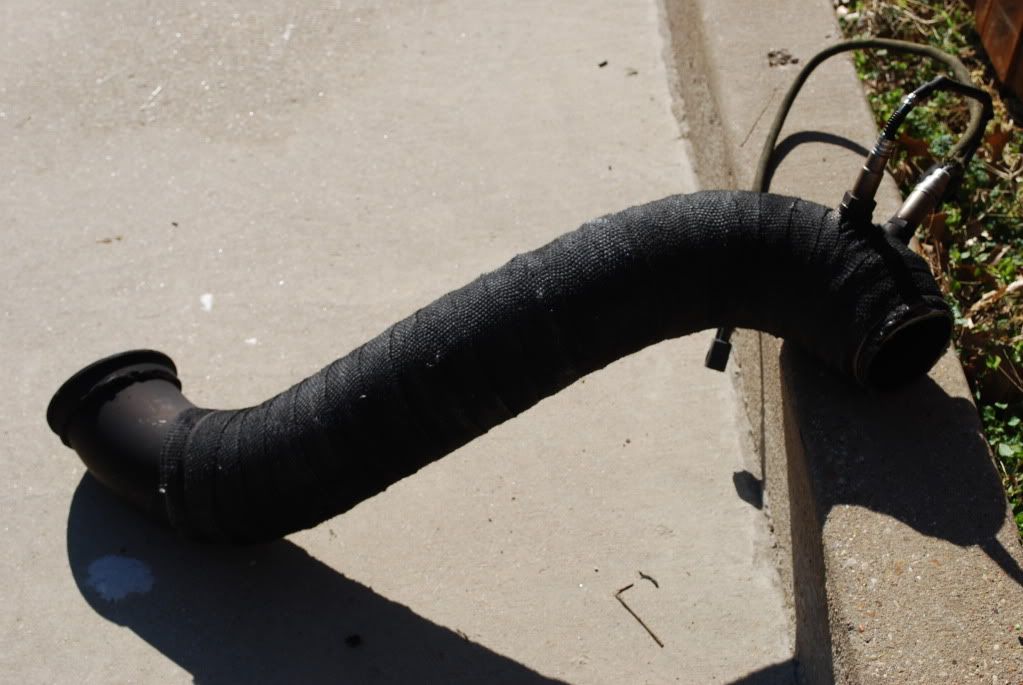

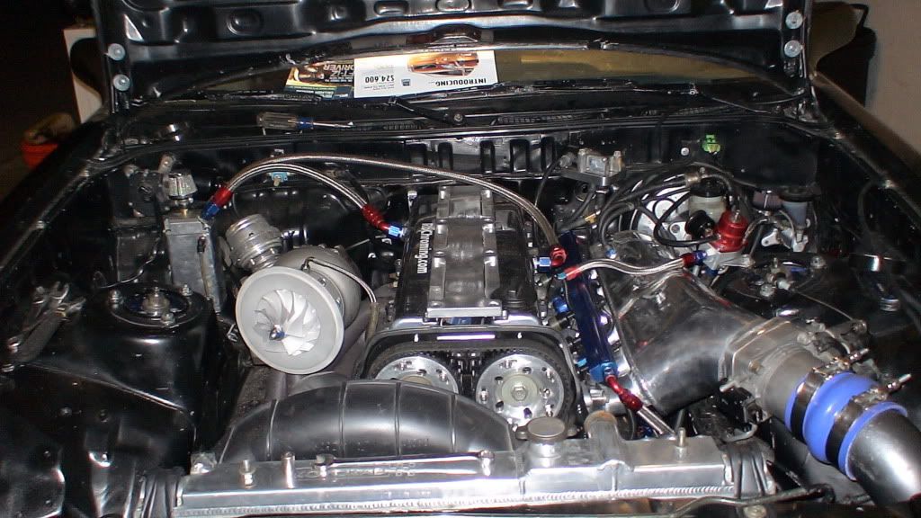

heres the engine with the 76GTS completely installed, all lines on and the piping connected, just need to modify the downpipe now, but i have to have the trans and main pipe on to do that

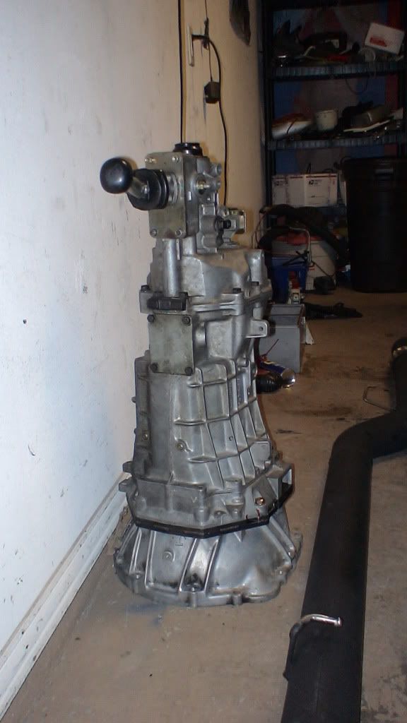

trans ready to go in for the shifter hole modding and all, had to knock off a couple ears that stuck out too much.

What is your bumper going to look like? I see you just cut the bumper in two spots and took that out, but doesn't that support the cover?
might still take clears, going to tint whatever set i get. and as for the bumper, the sides still have room for the studs on the very ends to hold it on, but there would be no room for the center part with the duct im going to do
