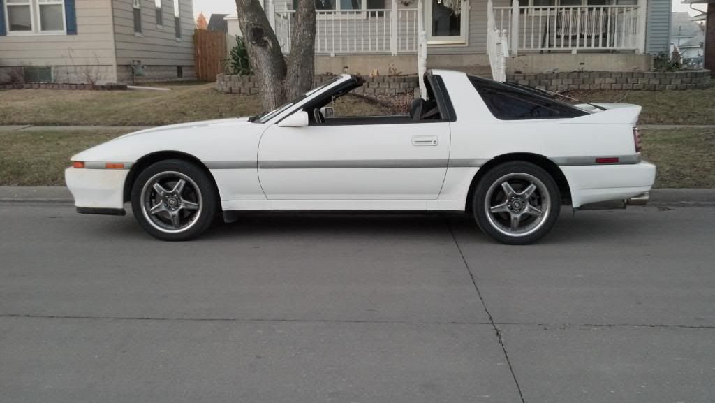

This is true. Before i started the project, i was assuming it was all stock untouched, and would be a simple fix. Now that its apart, i want to get it back together enough to drive it. I have a different car for my daily driver, so if it fails again, i can leave it sit until i have money saved. Id rather not sell the car because they are rare in this area. Ive only seen 3 supras in my life. 2 mkiii's (including mine) and a mkii. The other mk3 is sitting in a field. As of a few hours ago, im seriously considering asking if its for sale, so i can pull the head off, and see if the situation is any better. I dont really have the money to do that though. Btw. here is a picture of my supra:
Purchased 15 months ago with 90,000 miles, now has 100,000.

That car is gorgeous! If the pic represents the car properly, that car deserves a proper build. It's extremely rare where I live to see one like that. I found an oem 7mgte pre 89 shortblock (crate and no longer available). That's what I would be dumping into that if it was mine. :)
