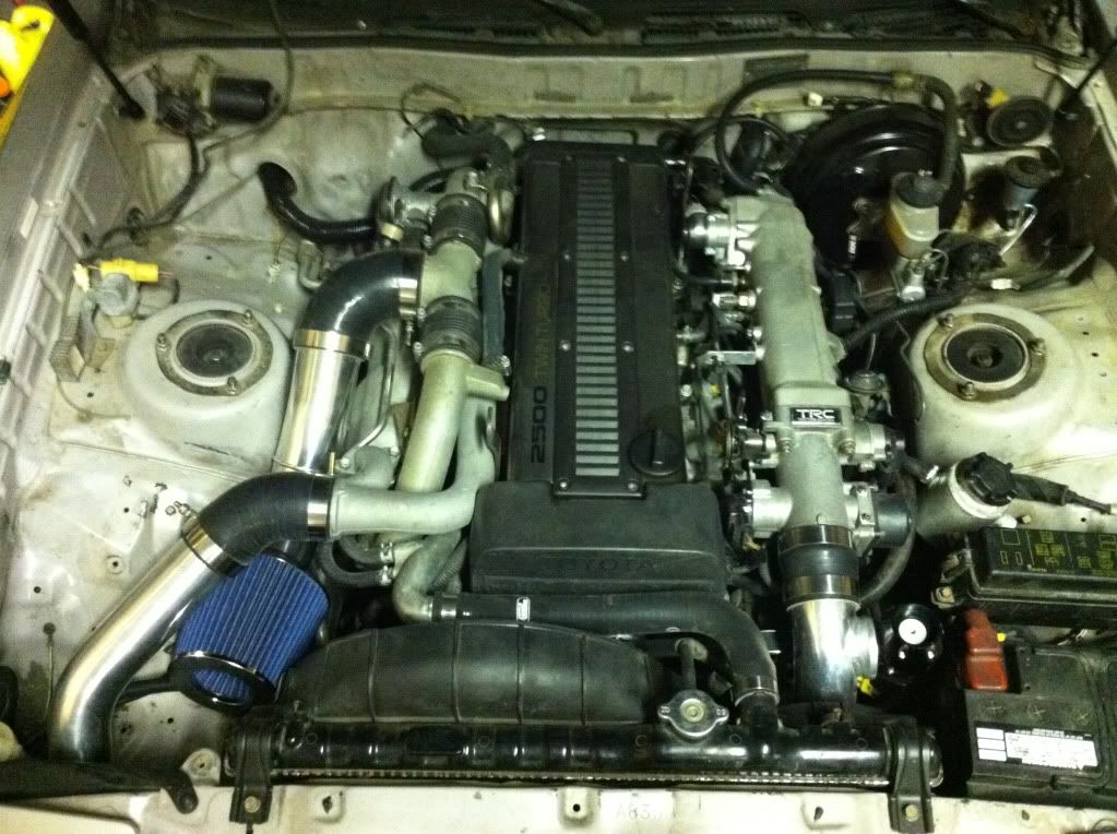

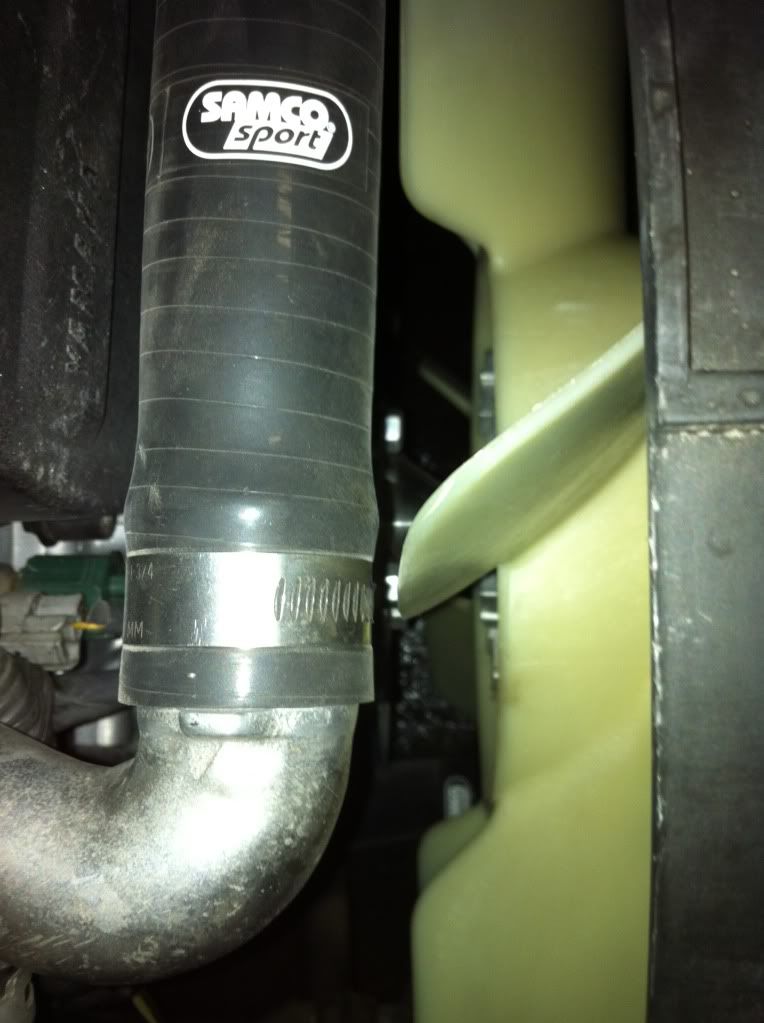

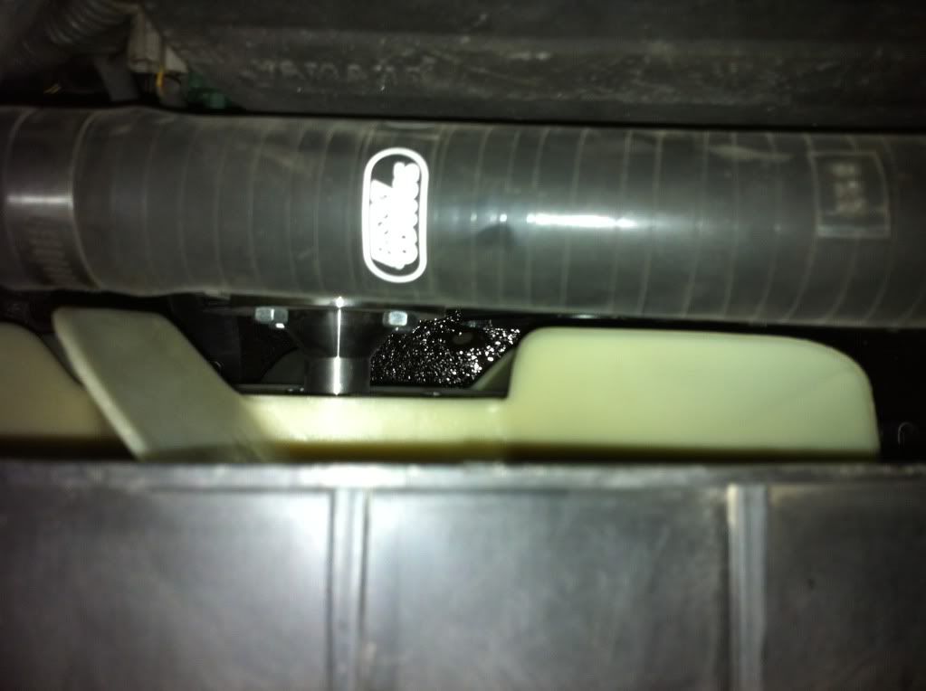

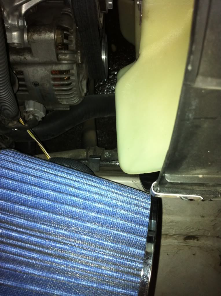

CRsupraiii;1941677 said:
MK4 TT Clutch and fan with stock koyo rad. Fits great, zero modification required!!
TT/NA clutches are the same part number. You do not have a TT fan in that picture otherwise you would not have any room for the shroud and TT's don't sit anywhere near that close to the waterneck.
