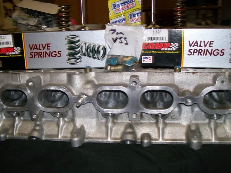

CS: BBC Comp cams springs but they're only singles.
See my pic on the previous page if I'd been running singles my motor would be scrap metal now :(
Redundancy is a good thing.

Mr: At sustained high rpm springs can run hot enough to glow so the very best metallurgy is required as well as extreme care in assembly as the slightest mark on a spring will become a failure point.
I had my Ferrea's Cryo treated for this build, I really wouldn't risk a single spring in this motor as a breakage like I posted with duals while an inconvenience isn't terminal.
Dropping a valve @ 8000rpm you might get away with saving the intake and cam covers the rest would be scrap :(
I think a set of new stock springs that have been shotpeened and then Cryo'd would hold up nicely for sustained 6K work, above this you really need to spend the $$$.
