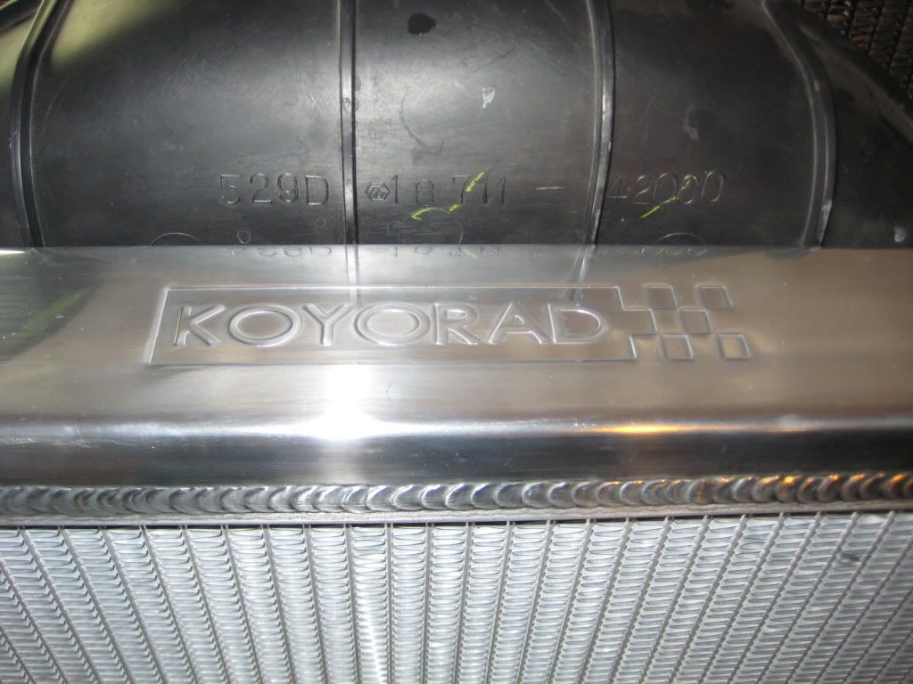

The Koyo may or may not touch the core support on it's outer edges on the sides. If it does, it needs to be insulated or it will ground out leading to erosion of the radiator. Also, the isolator mounts on the bottom need to be cut down.

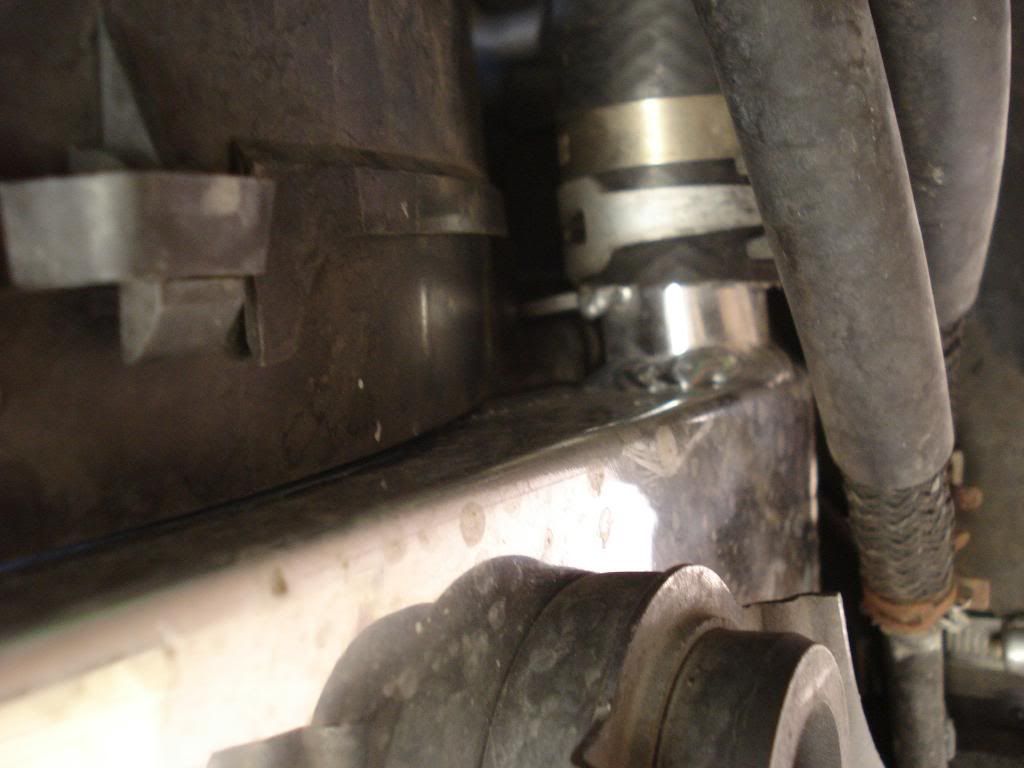

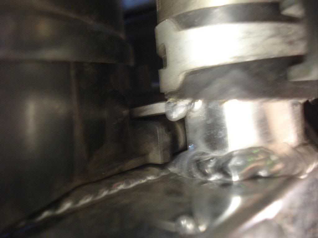

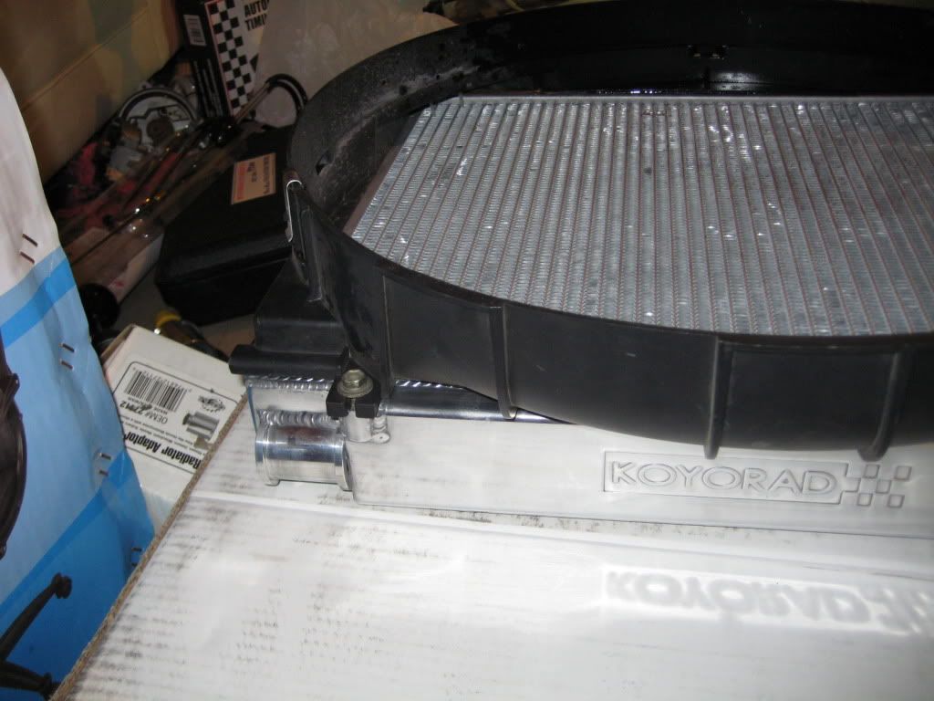

i installed a pwr rad a few weeks ago and had a similar issue w/ the fan shroud, but i figure out how to fix it, you basically take a dremel and drill out some of the plastic so that the aluminum piece can fit into the plastic tab (see red area in pic) and then the shroud fits nice and easy,

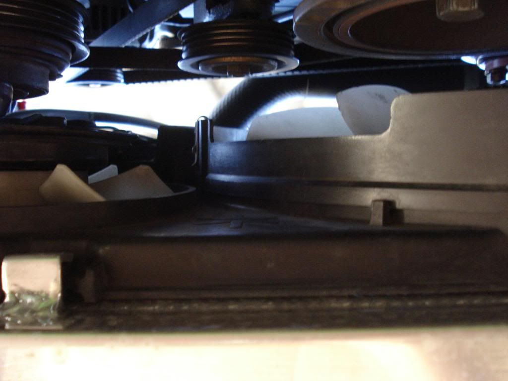

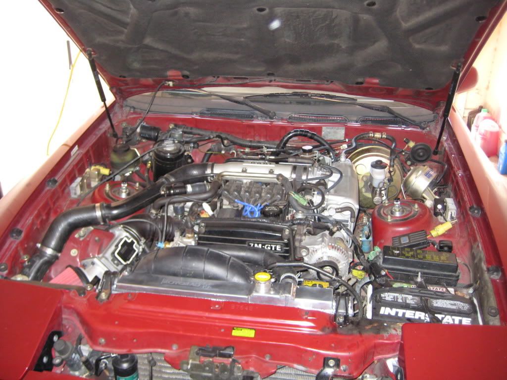

So in installed my radiator yesterday, heres some pics.
Pros-
-Good quality, very solid piece
-Cools good (haven't given it the test of AZ summer yet)
-Fits pretty well
-Works with stock fan/shroud
-Large
-Affordable
-Uses stock pre-89 cap
Cons-
-No lower shroud mounts
-No supplied block off for the 1jz temp sensor
-Stock electric fan lower mount non existent
-Mounts have to be shaved (Typical of any aluminum radiator)
Major issues were the lack of shroud mounts on the bottom and lack of lower electric fan mount, you have to fab up a bracket yourself. Also, you have to go out and buy a plug for the temp sensor (i used an old sensor i had laying around) which is 16mmx1.5
Biggest install pain was probably shaving the lower mounts without power tools, things are HARD!

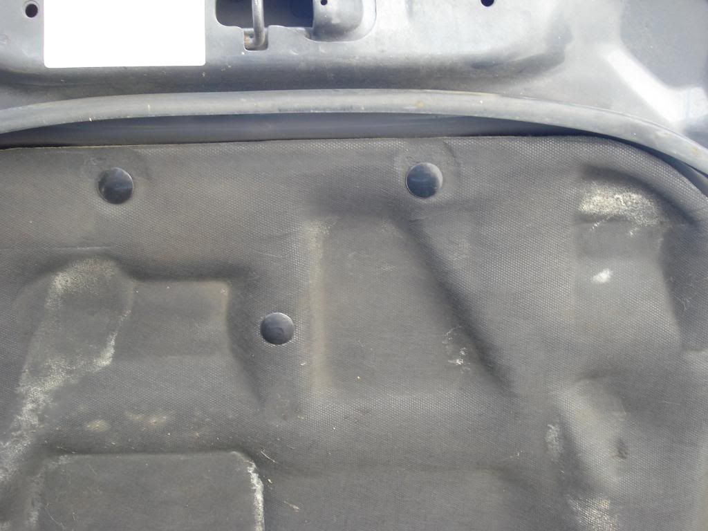

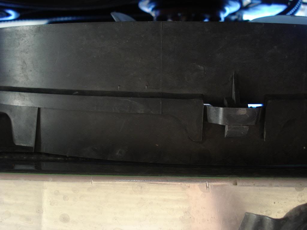

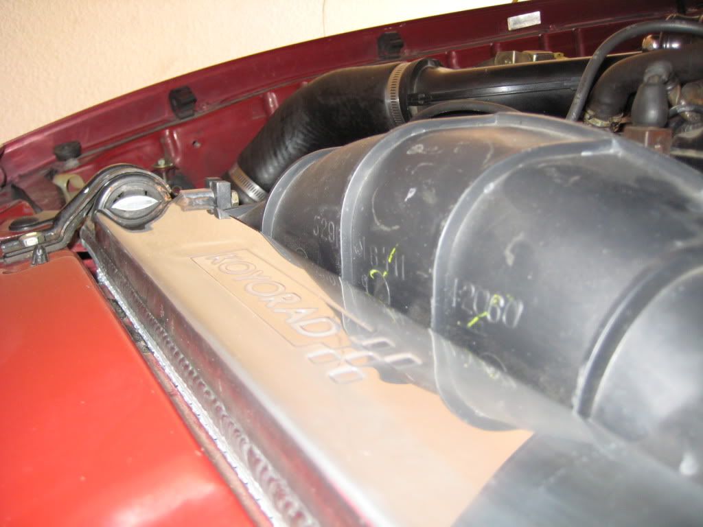

deabionni beat me to the pics of the Mishimoto. Oh well:
It barely touches the hood insulation. You can't even see an imprint, and I didn't shave the mounts:
I regret not doing more about the gaps between the shroud and the radiator, but I'll save that task for another day.

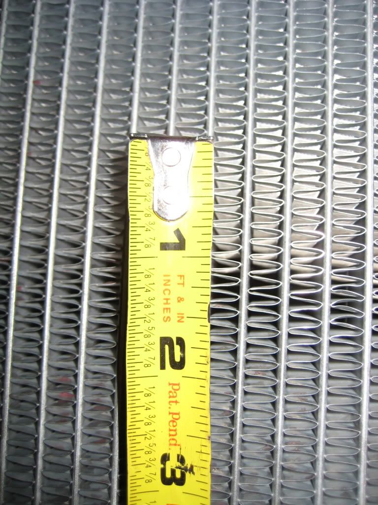

Thought the pwr needed a little picture representation.
Tapatalk iphone app only let's you upload one pic per post so I'll just show the rows(I can see my phone through the xerex reflection lol). As you can see it has a 2 row core with 2 very long rows, considering it has a thicker core than the 3 row koyo.

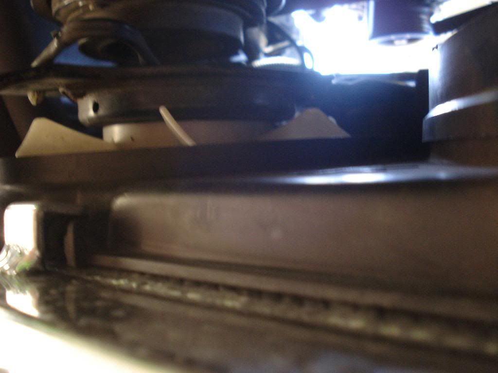

Moy;1575653 said:
How close do the stock fan blades sit to the radiator?
Not very much room but I've never had a problem. I can fit my hand in, palm against the radiator.
I'm not sure the exact amount but it's close to double from stock.
