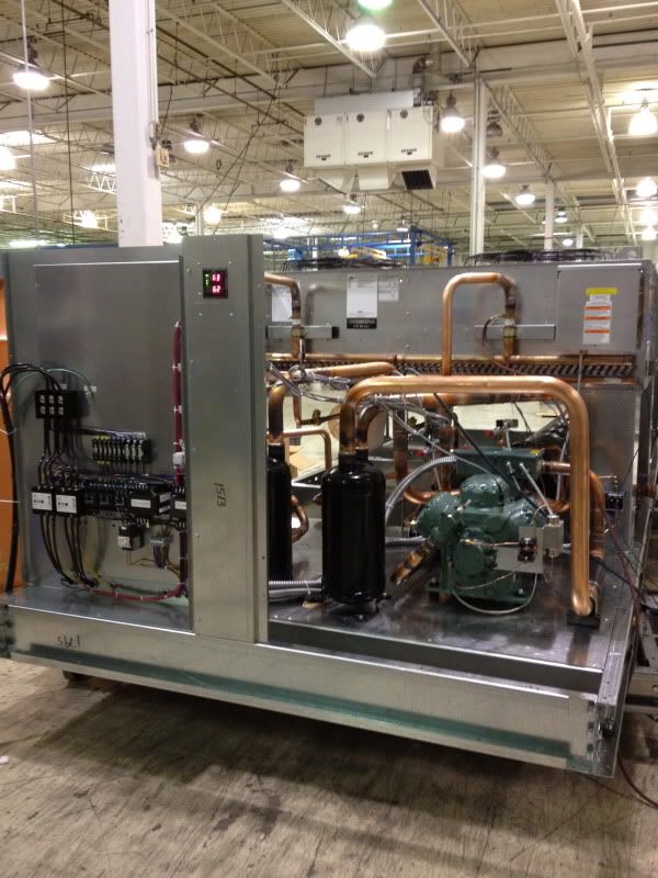

this is what i do for a living and i have seen freon burn when doing repairs
we built chillers from ground up to repairs and trouble shooting.
r12 will not burn at a low temperature. but when using a torch at 300 to 400 degree it will burn a little not to a point of an explosion
green flame comes out and so as the toxic
