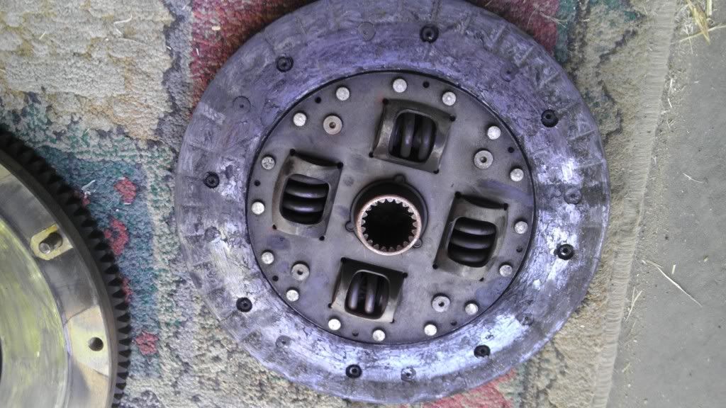

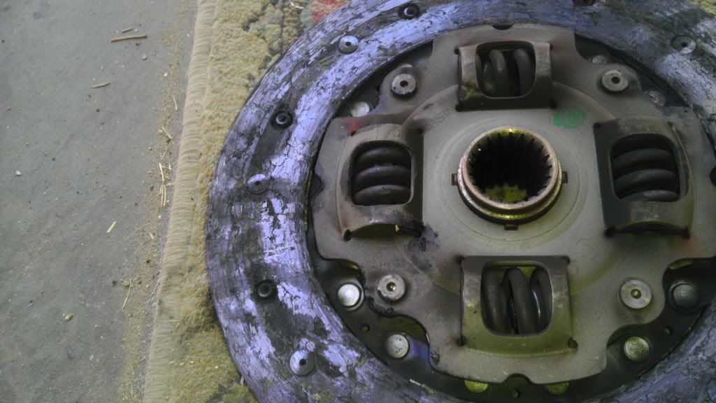

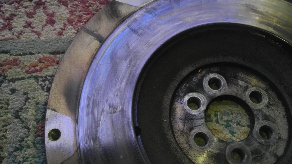

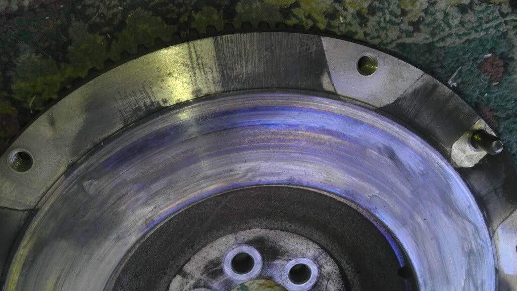

bioskyline;1742034 said:
that is one worn out clutch!
Right definitley got its use. Wonder how long its been in there i bought the car with 134,6xx miles on it.
Current milage 147,033
---------- Post added at 04:41 PM ---------- Previous post was at 04:40 PM ----------

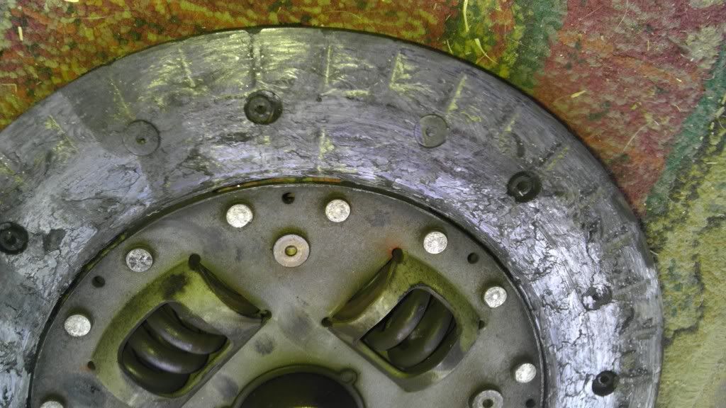

hvyman;1742039 said:

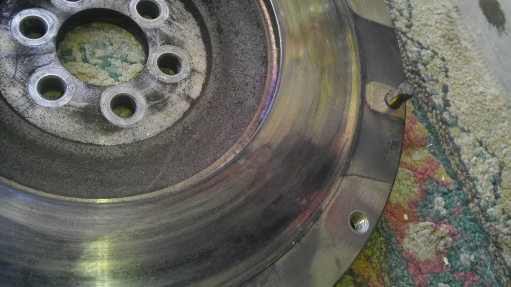

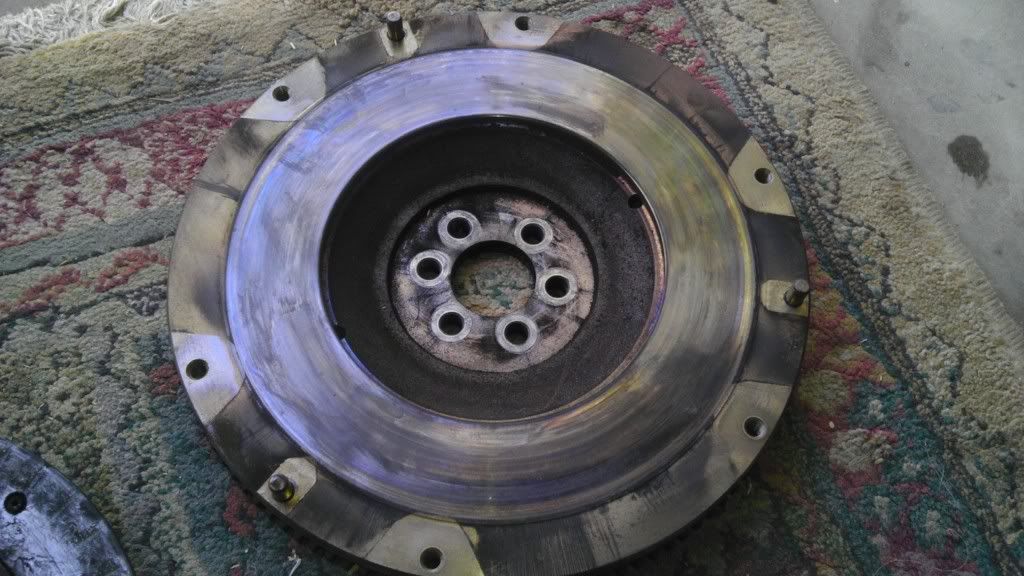

Looks like you made it too the rivets.
yeah it did and the flywheel has some hot spots im hoping that the machine shop will be able to fix it up pretty good :)

Ya They should if its not too bad. Looks like it got pretty hot.

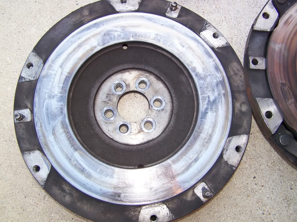

Also make sure they machine the back step.
Hotspots aren't an issue, it's cracks that would be an issue.

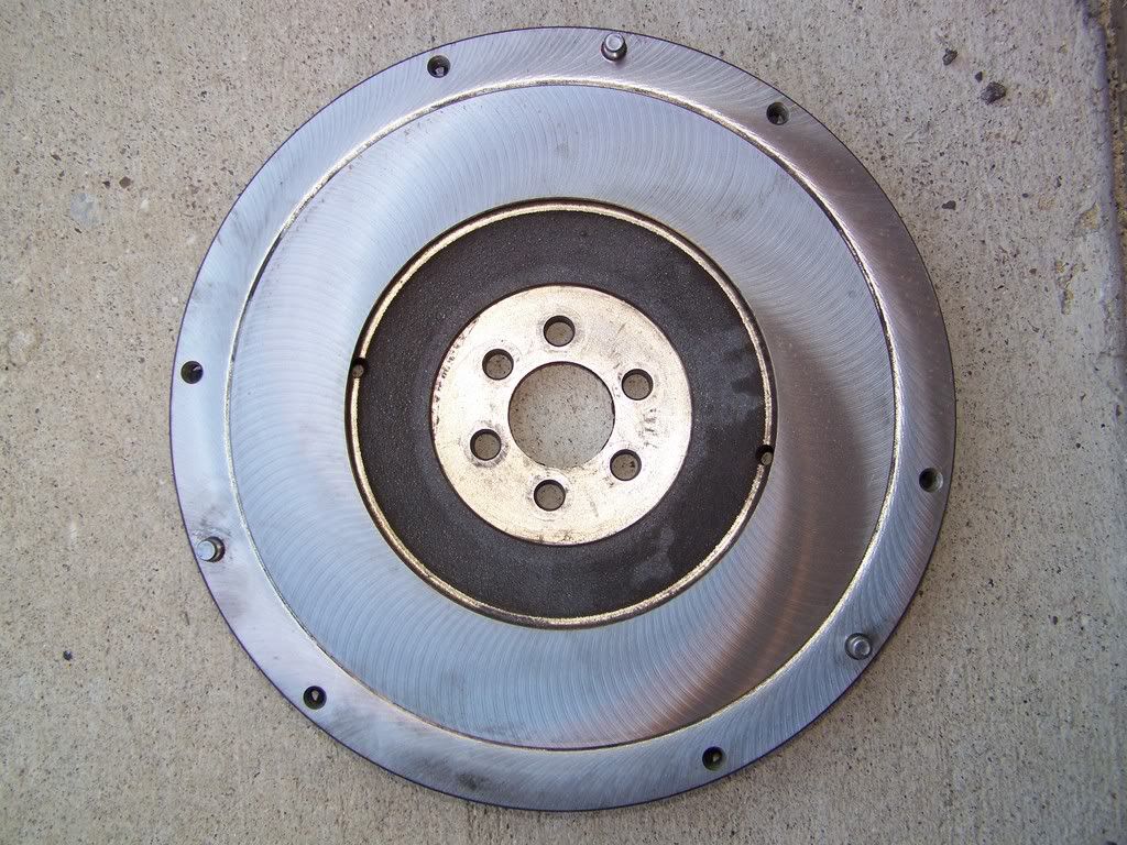

Here's the one I junked (clutch slipped so bad I barely made it home). Notice the cracks:
Here's what it should look like once machined (different flywheel):
