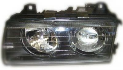

Not sure if I mentioned this earlier in the thread, but I plan on doing a proper OEM (oem Infiniti fx35) HID retrofit into Euro glass lens housings. There are a number of Euro housings available, such as DJauto, Apexcone, Depo, ZKW, Hella, and Bosch (going in order from worst to best)
The Apexcone and DJauto housings are relatively brittle from what I've read, and easy to break when disassembling them, or even just installing them. The quality is not there, really. So, read on. The Depo housings are inexpensive, but still not on par with the quality I'm looking for. The Bosch, and Hella are OEM Euro housings from what I understand, and as such, are very high quality. Unfortunately, the Bosch housings are very difficult to modify and very expensive, and the Hella's are hideous!
That leaves me with ZKW's, at around $425/pair, maybe a bit more. Here's a pic:
Picture stolen from www.bavtoys.com.
It's supposedly difficult to retrofit into these housings, too, but after careful consideration, I'm set on it. I almost feel bad about hacking up a brand new set of ZKW's, though. Almost. ;)
