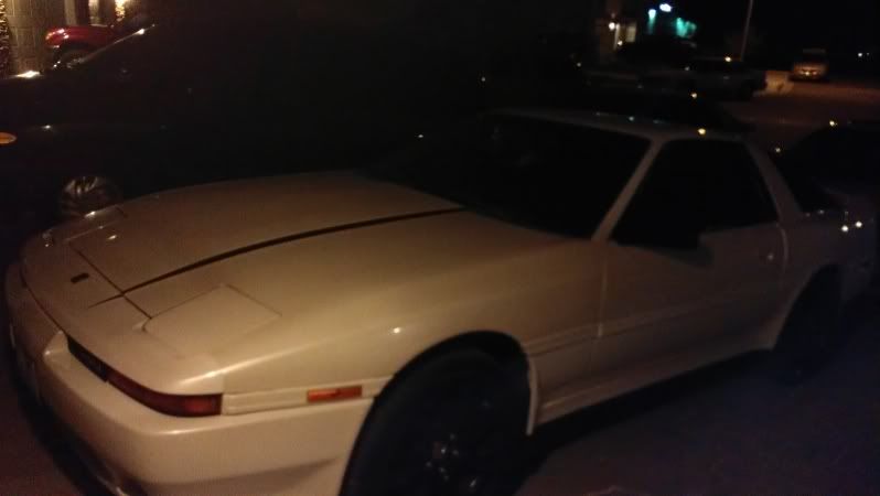

so here are some crappy pic of my hood but im diggin it. the lips im gonna put on are gonna be black too
need to get the hood line up though
