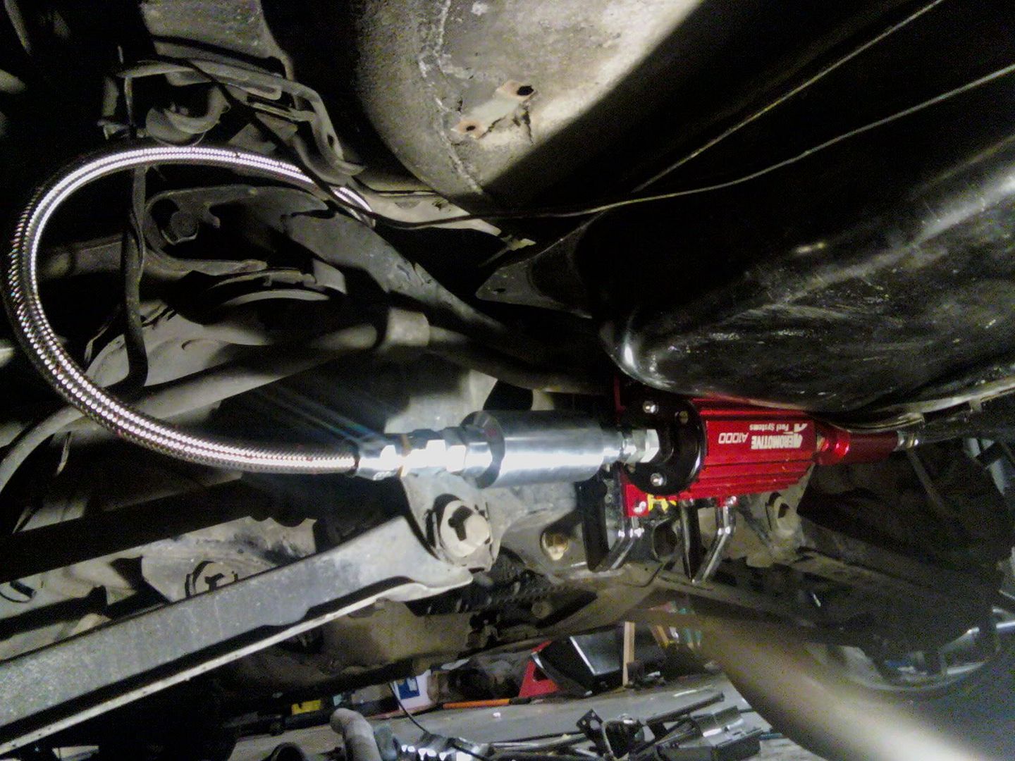

finally finished modifying my fuel pump hanger to accomodate the massive bosch unit.
I had to remove the standard feed pipe, then drill out the top for the bulkhead fitting. Lastly I had to remove a section of the hanger itself to allow the 45 degree AN fitting to clear.
All in all I am pretty happy with the job. I am running 12 gauge wiring for my relay and pump, I was just wondering if I had to change the in-tank wiring to match the gauge?
dont get me started about massive :naughty: mine doesnt even fit in the tank hehe
nice build btw
and whats this stuff about 45's on a fuel line
nice build btw
yeah the a1000 is a huge pump!
I could see how the 45's would be avoidable with a pump that size.
Its only 1 45 degree bend as it stands, hopefully wont have to use one outside the hanger on the feed hose.
AndyMac
Mar 9, 2009
268
Canberra Australia
IJ.;1377432 said:
1x 90 degree bend = 10 feet of straight line of the same size restriction wise
45's are better and sweeps in both better again. ;)
shit, its a 90 not a 45.... :(
and again, i couldnt see a way around it with a pump this size.
northwestsupra
Sep 19, 2006
1,166
Washington, Marysville
well my fluid dynamics go as far as gravity making it fall lol, no i can imagine how it would work but i was just curious. i figure that with the amount of pressure behind it that it really wouldnt matter. now if goals were higher and there was alot of fuel being used, then i could see it being a possible issue. i guess ill have to make a animation in 3dsmax using my fluid software to see how the difference live
