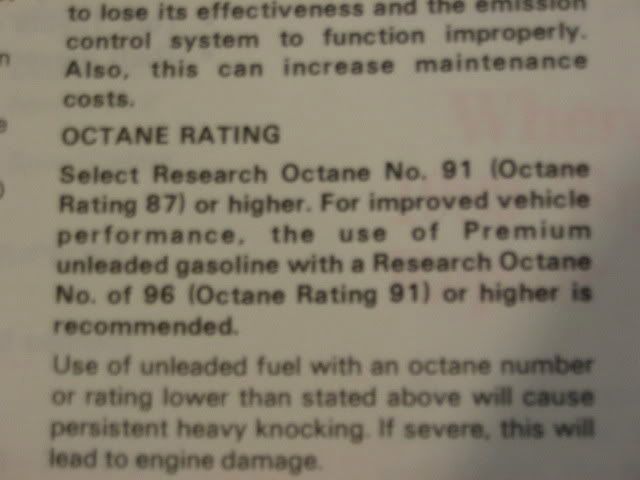

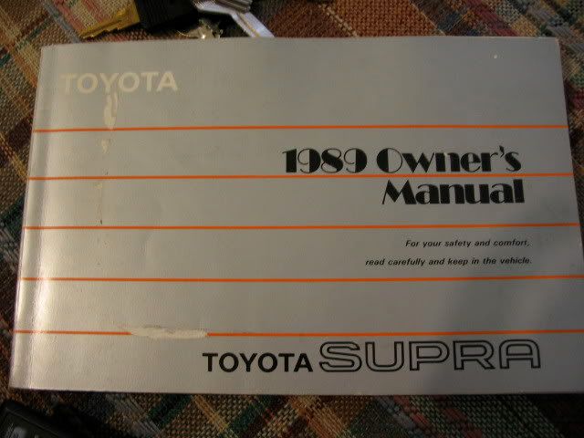

Simply put, If you're running stock boost, run the reccomended octane in the manuals. If you're running higher boost, it would be better to run higher octane to prevent detonation. I'm stock I run 89. When I'm modded I'll be running 93, simple as that.

just clarification for those who dont know:
research octane number = RON
octane rating is what is use in the US (R+M/2)
myself, i use 93 as a bare minimum and would prefer to run 110 all the time. but my car is nowhere near stock.
