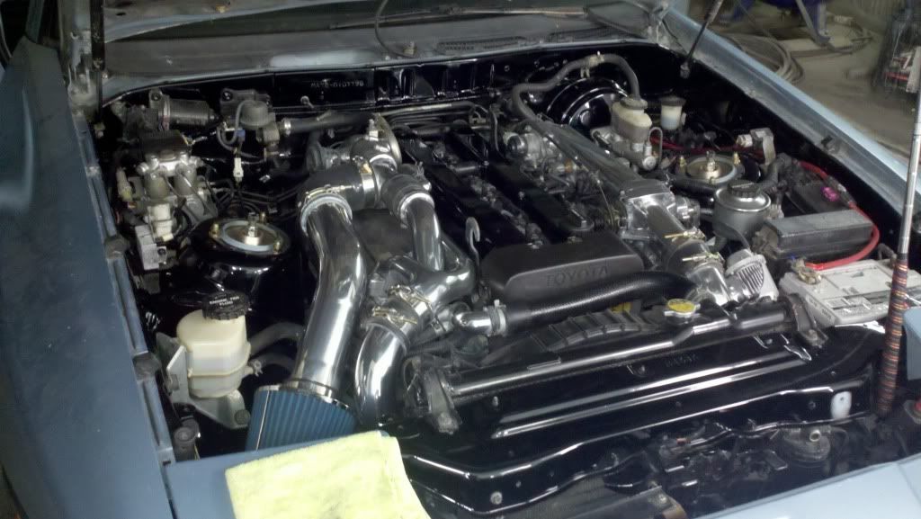

WOW nice swap you have going on here.
The max boost is set by the waste gates. There should be a pressure line from the compressor housing of each turbo to its own waste gate. The ecu has nothing to do with limiting boost pressure. (other than fuel cut)
After you check out the waste gates. At least put a mechanical boost gauge on. It should be boosting like 10-12 psi, but i agree breaking the tires loose in 4th seems weird. Then again if it was overboosting one would think you'd hit fuel cut. Maybe the modded ecu?
Good luck, it looks like your hard work is paying off.

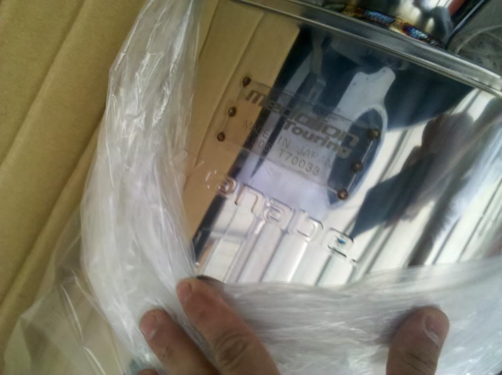

My tanabe touring exhaust shipped today instead of yesterday.. so hopefully I get it tomorrow. I'll post some pics up when I get it, as well as a sound clip of the exhaust as soon as I get a test pipe.

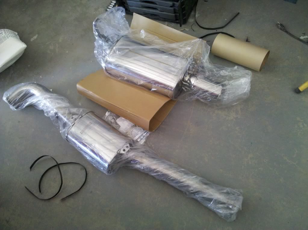

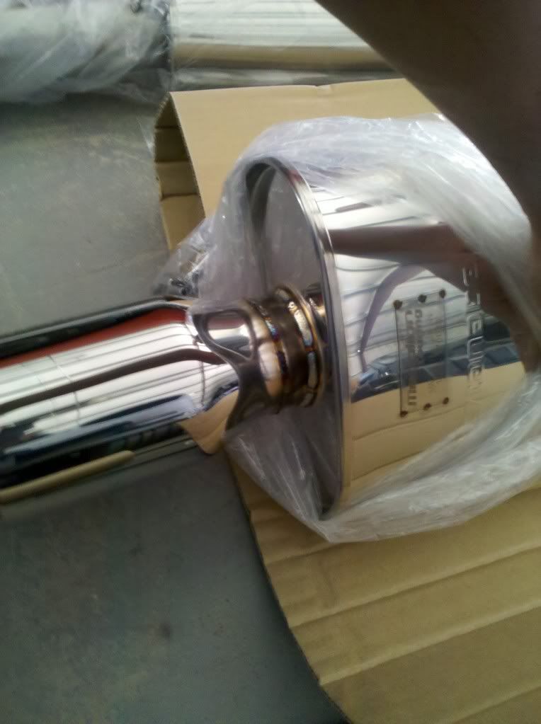

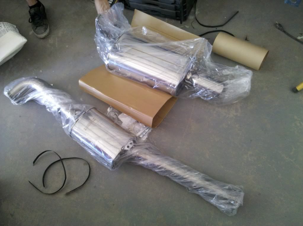

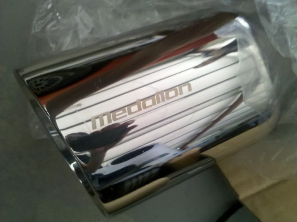

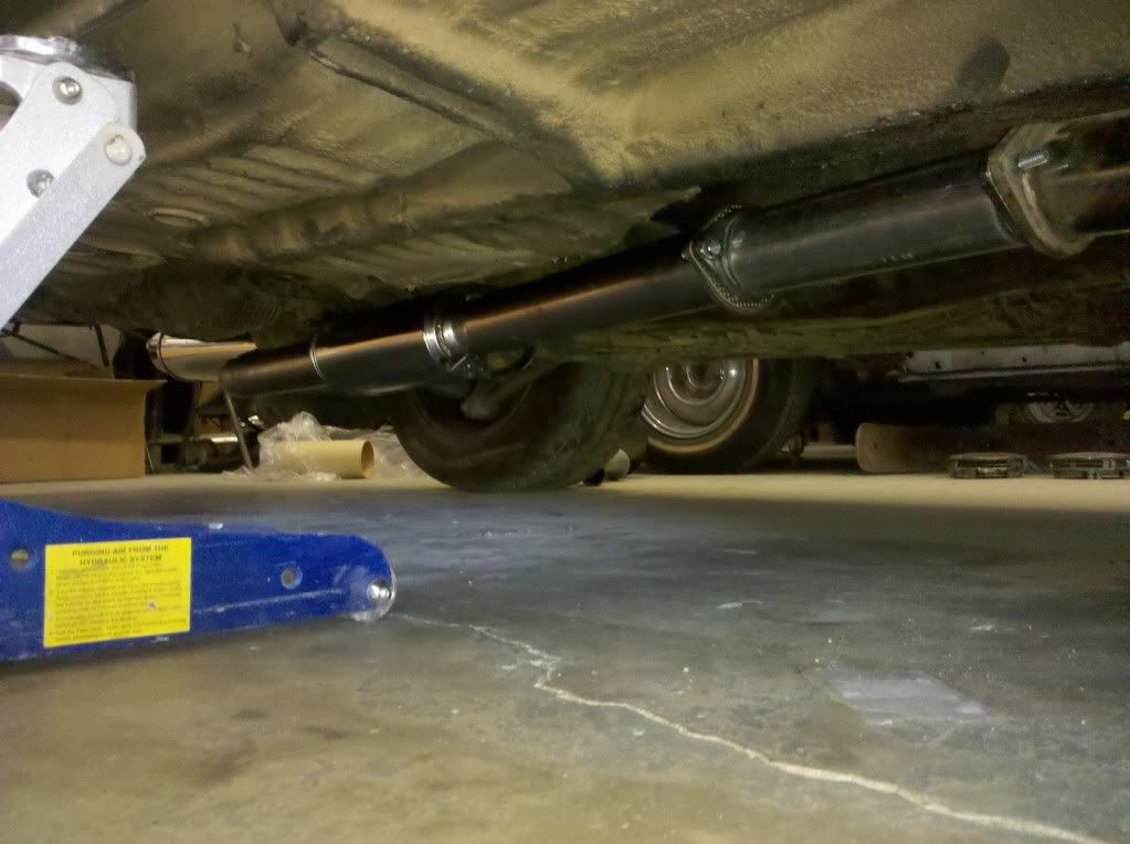

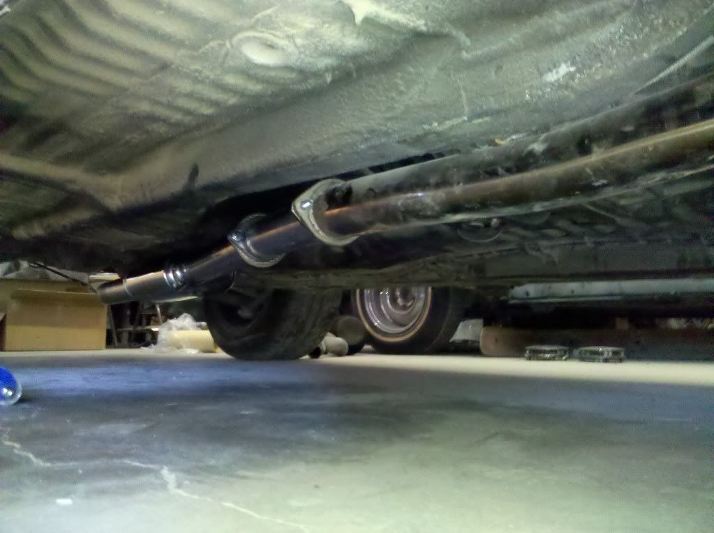

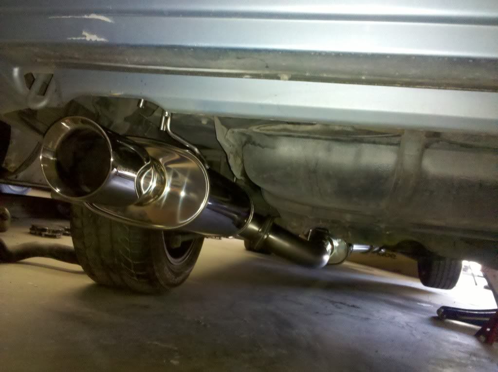

Got the Tanabe exhaust installed today. I'm VERY very happy with it, it is extremely quiet until you really get on it.. In fact, with the hood off, you can hear the hydro fan over the exhaust. I took a quick video of it right after I installed. There is a little bit of smoke coming out of the exhaust, that is probaly just from the test pipe which was freshly cut and, like a dumbass, I forgot to clean it out before I installed it. I might take it off again and clean it out tomorrow. Here is a link to the video I took:
http://www.youtube.com/watch?v=WJJTrJLs2EA
qu3tzlgum8y
Jan 5, 2007
99
Rancho Cucamonga, California
Here's some pics of the exhaust:

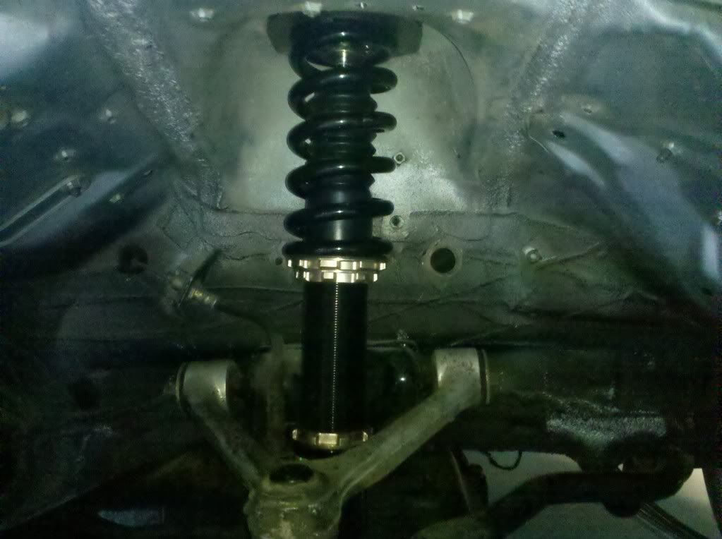

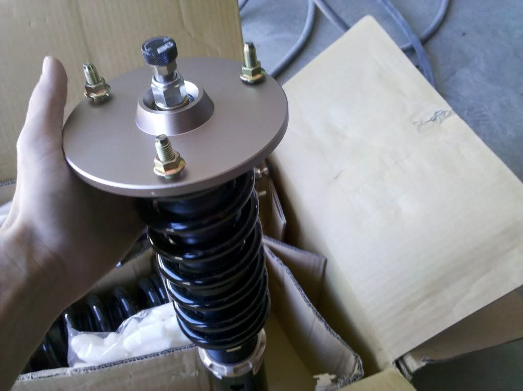

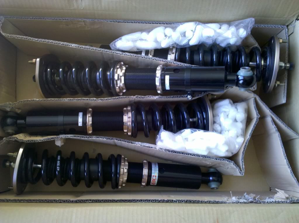

Got my BC Racing coilovers installed today. I haven't really had a chance to mess with the dampening yet but I did take it on the road at a medium setting and they felt very nice. No body roll, and very responsive steering. Also, even with my entire interior gutted, they are still very quiet. When I first installed them, I wasn't sure how tall to set the coilover so I made a guess and my mud flaps ended up touching the ground.. so they can definitely get low.. For now, though, I just set it at a pretty much stock height. Here's a couple pics (it was too dark to get a good pic of the car):
