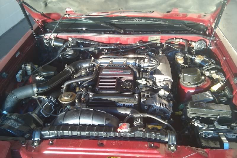

You're a little late on the advice, lol. Engine was installed months ago. block was honed, new rings, head resurfaced and checked out, the block and head weren't perfect in the passages but were just fine. Car has about 2k miles on rebuild if I remember right.
New bearings, rings, OEM HG torqued to 75 ft-lbs, all new seals, painted block, polished crank... nothing fancy, just a fresh stock rebuild.

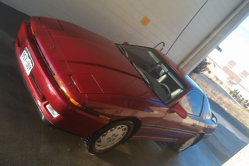

And...... done!
Sent from my HERO200 using Tapatalk
