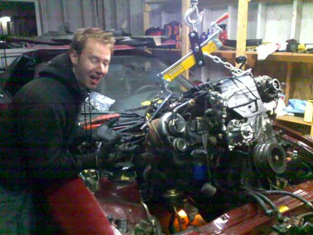

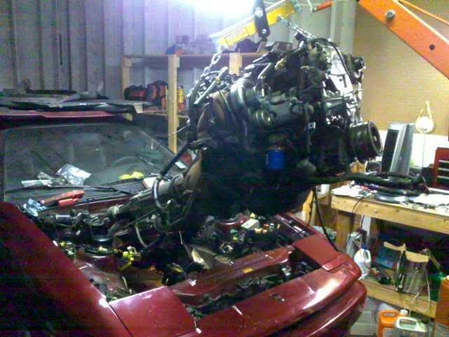

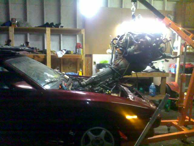

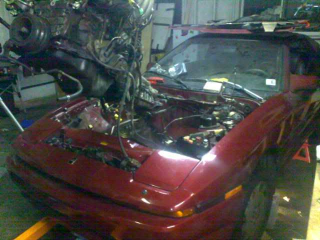

Engine was pulled last night. Garage is a mess of oil, coolant and stray tools, but it was a blast getting that motor out and way up in the air!
Supracam looking a bit stoned:
Can't wait to clean the living hell out of that block and the engine bay. When we install it again, the goal is to not have to wear any gloves and finish with clean hands. :)

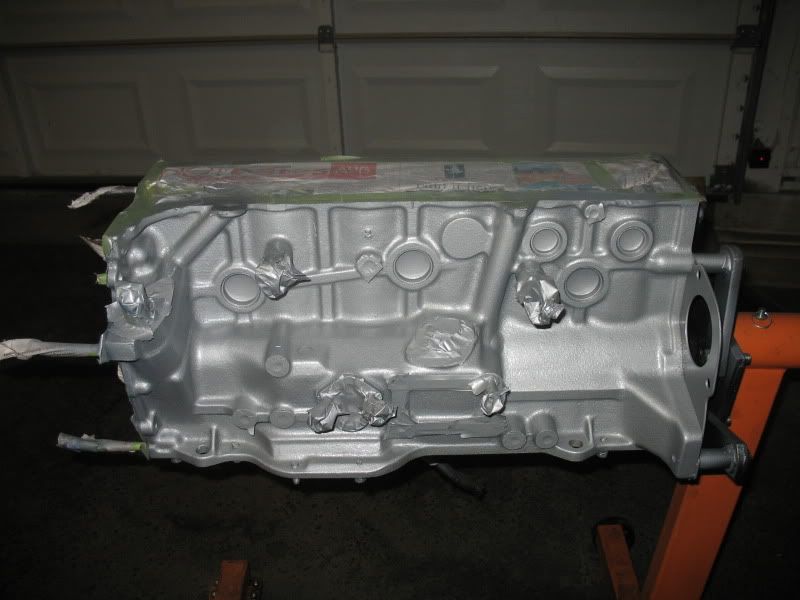

Block is fully stripped, save the oil filter bracket. Parts are all over, being cleaned. Crank is at machine shop being polished and keyway is being mended, head is being milled and stem seals replaced.
Cylinder walls are now honed, OEM parts arrived from toyota. Waiting on word from the shop to order bearings and rings and then its time to paint the block and reassemble. :)
