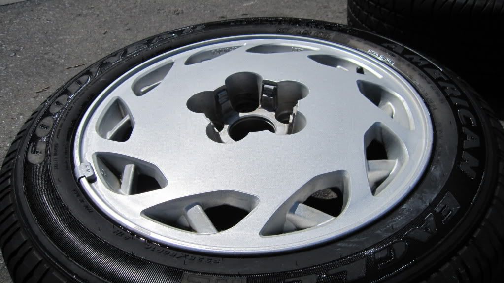

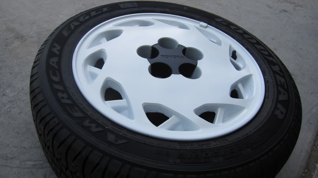

Well today I started working on my rims, Here is what it came out looking like. This is wet sanded with 400 grit, then 1000 grit, then buffed with turtle wax, and then polished with zymol polisher. Total time spent about 30 min on one rim. One down, 3 more to go lol. I painted all the center caps metallic silver, they look good but don't match the color of the rim, they are a little darker in the sunlight. I think I might paint them black or another color? Hot pink anyone? Just kidding :p

So continuing with sanding the rims I went a little to much on one of them and took the paint off.. One got screwed up. :( Im thinking Im just going to paint them all Black or something just because it looks like crap right now. Next on the list is some springs so it wont be monster truck status anymore. lol

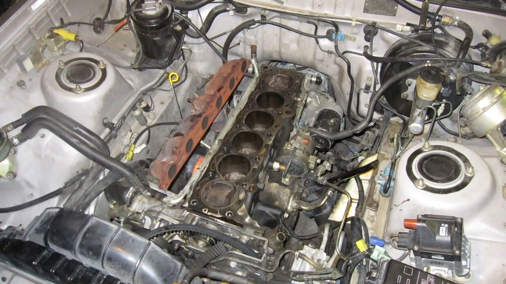

Well 4 hours later, head is off.. Head gasket doesn't look blown at all but, It definitely didn't seal how it was supposed to. In between the head and the gasket and the block and the gasket was coated with coolant and oil. The gasket came off without any separation or peeling, its still in one piece. I highly doubt the 90 ft lbs played a role in this happening, though 4 of the bolts right in the middle were pretty loose compared to the outer ones. When I do the felpro the bolts are getting torqued to 85 and then a re torque again after a few heat cycles to 90 ft lbs. I think it was just the crappy ebay gasket that caused it.
Devin LeBlanc
Apr 7, 2010
1,830
32
Las Vegas NV.
Little update, After further inspection of the head gasket (I was really tired last night) It seems combustion was leaking between some of the cylinders. and didn't seal around the main oil feed passage. Head is being cleaned, machined, all new valve stem oil seals, etc. My brother is doing the machine work and going to have it back to me tomorrow. I also called ARP today and they said for the bolts I have (part number 203-3902) Which is the 12 point bolt not stud, They said with moly lube torque to 90 ft lbs, and with 30wt gear oil 130 ft lb's. So my bolts were way under torqued because I only torqued them to 85 ft lbs using the gear oil. 45 ft lbs off. This time Im going to use moly lube and torque to the recommended 90 ft lbs by ARP. Allowing them to sit over night and then doing a re torque procedure. This way Im sure it will be good.

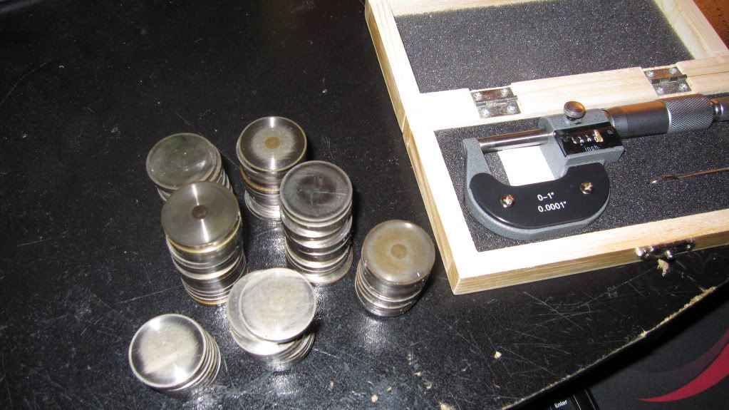

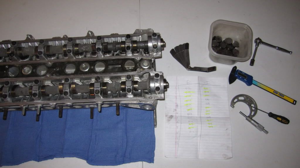

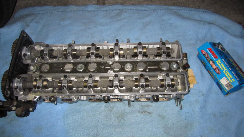

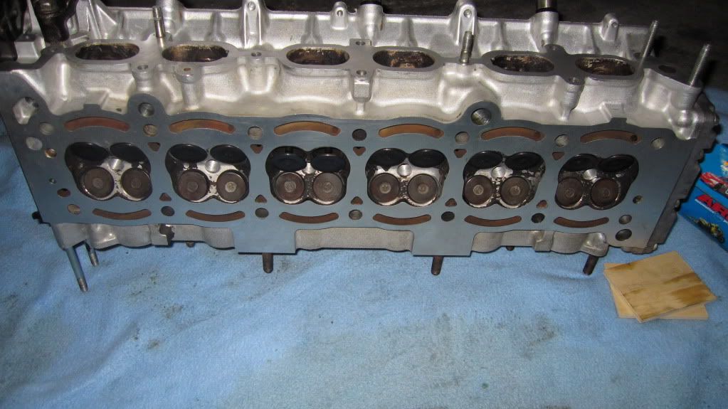

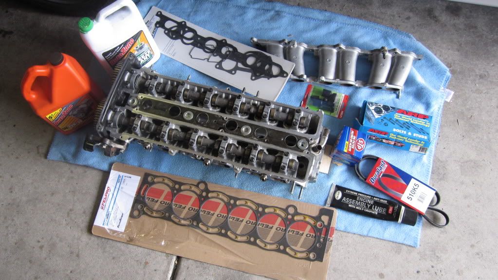

Small update, Sorry no pictures. I will have them to post soon. Anyways Got the head back and put it all back together. We ended up taking 10 thousands off the head, All new valve stem oil seals, lapped the valves, valve lash adjusted and within spec. Thank god my brother had like 300+ shims for the lifters. About an hour with a micrometer and some math and I was able to get everything within the minimum/maximum specs. Felpro HG is arriving tomorrow thanks to Rock auto. Got basically everything I need to put it all back together. I need a cap for the back coolant barb on the back of the head (Bypassed the heater core) when I took the "nipple" off it tore. Anyways, Head goes back on tomorrow.

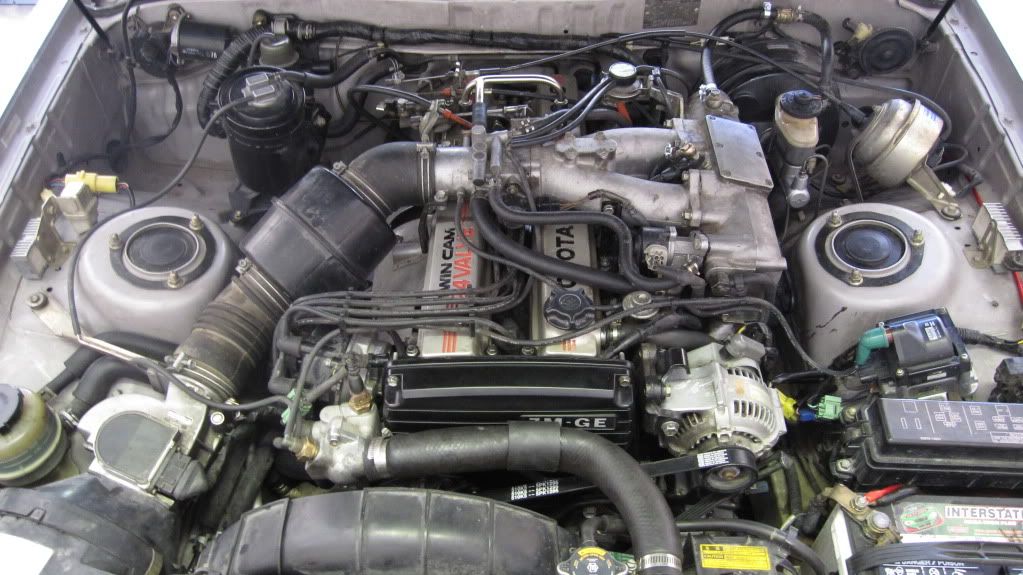

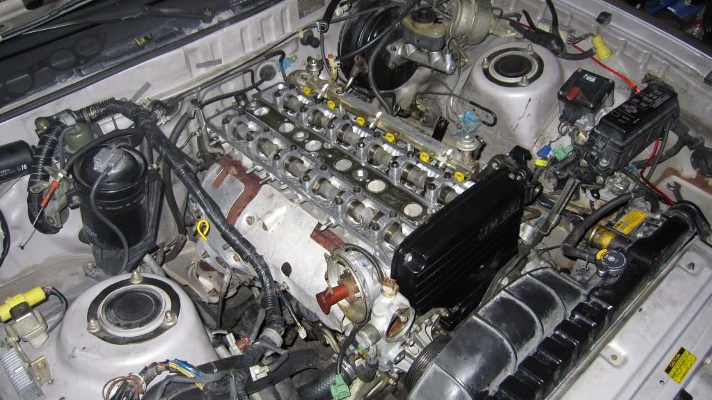

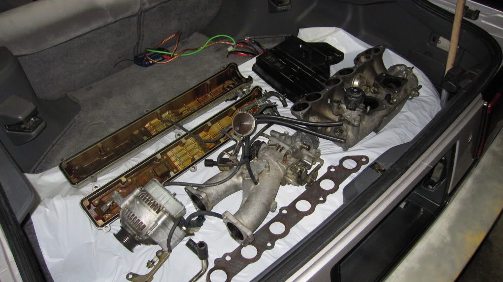

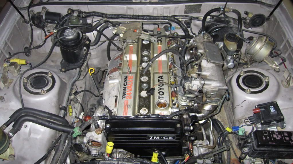

Alrighty.. Heres some pics :D
Here's how it sits right now:
Parts in the back:
Oh and the fun begins :D
Head all done and ready to be installed:
Whapow.. Nice :)
muhahaha, Enough shims? ok maybe not enough.. I have more.... Seriously.. lol

Well got it all re-torqed and wrapped up this morning! Runs even better than it did before! Smoother acceleration.. I think all of that carbon build up on the intake valves was causing it. Starting to work on the rims now.. Heres what one finished looks like. I still have to outline the Toyota in white in the center cap with a fine brush.
