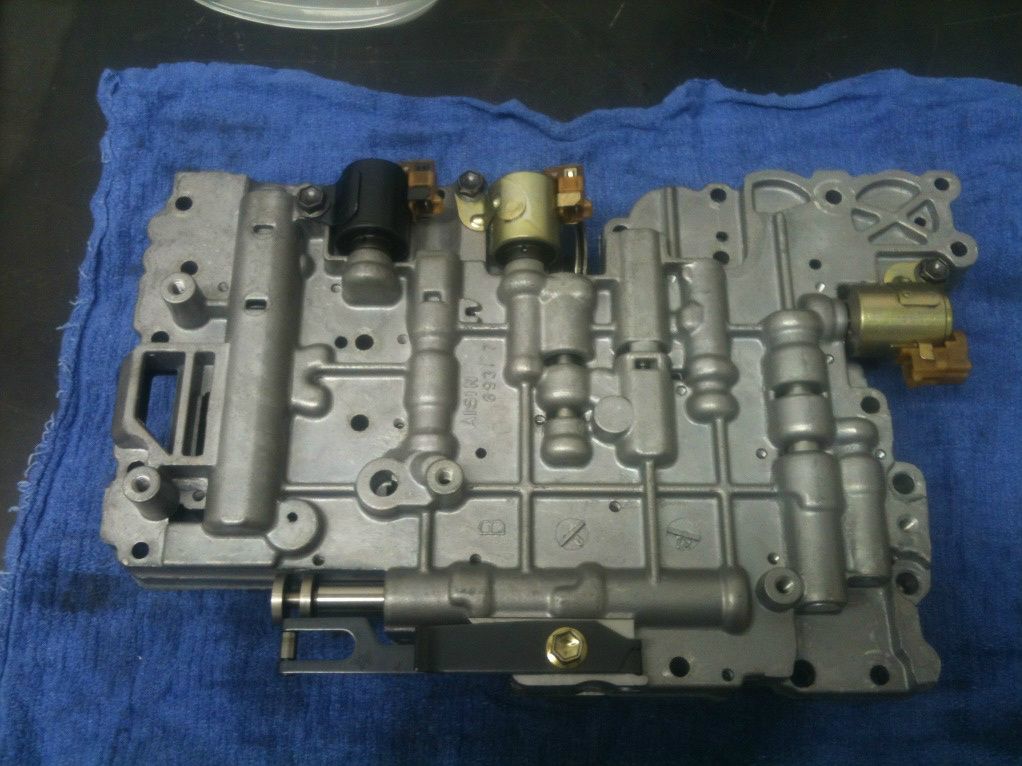

This little piece has 1/8th npt threads and 9.5mm (3/8ths) tube fittings. The site (poweredbymax or gtfactory.jp) lists these as fuel pressure sender adapter fittings. Can I use this for temp sensors for my trans line? or do temp sensors need different fittings than pressure sensors? If I can use this, that will allow me to avoid tampering with the trans oil pan.

hmm well if you use it in the trans cooler either the temp is going to be on the feed side or return, so you wont get an actual fluid temp.With it in the pan you get the actual trans oil temp as its being sucked up the filter. I personally would just weld a bung on the pan.
On a side note, thought I'd let you know I replaced your separator plate with a different one, yours was a earlier trans and had the steel balls that ate into the steel plate and just tore it up bad. Its all good to go now and you should see a big difference in trans performance and shifting!
