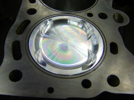

I wouldn't o-ring a 7M. My old motor was and it didn’t seem like a popular idea.
The rings end up being seriously close together. Mind you I never had an issue but was only running stock boost.
Pics or it didn't happen, right?
There is only like a millimeter between the rings.

this is true... I guess we'll see I've got 3 spare blocks. I know the one in the 89 I'm about to scoop is bored .40 over... there'd be no way. It is a bit close for comfort there in that pic, but I can't really see it being an issue... even if the rings were touching.
Of course there's an issue, the o-ring is providing a very high load on a small contact patch, if the rings are close together this load becomes shared across the 2 rings so you get uneven loading around the ring and failure.
A 7M has to be one of the least applicible engines to o-ring (ALL of my previous Turbo engines were o-ringed but when I got my 7M I didn't go ahead)

always good to hear from those with more experience... I've only seen one o-ringed 7m (disassembled, not in a car), never even heard anything about anyone doing it until now. I may have to put a hold on that project if it's such a bad Idea.
